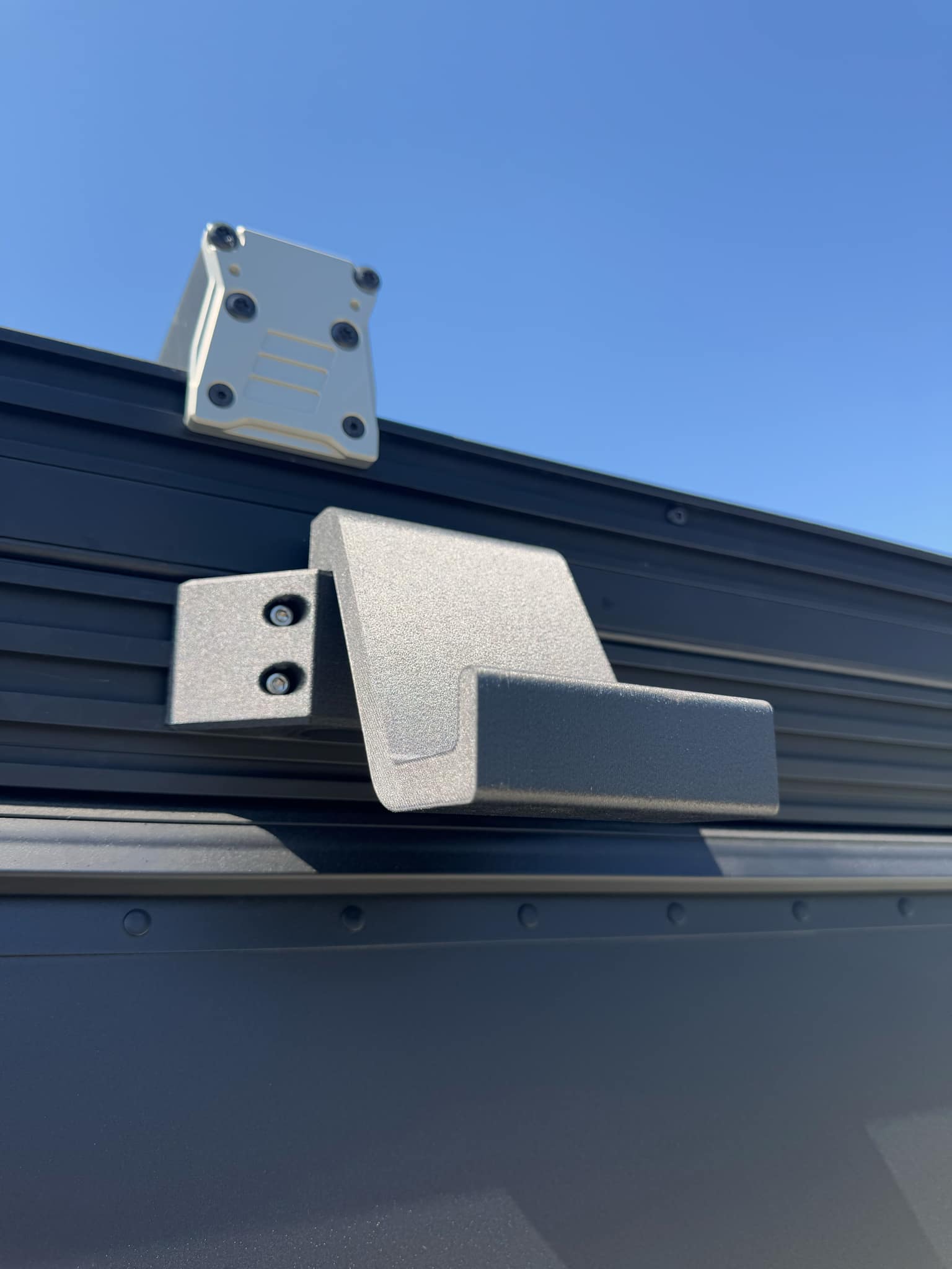

@Eisenheim is right, just test fitting…
But appreciate concern!
Two things of note after another long weekend of using the heater…
With this setup, I am going to try and place some foam or rubber to keep the heater case off the side panels. Probably go to HD for some foam rubber in white to not discolor my white side panel.
Also, because the heater is no longer far away on ground, and directly in contact with the side panel, the fuel pump sound is amplified. So I will be spending some time trying to quiet that down.
And lastly, I no longer need a whole bunch of the wiring, so going to trim all the harnesses down nice and tight :smiley:
But I really do like this solution, despite all the above mentioned things.
Fair concerns and the resonance on the side panel was something i was actually curious about. I figured it would be a factor, but wasn’t quite sure how to solve it without making a mount that sticks out at a 90 quite a ways. I wonder if running something like a rubber bungee from the back of the meathook, over the front of the heater and hooking it onto the bottom backside of it would put enough tension that it would hold it just up off of the side panel. The foam is likely the easier solution though.
Thanks for the feedback, I’ll look into some potential solutions that may help with these issues.
Any luck on getting the stand alone version done? @Eisenheim
Also, anyone confirm if this works with a Apache 3800 case?
Still working on that, but I do have a model designed at the moment. Are you looking for a dedicated hard mount version to leave on the track?
Also it should fit the 3800 handle, there should be plenty of room for it to sit nicely on the hook.,
For those who may have a heavier diesel heater setup or may be concerned with weight limitations, I’ve released a dedicated track mount for the Meat Hook. This mount will only work with the GFC 3 slot track, but a 2 slot version will be out shortly (mainly because the 2 slot version will likely be much less popular). If you snag the Anchor Point and the Meat Hook together you’ll automatically save 10% on the bundle. @Evanjt helped me out with testing the fitment of this mounting option. So as always, thanks to him for his help.
Do you think that this system will work with a Propex PS2000 heater?
It may. The fuel tank being on the back may be the only issue. So if you can turn the heater around so that the tank is facing out it should definitely fit. Weight wise it will work just fine. But you could also use a small strap around the heater handle, then loop that strap over the Meat Hook hanger
