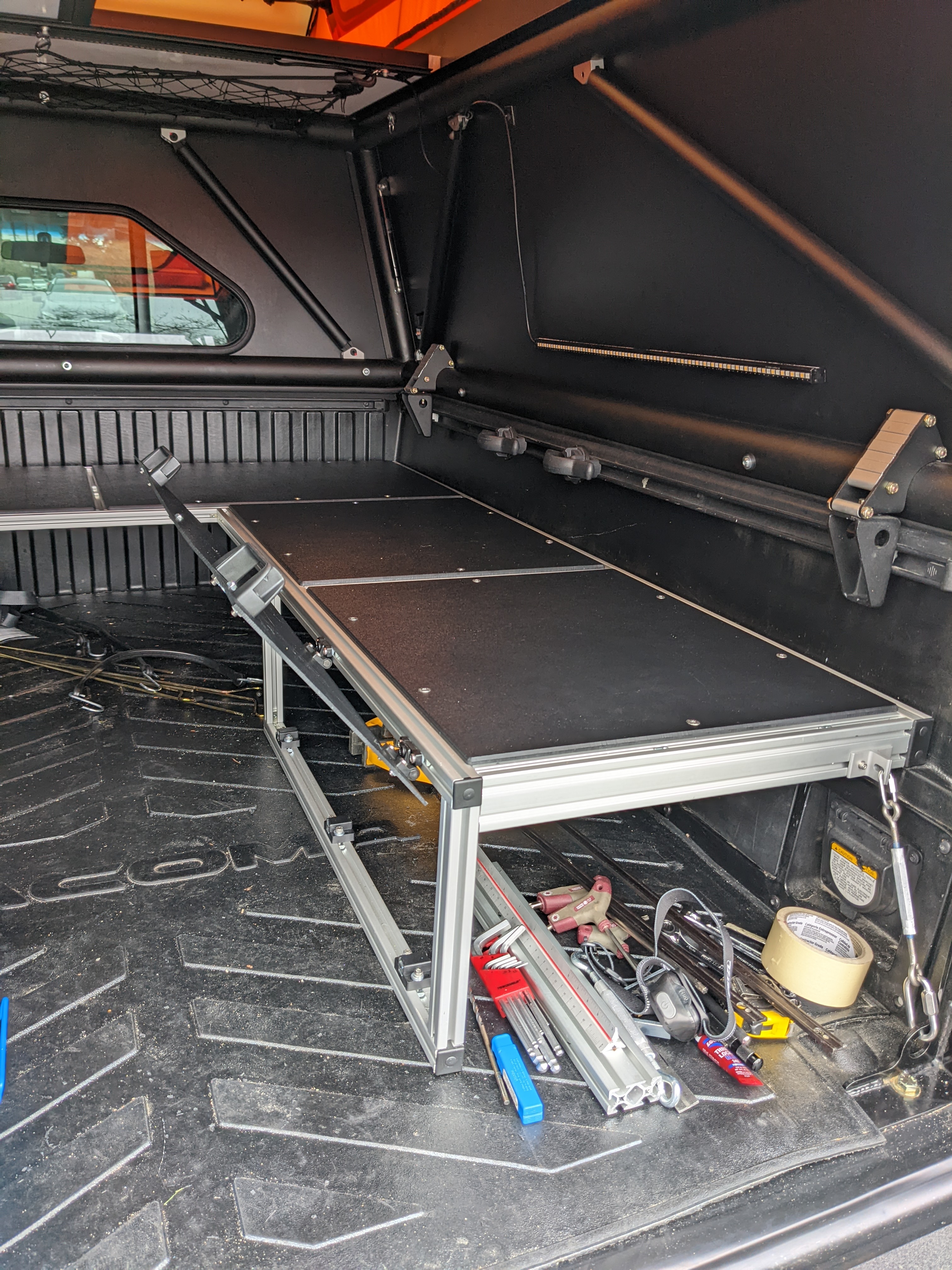

I wanted a shelf in the bed for the fridge but also to stuff Frontrunner boxes both above and below it. I built one out of stuff from Lowes and was planning to keep it a while but it started to get a good bow in the front where it was not supported. While I think it would have been good enough for a while - now that the camper is on I can measure the 8020 build I wanted to do.
First 8020 order arrived this morning and here is the framed build out so far. I will keep updates coming on this as well as some info on what I ordered.
When I forgot I had changed the right piece to allow for a bench…
After I put the bench portion on and got everything situated…
Next up - put a top on it. Thinking 1/2" black Starboard with a 1/4" rabbeted edge so it slots into the track OR some sort of flush mount panel. I am still investigating options here.
To attach to the bed I will continue to use turnbuckles on the cab side to hold it forward and down and a third turnbuckle in the back to keep the bench from hopping.
Dometic fridge will go on the shelf on the left side of the cab - leaving room on the right for securing a stack of 2 front runner boxes, 2 more can slide in underneath the shelf. The right side is primarily to be used as a bench but will certainly make use of the storage once I have a plan.

If you can see, I have a 2" tall piece of 10 series 8020 on the bed side and it lifts the platform up plenty high to fit the wolf pack under.

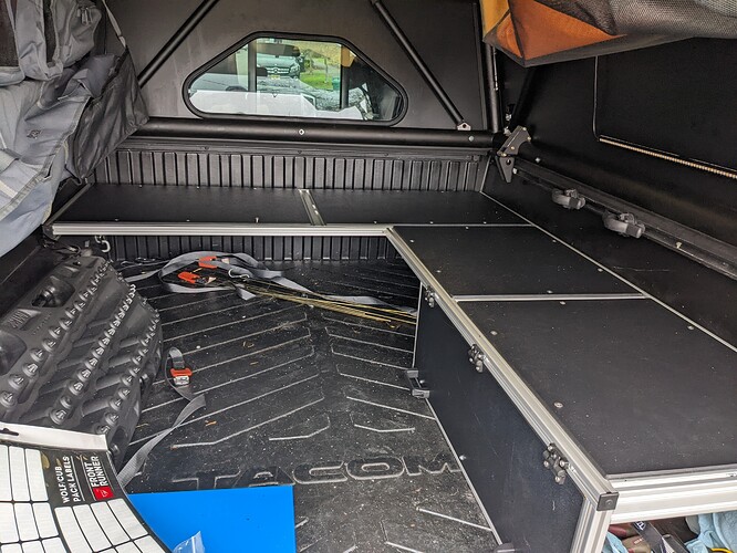

Looking good. Question about photo #2: what are the 3 pieces attached to the side of the bench at the top & bottom?
Those are hinges and magnet clasps for a fold up door I will put on … hopefully later today!

Door closed
Door opened
Back shelves (not fully bolted in yet)
Finished up!
