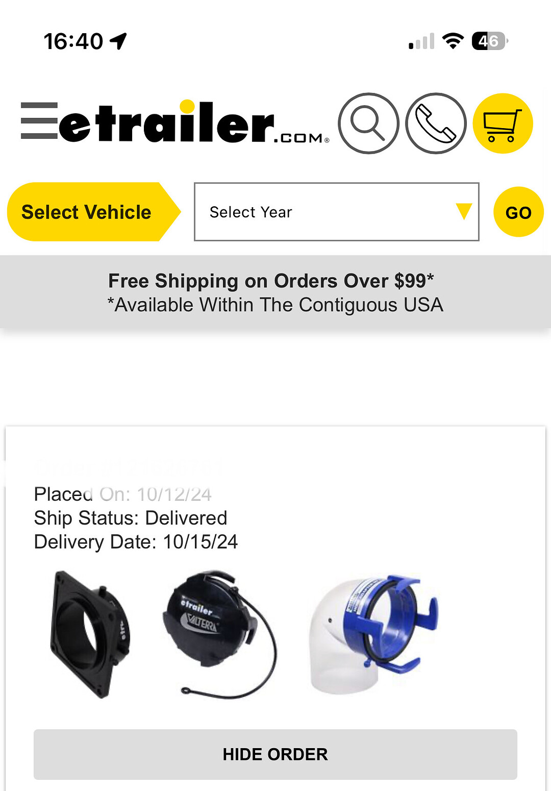

Not sure where to post on here, but I may have found a solution to the Positive Pressure Vent issue on a GFC. Just got my camper a month ago and took it on 200 miles of Utah desert. So, Much, Dust… So I set out to find a solution. I spent 30.66 including shipping for these parts
Im really happy with how it turned out. Cover is great for when I am driving on the road, no hit to my MPG. Then when Im off road, I just twist off the cap and twist on the 90 degree elbow. added bonus, I can get a T fitting so that my propex heater can heat my camper and my tent.

Thanks @JohnEDavies, Yes my Bed and tailgate are sealed. I have lived in a RV for the last 8 years and I am very familiar with what you’re talking about :stuck_out_tongue_closed_eyes:… too familiar. Yes this cap has four ears just like the 90 degree elbow. I haven’t installed one on the other side, I’m not a huge fan of putting holes in my camper if I can avoid it, but I hate getting dust in and needed a way to vent heat into the camper anyway. It seems to be working really well! I haven’t put it to the ultimate test yet so we will see how she does once I put 200 miles down in the desert again. I also like to drive fast
