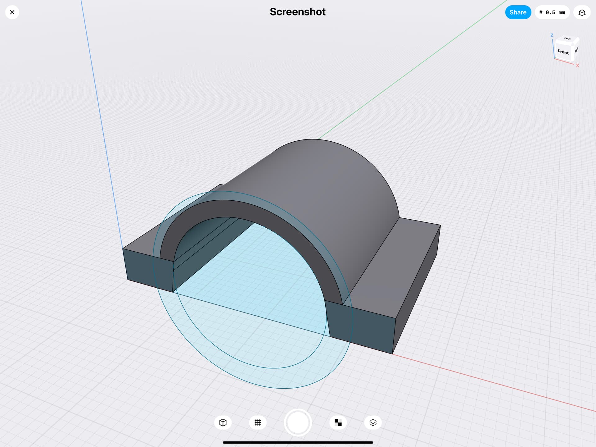

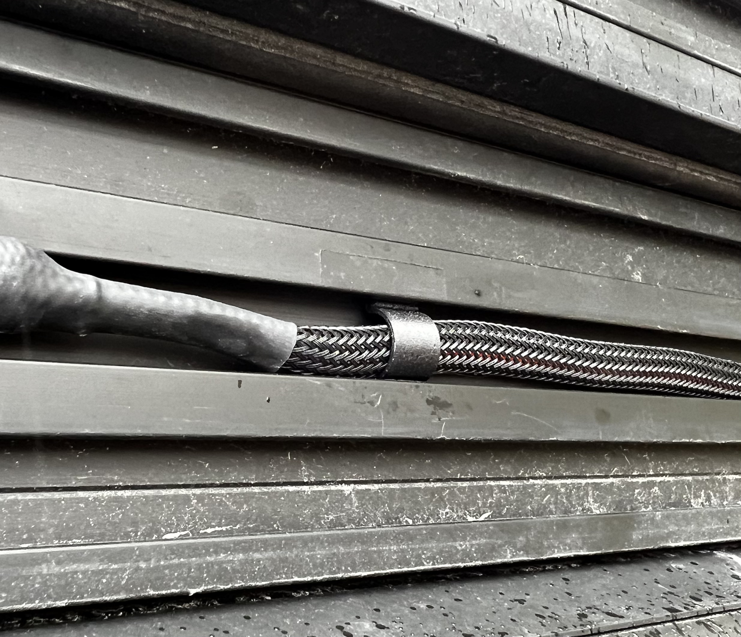

I am testing out some wire clips I designed and printed to see how they hold up. They are basically to keep the lighter wires tucked into the channel. If they hold up I can run some batches for people.

Oh, those are pretty cool. I thought about the twist in thing but figured I would have enough flex in the clip.
yea - the clip is beautifully simple for horizontal runs! I wouldn’t change a thing on your design.

this is great as it uses the channel for the wires then. Keeps them tucked away. i like it
Sounds like I have some testers for the clips. I have no idea how well they will hold up to the elements. That’s actually my first test. I put some on the truck and I’m going to see how well they hold up. UV isn’t a problem with the material I printed with. But curious about heat/cold.

hey just an idea for making these - if you got some seaboard (1/16" or 3/32" thickness that is HDPE and UV stable), you could get a 5/16" metal rod and use a heat gun to form plastic strips over it. That would certainly be faster than 3D printing, stronger than 3D printed parts, and you would know for sure it is UV stable and marine grade.
I imagine this is not much harder than waiting for a large batch to print - if your printer is anything like mine… haha
Well, since I just have to send it to the printer and it does all the work. I’d say it takes less of my time :slight_smile:

Sorry to hear about the house issues. Whenever you do get around to it, if you need a tester in AZ I set up my routing pretty close to yours. Currently trying vhb tape to keep the wire in the channel but not sure how well that will work. Your clips look like they may work out pretty well. I can definitely test them heat wise. Lol.
