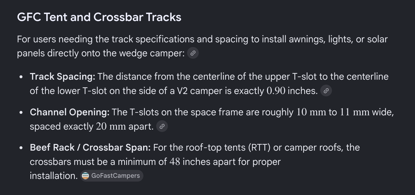

Can someone confirm these measurements, please?
I found this online… Is this the correct spacing for the V2/Max campers?

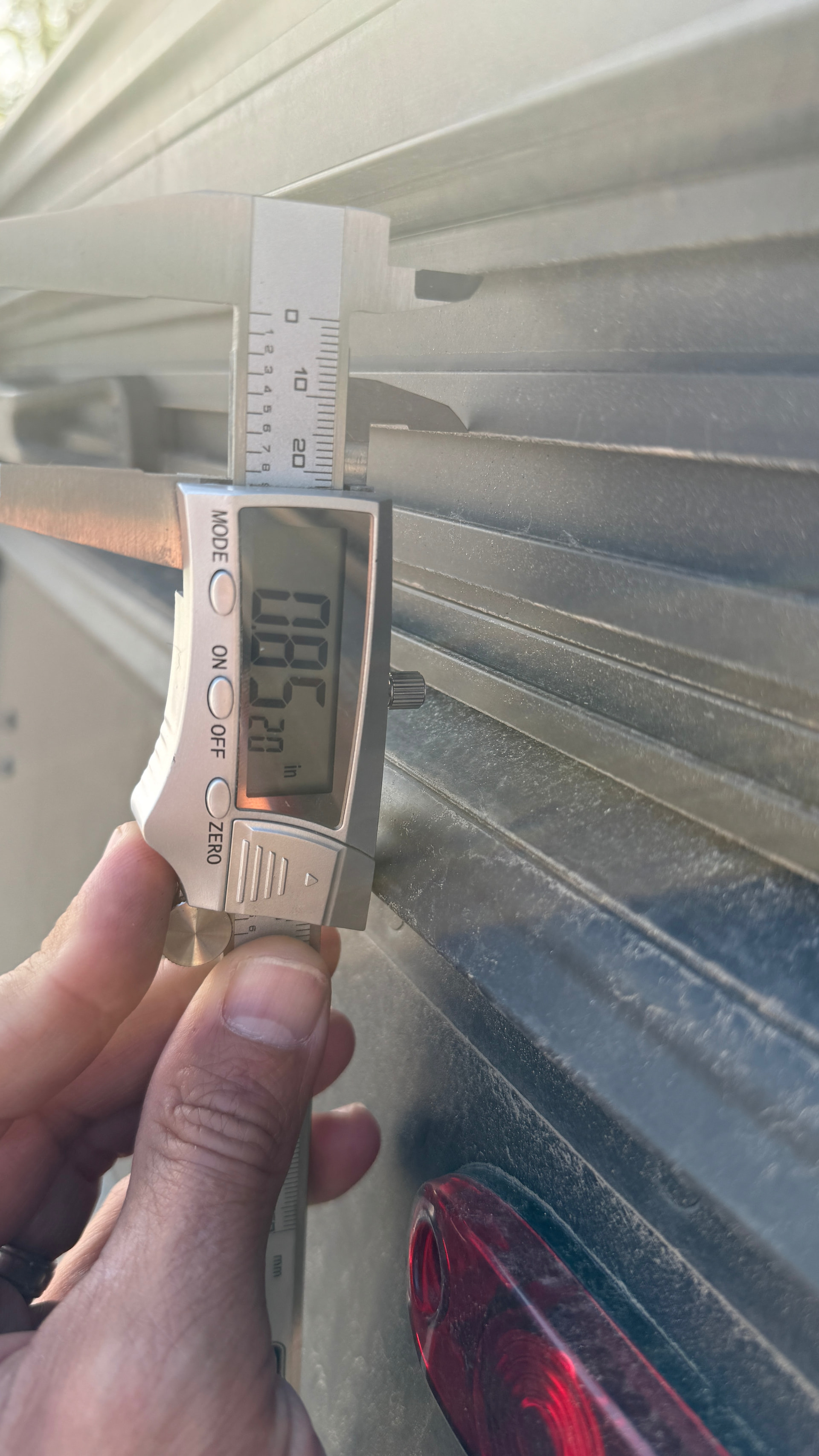

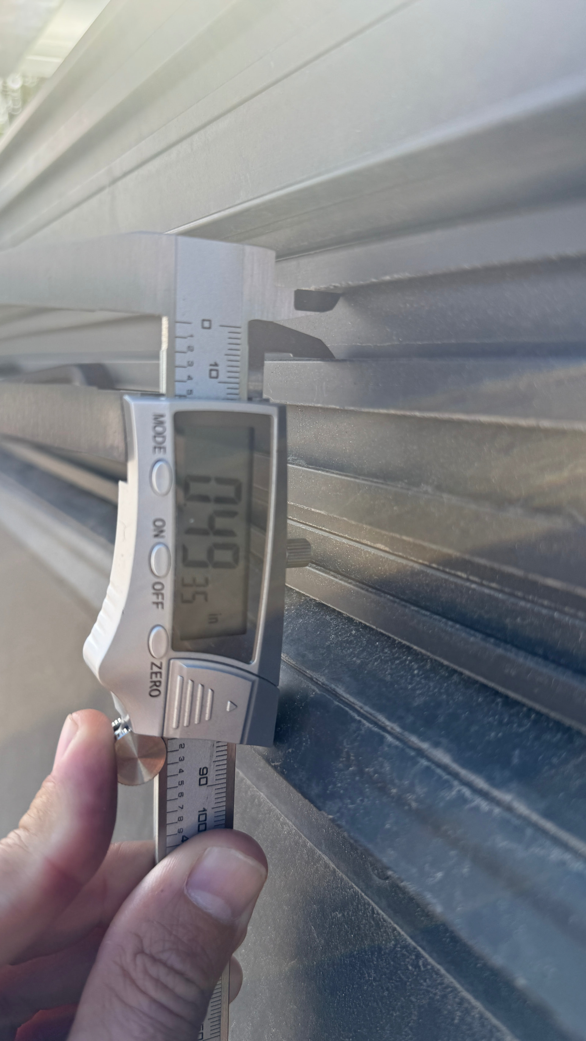

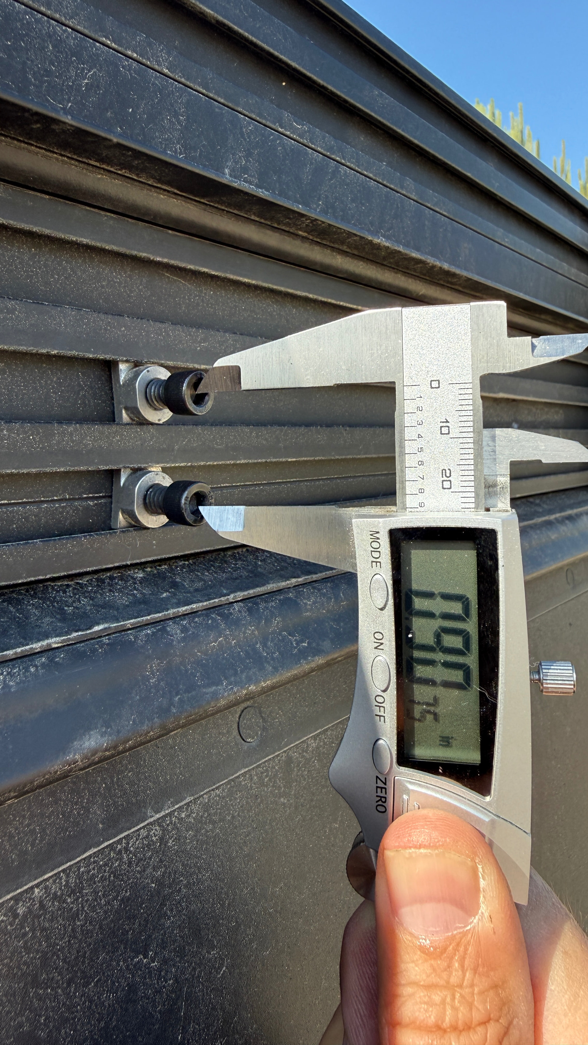

So, I thought it was about an inch but used my calipers and came out to be about what was shown here, about .9. Is that what you are looking for most or also looking for channel opening too?
If you wouldn’t mind getting the channel opening, that would be great!
Here is what I have. These calipers are not the best but a lot closer than a tape measure! lol
