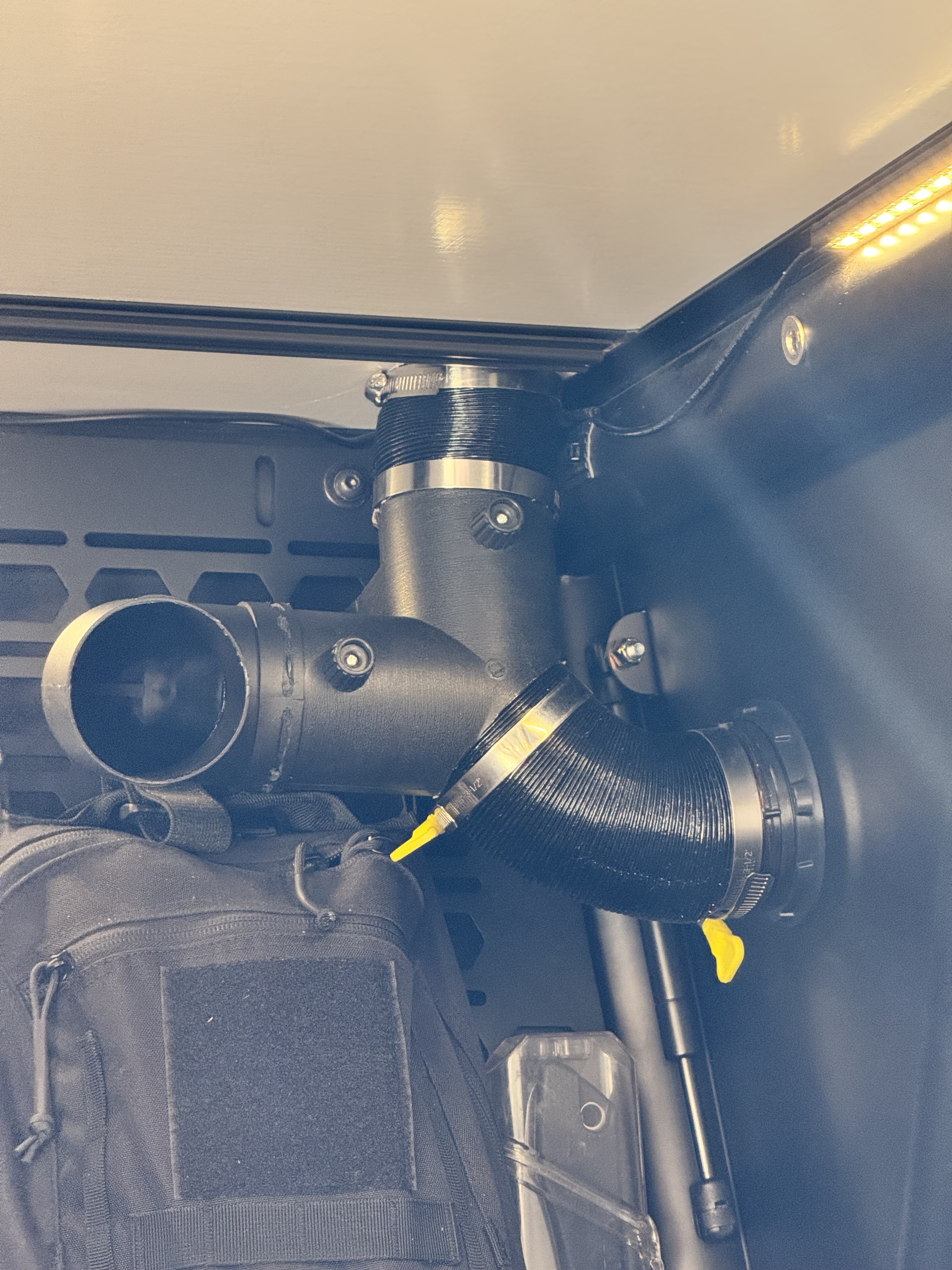

So I changed how my duct goes to the top and added a “Y” coupling that has damper flaps. That way I can decide how much heat I want in the bed of the truck.
This is just my thoughts.
If you are interested I can give links to the parts.
Y coupler
Close up of damper adjustment knobs.

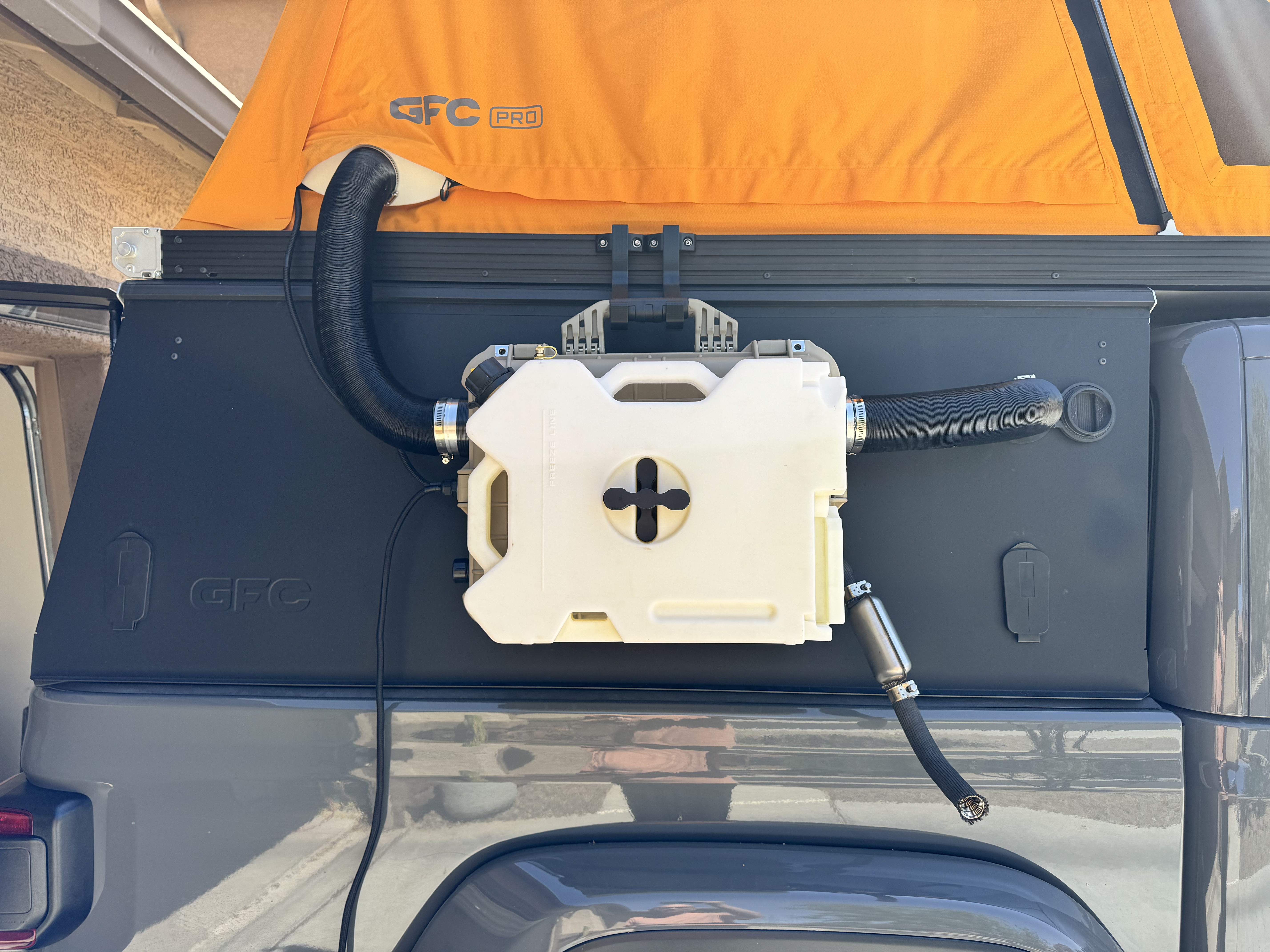

I originally planned to do a similar “Y” connection inside as well, but decided against it because I thought it might be too complicated. My thought was that instead, I would simply use a “Y” connection closer to the heater itself, and outside of the camper. I would run one hose to the tent, under the window flap, and another into the truck through a hole drilled in the Tacoma bed cubby.
You might have changed my mind, however. Your setup looks nice and compact, and also variable from inside the camper - which is a plus.

Diesel heater coupling. I used a vent for a sail boat but earlier in this post JJFColo posted a different coupler. Check it out. I like it better.
Diesel coupler:
https://www.etsy.com/shop/DT3DStudio?campaign_label=buyer_order_confirmation&email_sent=1719240036&euid=EbvmVfFDw4AEhHYcN99m18WyZpak&eaid=1169669984451&x_eaid=74ba1a5d4a&link_clicked=4
3" pvc Spigot Flange. You will need two. Sandwich one on the top and one on the bottom were you decide to go through the floor.
Valterra T1006 3" Spigot Flange , Black
https://a.co/d/1C7X3Lh
75mm “Y” adapter.
SEADEAR Hose Adapter Vent Hose Connector Dryer Vent Splitter Connector Adjustable Valves Duct Connector 3 Way Y-shape Hose Adapter Compatible for Parking Air Heater
https://a.co/d/e7qiMUy

Are you able to still open and close your side door without disconnecting the heater hose? @EasyOffRoading

My solution that I just came up with. The Y inside has flaps to control how much heat goes to the top vs. bottom. I’ll be experimenting to try and figure out the best ratio to maintain similar-ish temps downstairs vs upstairs (for when the kids are with me).
I am still able to open the side door (when the diesel heater isn’t in the side) as the hose connection to the inside of the door is a quick disconnect that just pops in and out easily. Just connect it when you actually need it and you don’t have it interfering with anything during use when you aren’t about to go to sleep.
