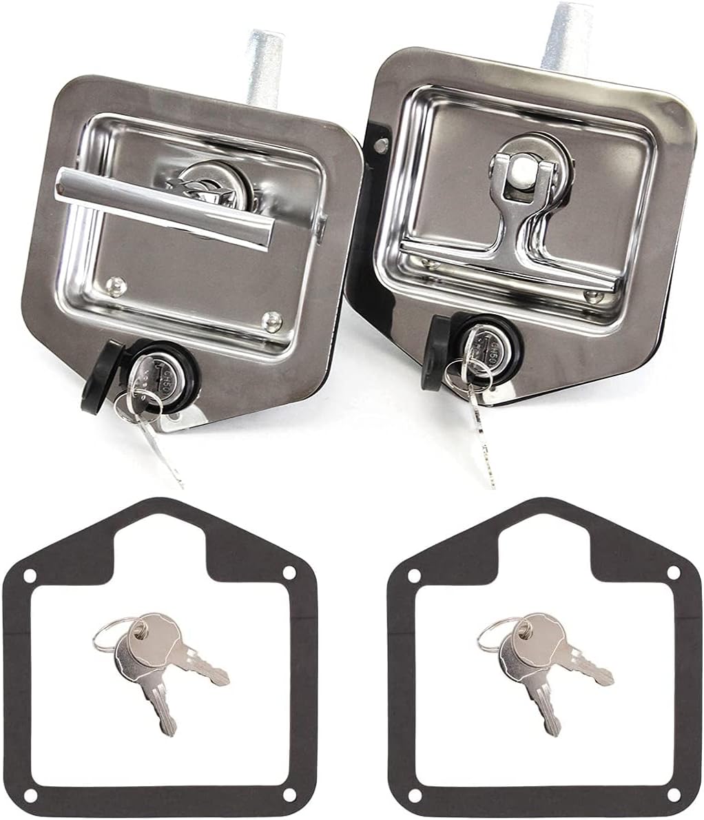

I will be looking at this solution if the covers fail, as we’ve had these types of latches on the line trucks for decades with no problems:
