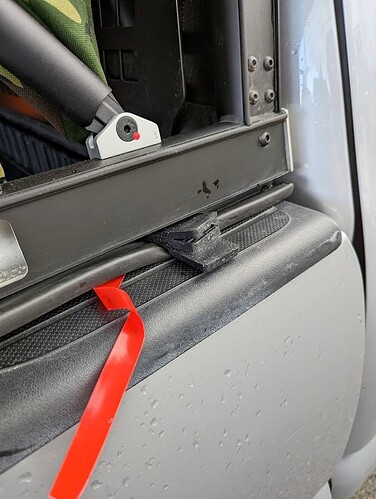

back on and seals installed.
replaced the cab side seal while everything was off the truck. reinstalled the GFC without the side seals and lined it up to the cab seal and bolted all 4 anchors down. bolting it down aligned it more or less where it should be. a little fine tuning and it was good to go.
had to wait for it to not be raining to do the side seals. replacing the 2 anchor bolts on just one side at a time, i used some shims and a flat bar to lift the frame of the gfc and slid in a 3/4" piece of wood. repeated on both front and rear so the entire side was off the bed rail. used a heat gun to dry the bed rail, started the seal, put shims in on top of the installed seal and removed block 1. kept running seal until reaching block 2, added shims behind it on top of seal, and removed block. finished seal install and then pulled out the shims. bolted down that side and unbolted other side - repeated everything. solo took me about an hour all in.
there’s a bit of a trick to the GFC anchors. I ended up loosening the nut and bolt that attaches the upper and lower portion so I could line up the lower portion in a way that when i tightened the upper and lower back together it would add pressure to the weather seal.
here’s some pix
