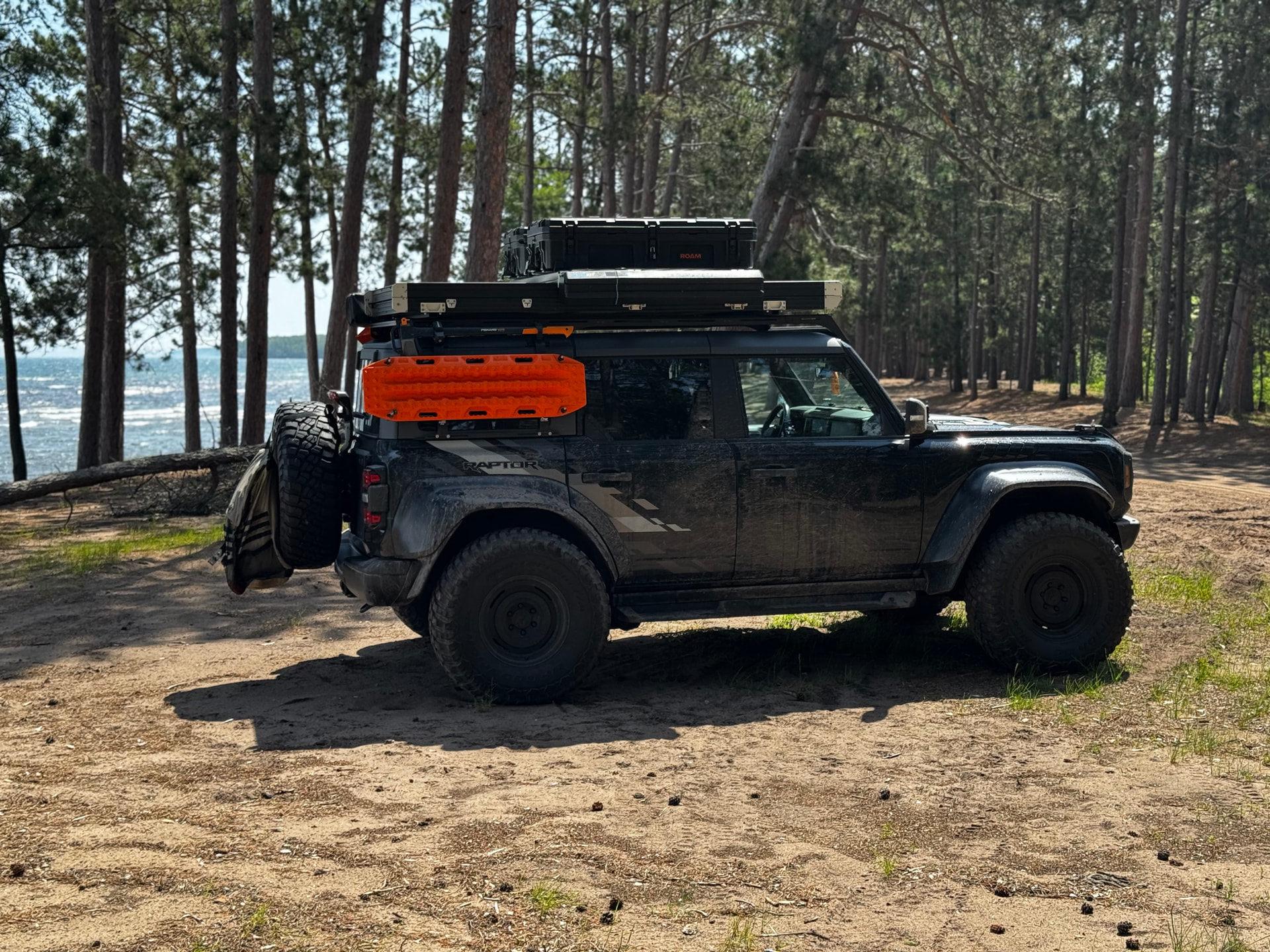

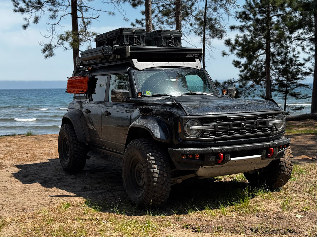

Mounted my shower to the beef bars, filled it with water. Arrived at a campsite at 1am and was very surprised as I could not open the camper at all haha. After draining the whole thing out still can’t lift the tent and had to sleep in the truck bed. Next day fully emptied the shower and the cargo box barely could open the tent and had to put a piece of wood to hold it open.
Very frustrated, what did I do wrong? :smiling_face_with_tear:
Or am I too naive to expect the struts holding any extra weight on the beef bars?
+1 for Naïveté
At 8lbs/gal you are adding a minimum of 40lbs (not sure which shower size you have) to your struts
Also, not sure what , but it seems like you also are carrying some considerable weight in the cargo box
Keep in mind, if you do change out the struts for a heavier weight to support the additional roof load, it will be much harder to close without the additional weight
Yeah mine is 10gal.
But even with empty shower and empty cargo box it doesn’t stay open.
Probably need to look into stronger struts. And/or figuring out if mounting the shower on the side is an option.
Yeah, looking it up Yakima says the 10 gallon weighs 37lbs empty
Beef bars weigh 6 lbs
the average weight for Thule boxes empty is still like 30lbs
So your looking at easily70+ lbs over stock just for empty carriers, it makes sense that gfc has a smaller margin as if the stock ones supported that customers with slick roofs would be pulling easily over 50 lbs overhead
