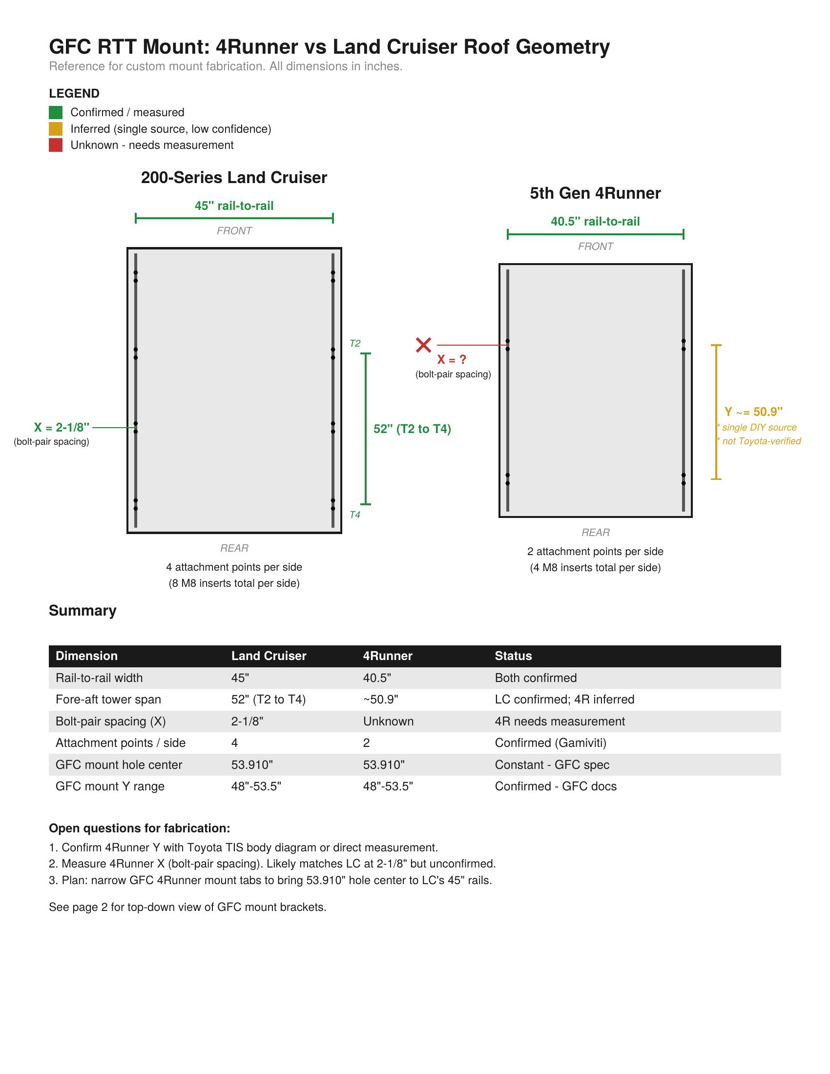

The vehicle: 2020 200-Series LC. Four OEM roof attachment points per side that would be used for this setup (T2 and T4, 8 total though), 45" rail-to-rail, 52" T2-T4 fore-aft. Bolt-pair X spacing on each OEM mount = 2-1/8".
The goal: Lowest-profile mount I can reasonably build. CoG and stack height matter for this build, so the closer the tent sits to the roof, the better. The 4Runner bracket is appealing because it bolts directly to OEM points with no crossbars or platform underneath, which keeps the tent flush.

Where I’m stuck: I’m planning to buy the GFC 4Runner bracket and modify it to fit the LC’s OEM points. I’ve emailed GFC engineering for dimensions, but in parallel I’m hoping someone here has either:
  1. Measured a 4Runner bracket and can share the fore-aft hole-to-hole length and the bolt-pair X spacing at each mount pad
  2. Adapted a GFC mount to a non-listed vehicle and is willing to share notes
Attached: rough dimensional comparison of LC vs 4Runner roof geometry. Green = confirmed, yellow = inferred (single source), red = still missing.
