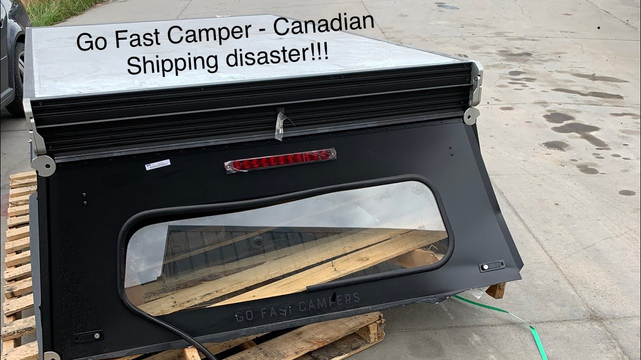

I did a little walk through video of what I received yesterday. Then went through some of my install to this point. If anyone has any thought or criticism I welcome them. I will make another one when I get my platform bed back in.
I wouldn’t reuse that the back door. aluminum weakens quickly every time it’s bent. you might also end up with alignment issues after it’s put back on. It seems like it could have been shipped Ikea style and assembled later with less damage. this just sucks
I have faith GFC will take care of you if you ever get a hold of them
That’s what I was thinking, for anyone considering shipping in this method. I would ask that all panels be removed and packaged. I’m not overly concerned with the door at this point because I too have faith that it will be replaced. So it’ll just be a temporary solution so I can put my platform and electrical back in.
Thanks for checking my build out!

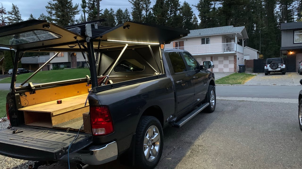

Whew…been a flurry of activity around the house. My gosh, my kids LOVE this thing. It’s like their own driveway treehouse! Been super busy with the excitement, so I’ve gotten quite a few things done.
Put the bed in yesterday…you’ve all seen the finished product of that above.
Then this morning (after I finished the trim for the window in the studio) I used @howcox Universal Bracket ‘Hack’ for my 48” ARB awning. Now the one thing I will note that I had to move the awning up the the 3rd hole on the bracket so it doesn’t interfere with the rear door. Also it does hit the lip on the top of the tent, so I may need to find a thicker cutting board.
Installed some Quick Fist clamps for my Shovel on one side and Axe on the other. These would usually be inside the truck tied up with the paddles in the summer. So this is going to be a game changer.
Then finally after an attempt to use these $20 LED wireless Dimmers from Canadian Tire, I reverted back to the normal light set up. Those dimmers were crap, the option switch broke in five minutes. Bought a second one today and the same thing happened. So back to having landing strip powered LED lights. I’m sure I could rig up a 1Meg potentiometer from the lab with some form of Bakelite knob. But that sounds like a future project; in the meantime…we’re ready to camp!!!

So if anyone was interested, the weight of this XL platform camper is 374.8lbs.
Also, just weighed the truck with the plywood platform, battery, and electrical and that portion is 220.5lbs
In the end in ends up being lighter than a 4wc camper, which is the goal. Obviously there would likely be another 200 - 300lbs added with gear when it’s all ready for a weekend of camping.
Empty truck weight = 2750kg
GFC on truck weight = 2920kg
Platform bed, GFC, and truck = 3020kg
I can’t remember how much it was with my leer canopy, but it was definitely close to the same.

I’m sad to report that I’ve fallen victim to GFC’s lack of customer service. I’m super bummed and feel that I’ve been nothing but open about my decision and am laying no blame on them. Regardless I’m feeling ignored as a customer who just invested heavily. This is the last correspondence Monday morning.
I’m now finally starting to get upset about how I’m being treated as a customer. I’m not one to voice my opinion online, but I feel it’s important that other users and potential customers get a true picture of some customers experiences.
Just like I made the decision to ship the camper independently you can make the decision on how you feel about this post.
I don’t anticipate any support moving forward from GFC.
