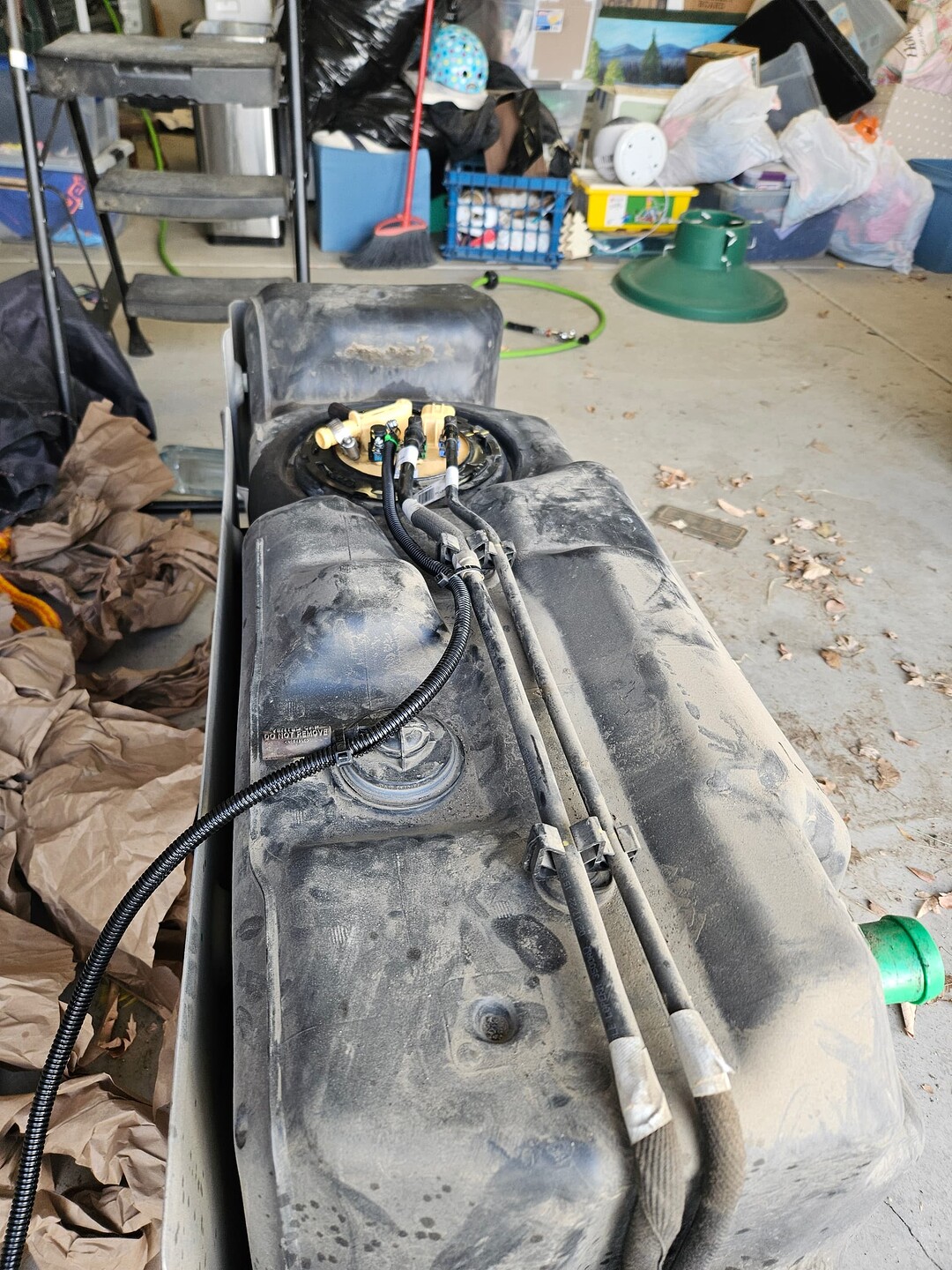

  • Erberspacher AS3-D2L diesel heater hard mounted and tied into truck fuel tank.

The diesel heater ended up going under passenger side front hatch. I drilled a 5" hole for turret mounting plate, dropped fuel tank to add standpipe to fuel sender unit, secured air intake and exhaust lines under truck, mounted heater control near accessory power box I built, and secured a heat duct at front right of camper.
The heater fired up on second attempt of the fuel pump self priming, and it ran great for first 30 minute test run. Looking forward to putting it to use for some overnighters this ski season.
