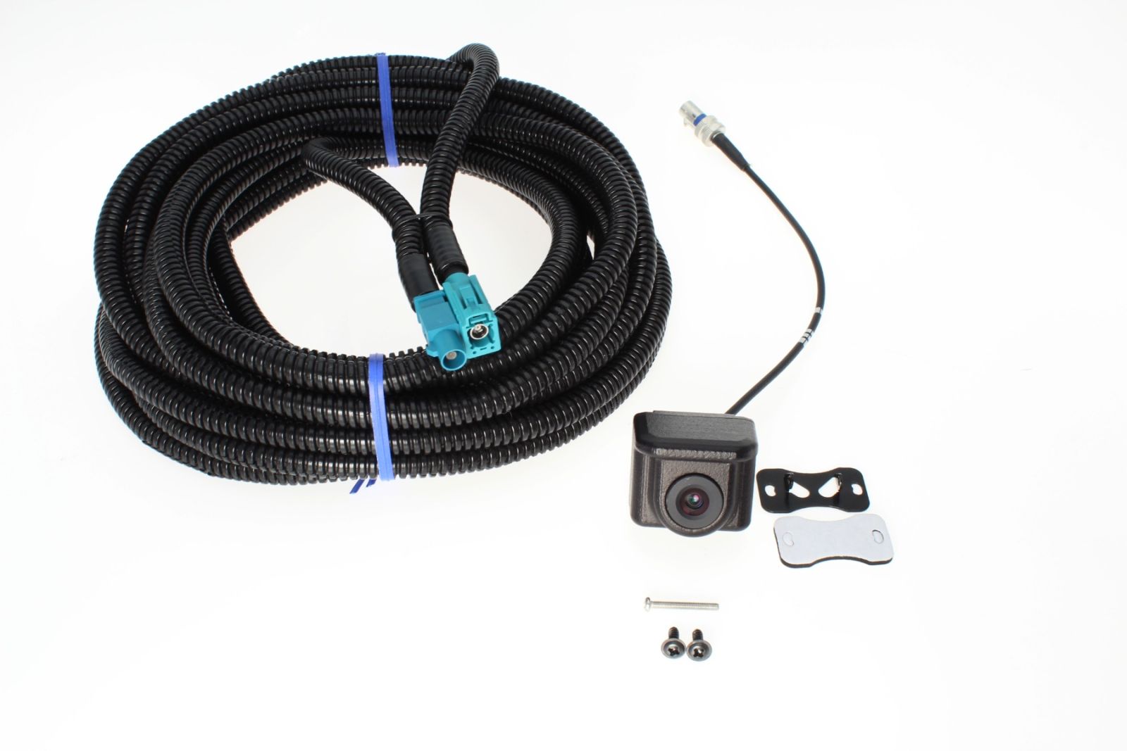

One of the first things I tackled was ordering a rearview mirror camera relocation kit from Camera Source so I can get my rearview camera back. The GFC blocks the factory third brake light and camera. This took a little bit of time, but it wasn’t too difficult. Disconnect the factory camera in the headliner from the rear seat area, mount and run the wire from the back of the GFC through the GFC into and out of the bed of the truck, along the frame rails and into the cab of the truck. Came out well and camera restored.
Disconnecting the factory camera
IMG_7633
I utilized the existing hole for the third brake light on the GFC. Used a Dremel to make a little slot for the camera wire to sit in. Used sealant to make sure it’s weather tight.
Camera and brake light reinstalled and works great.
Rearview camera operation restored.

Nice job on the rearview mirror camera relocation.
After I picked up my camper over a year ago I looked for one of these but came up empty.
Which version did you use? I think I found the right one, but it asks if your topper is ARE or Leer…
Hey thanks - I had the same question. I called Camera Source and talked to their support, who are really nice and helpful, and they said I would be better off with their “universal” camera kit. I hadn’t even seen it as an option till they mentioned it. The only difference is that it comes with a little surface mount bracket, screws, and adhesive pad to mount the camera instead of a specific bracket that only fits an ARE/Leer third brake light.
Here’s a link to an example of a universal kit. The part number ends in U to denote the difference.

Any tips on hooking up the third brake light?
@ColoradoBuckeye
It was a huge hassle for my 2023 Silverado, i had to take it into the dealer as the wire i connected to… triggered an issue with electrical draw… Apperently vehicles can now sense electrical draw.
My local dealer had to run a wire from the engine bay all the way back.
I’d assume a similar issues with the GMC.
Maybe this will help ya…
