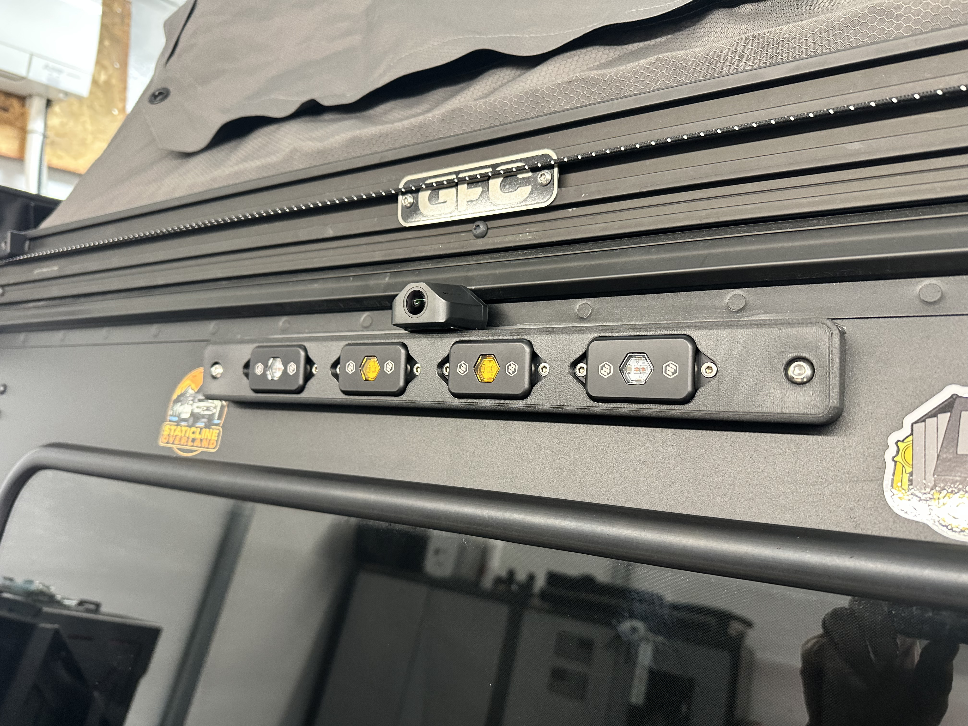

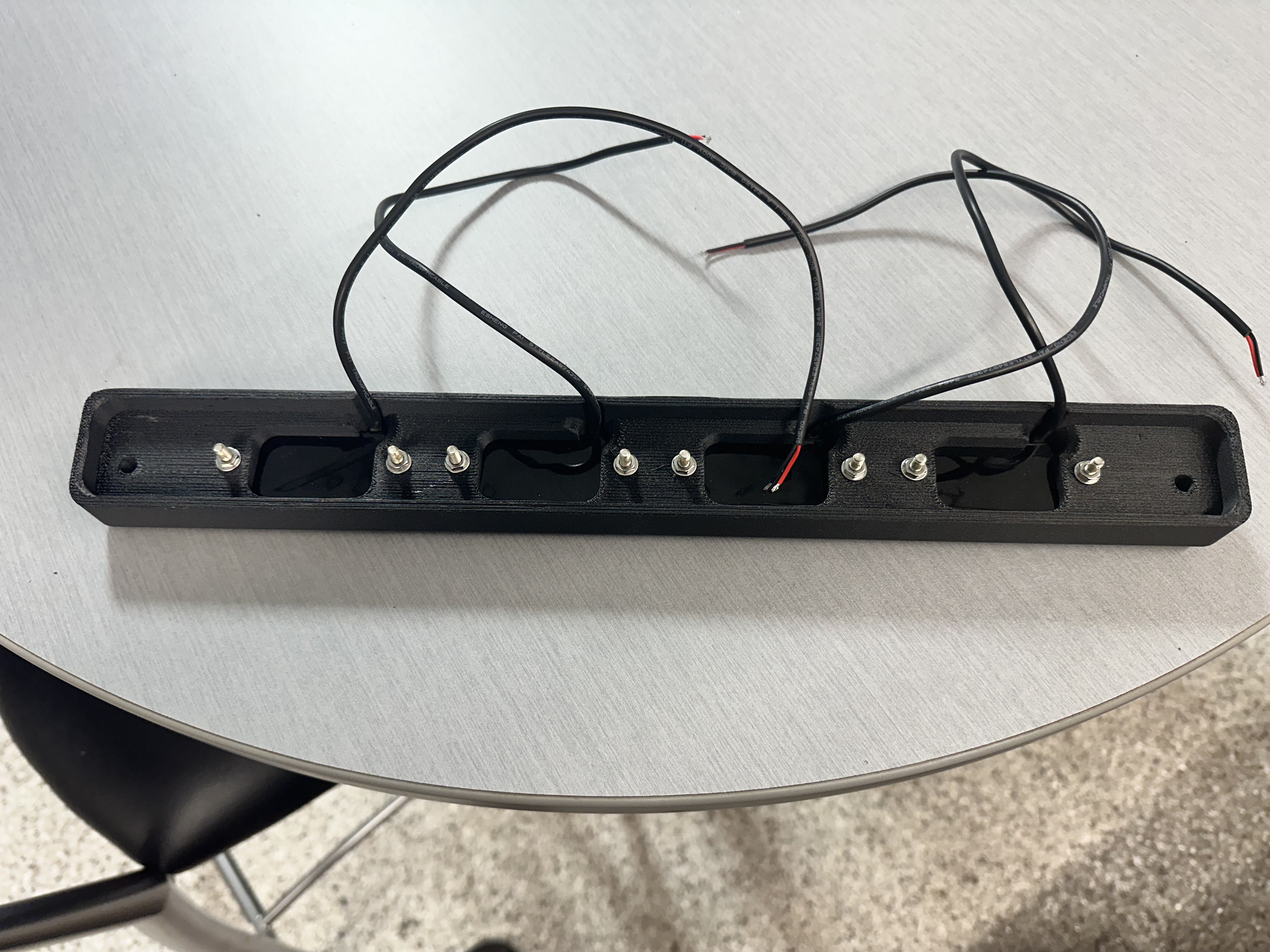

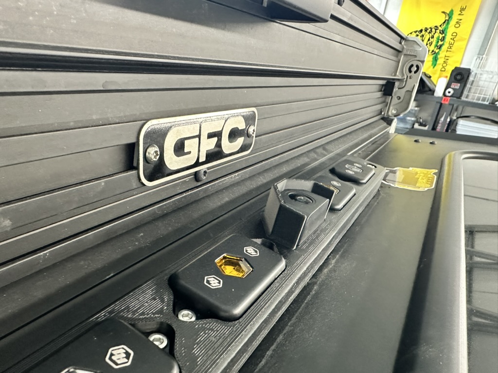

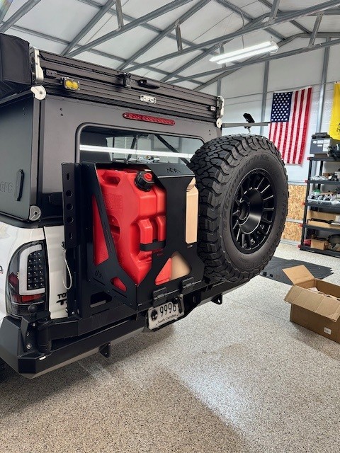

So because like many of us I can’t leave well enough alone I am going down the rabbit hole of swapping the factory GFC brake light out for a multi-purpose light mount.
When finished it will have two brake lights and two chase lights replacing the existing chase light shown as well as the factory GFC light.
The brake lights will be dual intensity, coming on with the tail lights and going full intensity with the brakes.

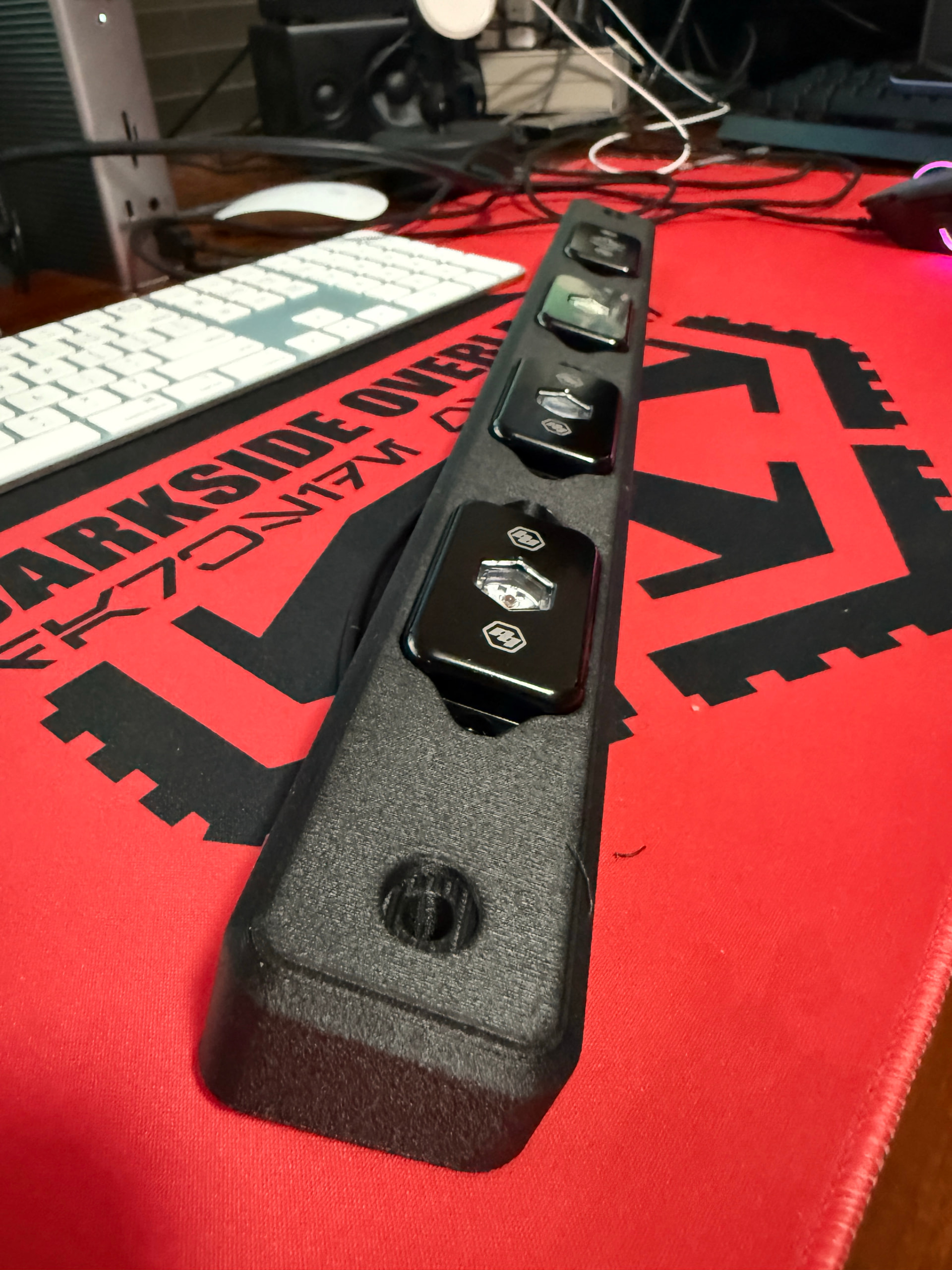

3D print from:
Darkeside Overland admin@darksideoverland.com
or
Darkeside.overland

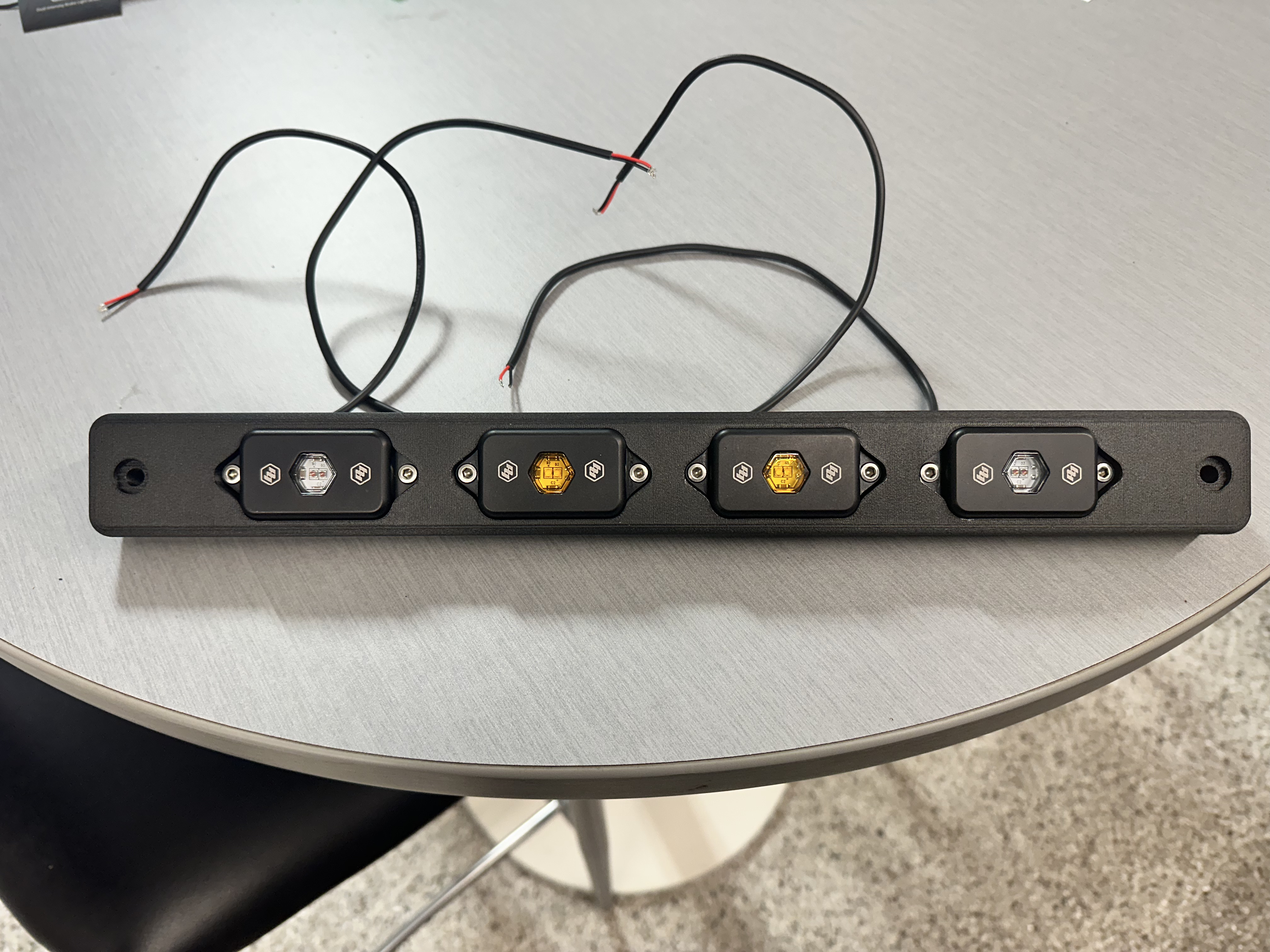

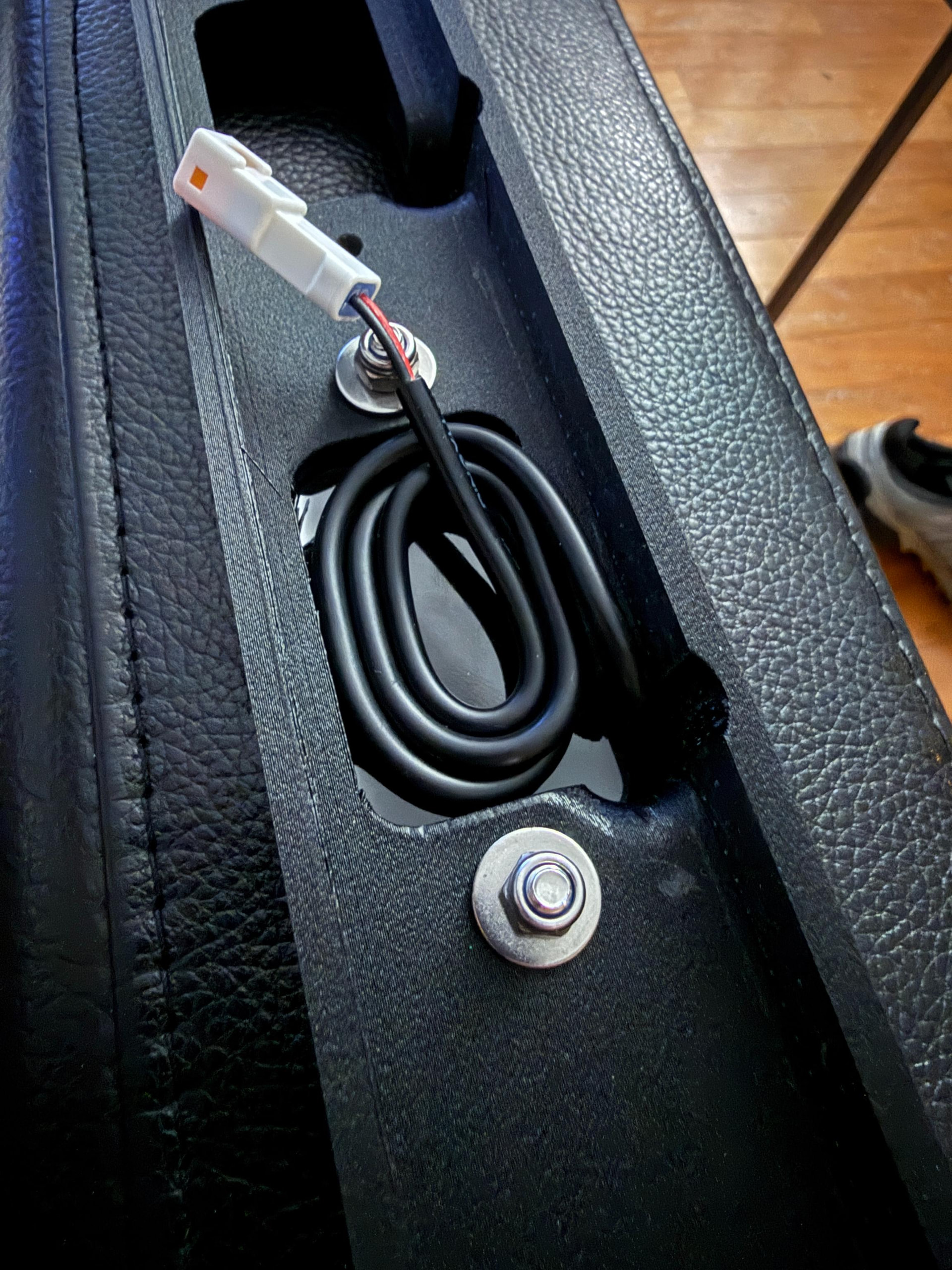

After a shipping delay the lights finally arrived. I switched up and decided not to use the dual intensity light module.
I added a dual intensity relay from Diode Dynamics to the red lights, now I have a running light/brake light combo along with the chase lights.
Running Lights/Brake Lights
With Chase Lights

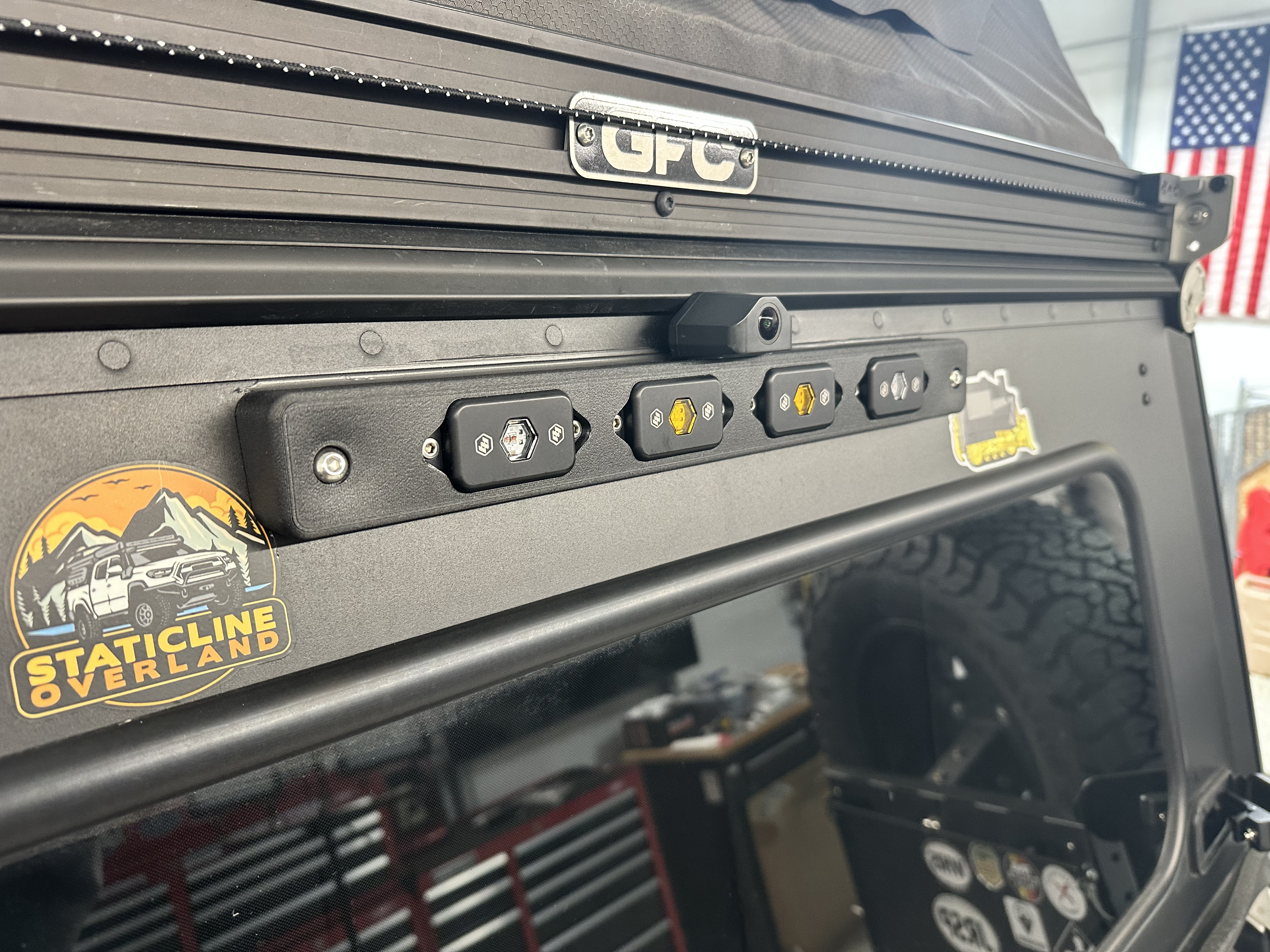

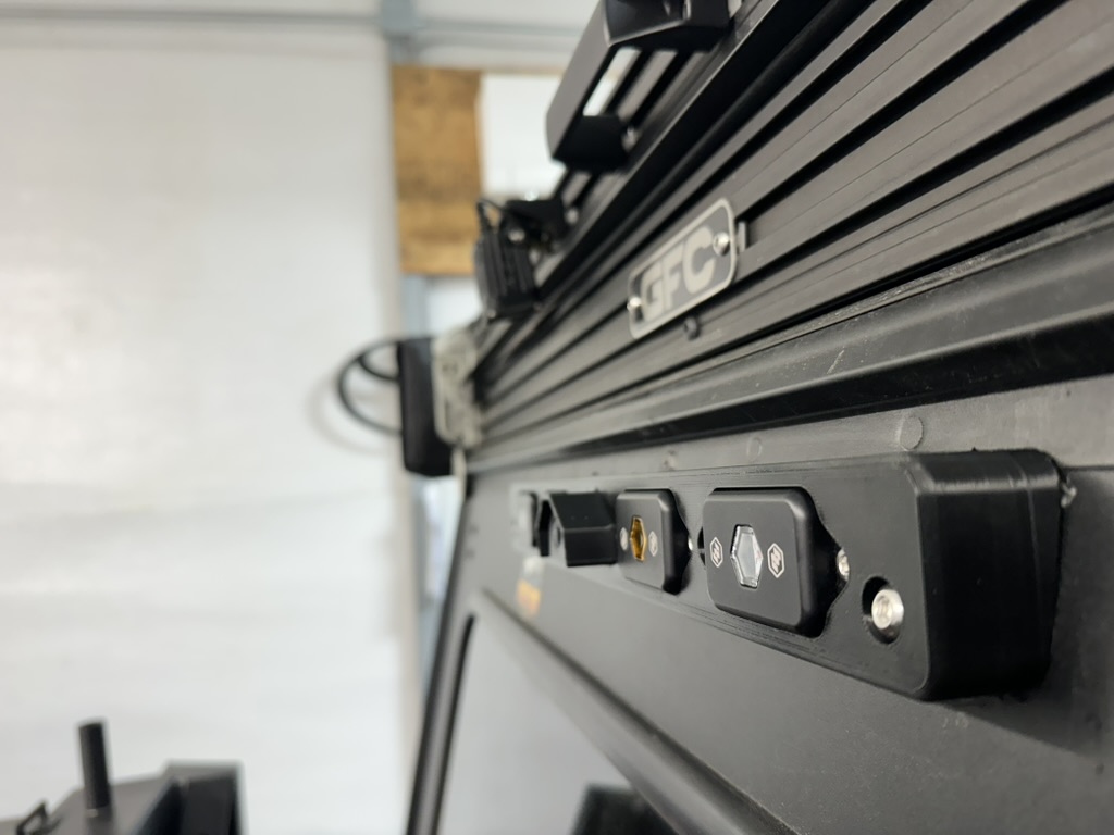

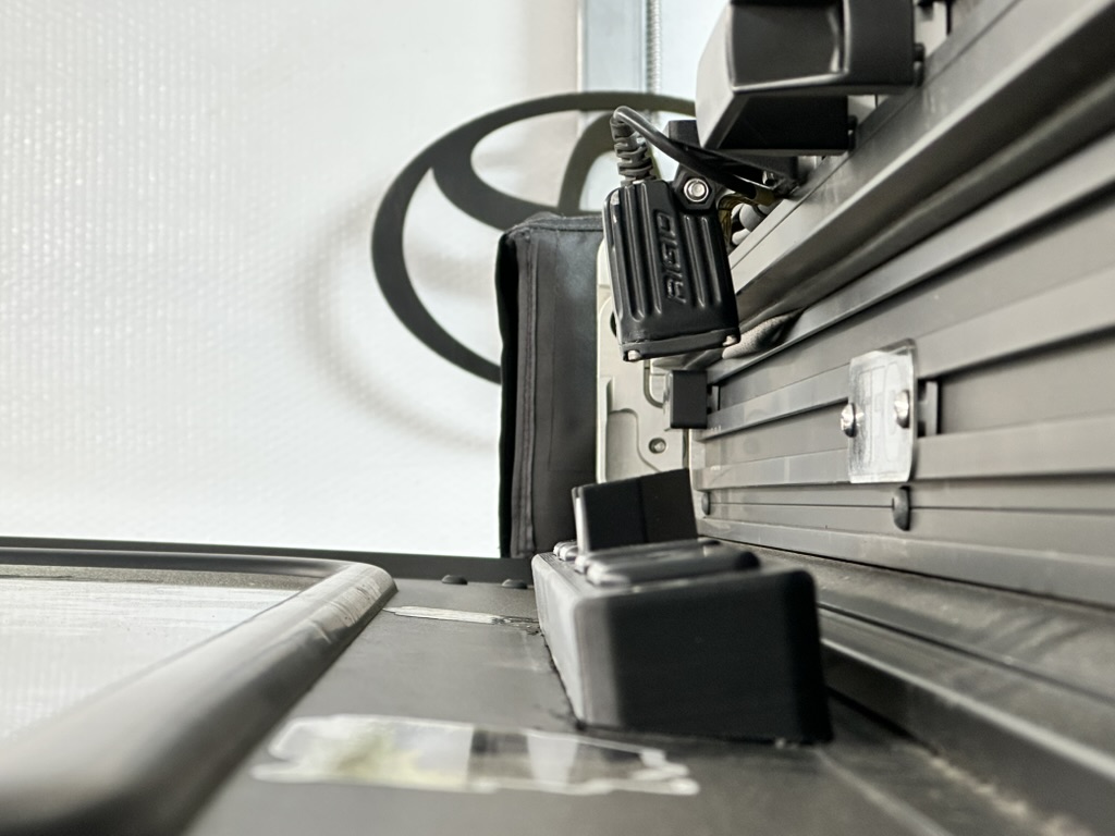

Installed version 2 of the Baja Designs light mount today with incorporated Wolfbox camera mount.
The camera slot is tapered so you don’t need to use screws or tape to secure the camera, it is held in place with 2 4mm screws and washers from the rear.
The camera shroud does not interfere with the rear hatch fully opening.

does this use the GFC’s factory brake light holes? I’ve been looking for something like this to incorporate chase lights in to the brake light area.
It sure does, bolts right up!
