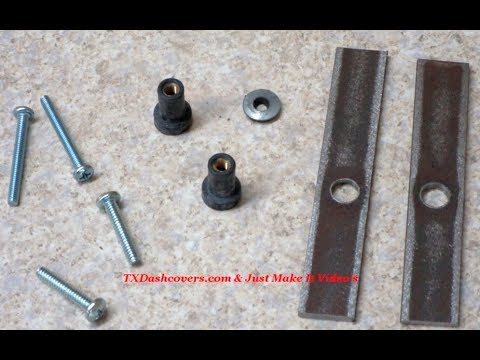

Looking to add more anchor points, would like to find the same screw/rubber grommets that comes with the V2. Thanks!
You should be able to find them at well-equipped normal hardware stores. They are called rubber well nuts. I think GFC gave the specs in a previous post. I’ll edit if it find it.

Thanks! I found them at my local Ace Hardware. I discussed adding additional holes when getting my install, they said it shouldn’t be an issue for structural integrity or warranty, but I imagine there is a tipping point (as in too many holes).

Can you post the part number or sku from Ace? Im interested in buying some
I’ll be keeping a eye on this!!
i couldn’t find it on ace’s site
https://www.homedepot.com/p/Everbilt-1-4-in-20-tpi-x-5-8-in-Brass-Expansion-Nut-814378/204275875
Anyone know what size bolts fit the well nuts on the V2 Pro? I went out and bought 1/4-20 without checking and they are too small.
5/16-18 @Dempster333
Awesome, thanks! That is what I was planning to try next.
