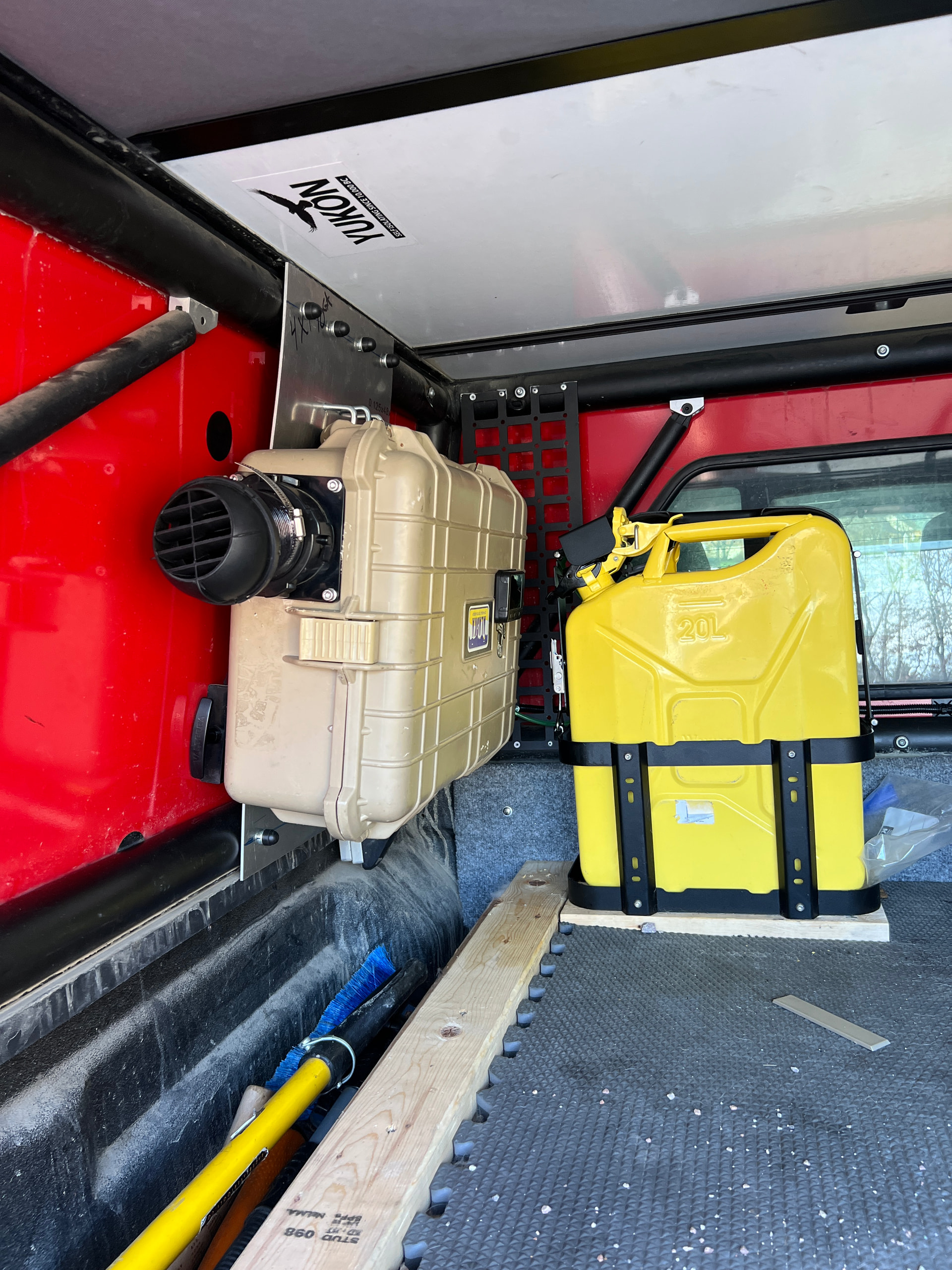

FWIW, I would double check your results… I didn’t follow all of the links, but for ex the listed AL tank actually links to a plastic one. AI hallucinating and all that…
$750 total for parts. It’s not nearly as clean as the GFC version but it’s a fraction of the cost and it works. It’s been over two years of heavy use without any major issues.
