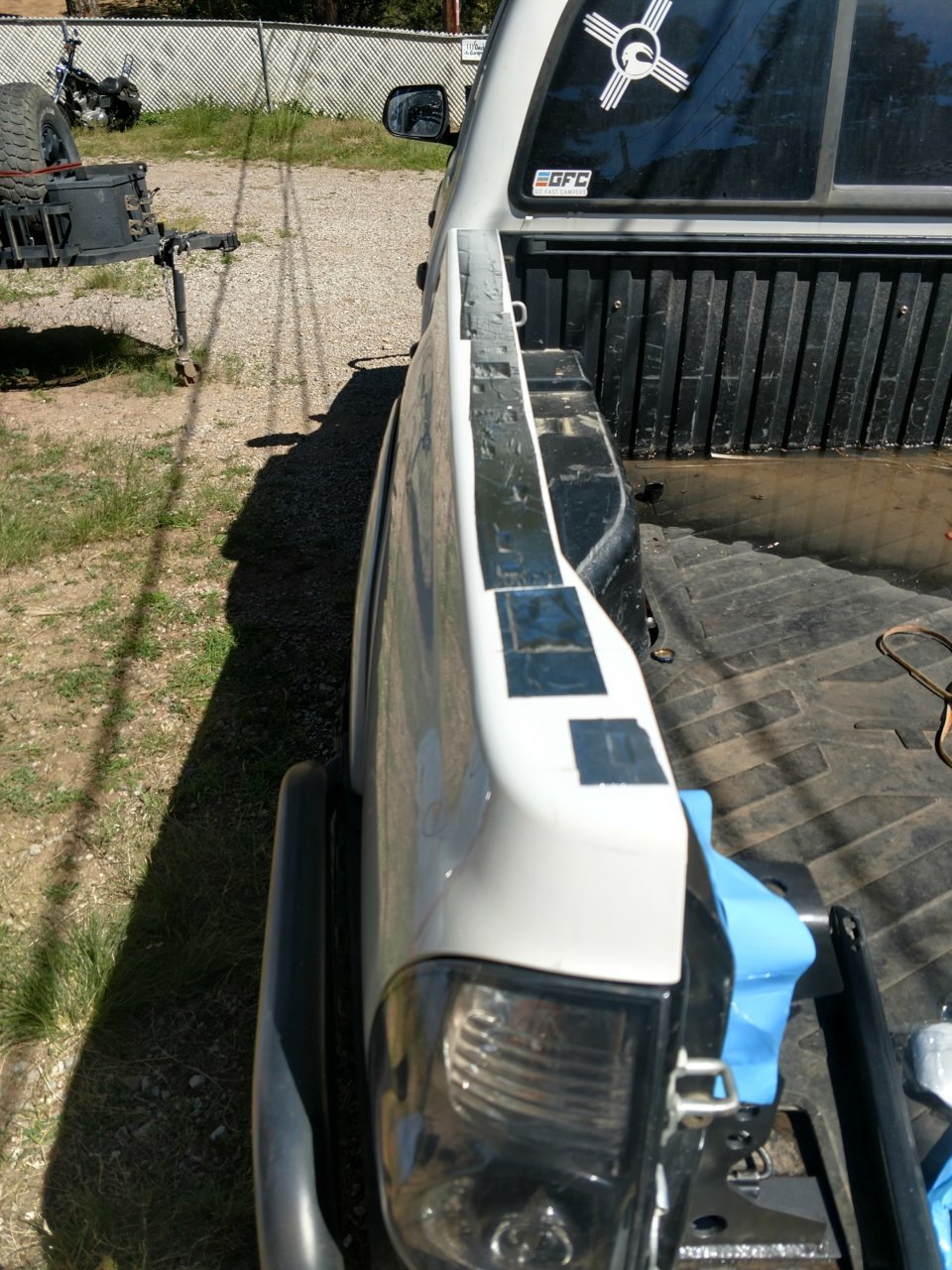

I am very intrested in the thread as i am build #1027 and I was looking into sealing my bed. I know that there can be water intrusion form both of the side cubbies toward the tail gate. May need to put some sealant around those areas. For the front corners toyota makes filler plugs (parts number 62541-04010 and 62542-04010) They are a bit over priced IMO. I have also seen people use black silicone or you can get some water resistant adhesive foam pads. When i had a tonneau cover they were supplied by the company. I heard if you contact Truxedo (a tonneau cover company) they can provide you with the foam caps at little or no cost. See picture below

Is this diagram for the Toyota filler plugs? Or the truxedo ones?
Thanks!
The diagram is the truxedo plugs. It is just a small piece of foam.
