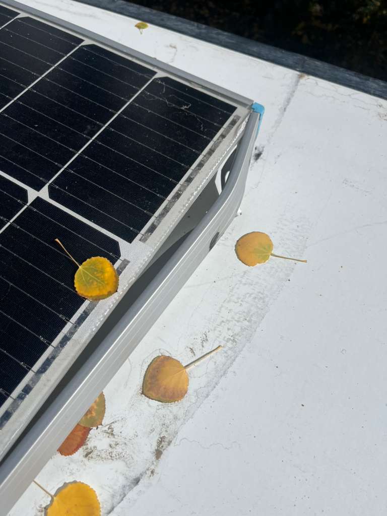

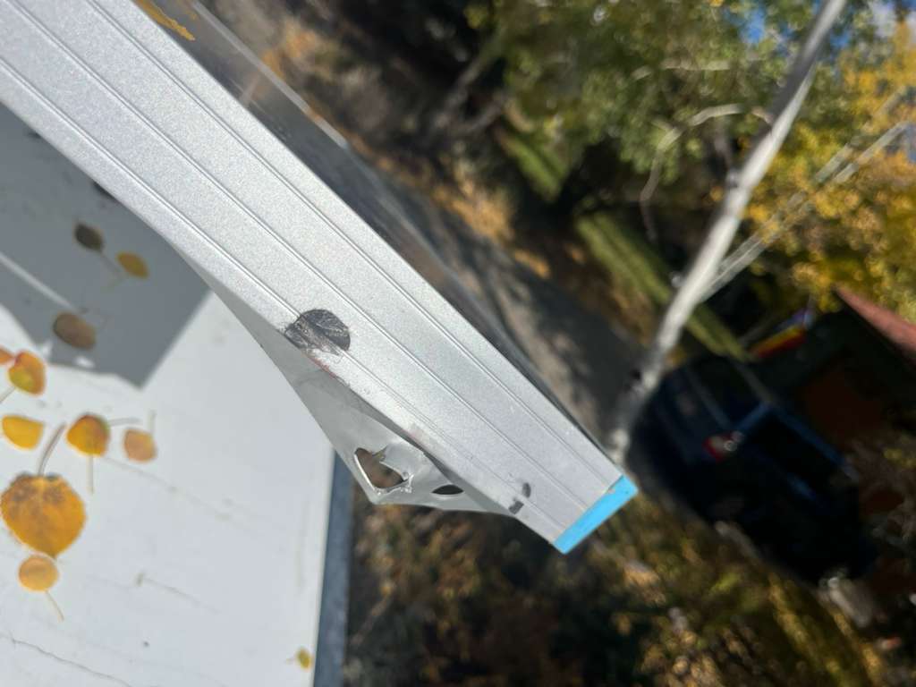

With the way the remaining solar panel is bent, the person who stole it off a residential street would have had to violently yank it off. Also, the cables were torn and there is part of a z bracket from the missing panel still there. It definitely came off on the highway. How I didn’t hear it? Ask the road conditions of the I-15 north of Salt Lake.
See below said parts where the z-brackets were torn off the remaining solar panel.
