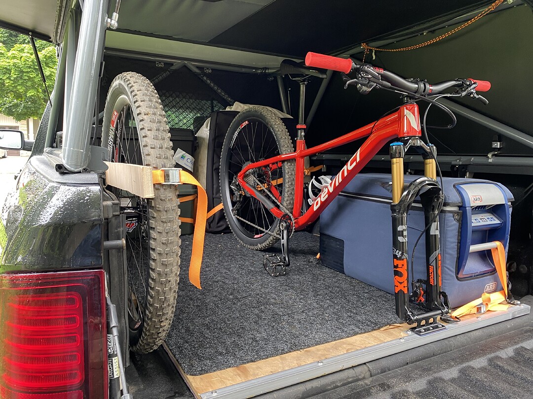

I don’t think this warrants a new thread, so I’m resurrecting this one…
Here’s my ghetto solution that allows me to keep the bike out of sight when I’m at work, so I can go direct to the trailhead at the end of the day.
I attached rivnuts to some 1/8” aluminium so I can remove the fork mount quickly if I need to empty the bed for “truck stuff”. The aluminium angle also stiffens the edge of the plywood to reduce side to side flex.
Then I needed somewhere for the front wheel to go. I spent way too much time over engineering this, and on the scavenger hunt for all of the bolts in my garage.
Overall, it works for around town. I imagine it would be a bit of a pain to travel like this. For travelling, I’m going to look into another fork mount sideways, near the front of the bed.
Attaching the fork to the tailgate is a great idea. If I had seen this a week ago, I probably would have just installed rivnuts in the tailgate and put the fork mount there.
Great solution!
