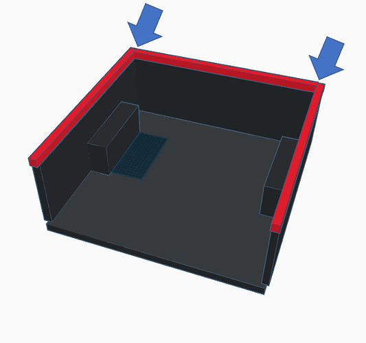

Yeah I had to seal those spots with silicone originally. This time, I plan to keep as a continuous seal by cutting out a little v shape to make the 90 degree turn, so there’s no seam.

I asked about why GFC doesn’t attach it directly to the camper and they told me then the ‘bulb’ wouldn’t be oriented the right way because of the shape of the space frame. I thought a guy could just put strategically placed VHB 1/4” or 1/2” in between the bulb and try it that way. It’s worth a shot :wink:
The bulb seal’s purpose is to be a mediator between two hard surfaces: the bedrail and space frame. Given that the space frame is rounded, you want a seal that will cradle and wrap around the frame. This is why we use the kind of bulb seal that we do. In short, this creates the best seal possible given the profile of the space frame. If you do the inverse and apply the seal on the bottom of the space frame, you lose the benefit of the seal cradling the frame, while also creating an opening for debris to accumulate inside the channel of the bulb seal. Sure, you can run VHB (or something similar) to fill the opening, but you are creating more work for yourself by being a rebel :wink:
