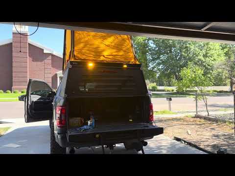

Installed 2 Heretic Studios amber chase lights - wired up through the camper frame, down through the truck bed, along the frame, up into a switch pro sp9100 that is controlling everything.
Install went great! Fishing the wires around the internal 90 degree bend was a huge pain, but there are two things I would recommend to help out.
  1. Twist your wires before you install. You can do this with a clamp at one end, then hook them into a drill chuck on the other and spin until they are twisted about 1 revolution per 2 inches or so.
  2. Use expandable braided sheathing. This stuff is pretty low friction and will also help protect your wires from some of the sharp-ish edges that you will be running wire over and around.
Anyway… pretty fun little project!

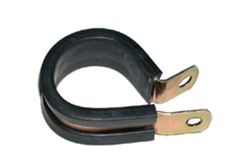

Has anyone seen an install on the top rail? I would like to install so when the tent is open I can light up a large section of camp. Struggling to decide how to wire it. Appreciate any support or links to forums
wire go from the front and go to the top, make a U-shape at the hinge, then follow the top rail.
Use this to run the wires to the top rail:
And obviously use the t-nuts
