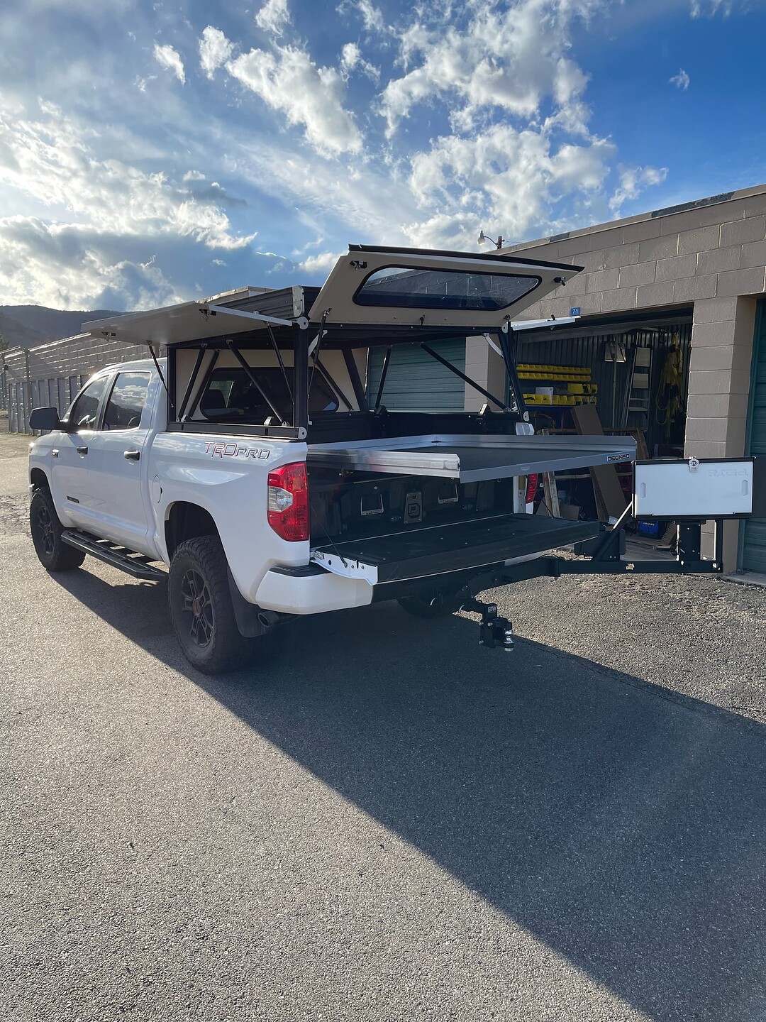

Looking forward to seeing your build. I have a 2017 white Tundra Crewmax 4x4. I paid a deposit for a used GFC v2, being delivered on Monday 5/27/24. I already have a 2" lift (6112/5160 with deaver leaf pack), 285’s, DIY cubby/drawer system and I fabricated my own full length rock sliders (COVID project). Finally pulled trigger on selling my truck shell and picking up a GFC.
The GFC comes with a few mods, but looking forward to seeing what’s good for another Tundra. I’m already looking into modding the front panel and making the front window removable (or hinged) so I can access the cab from the bed.

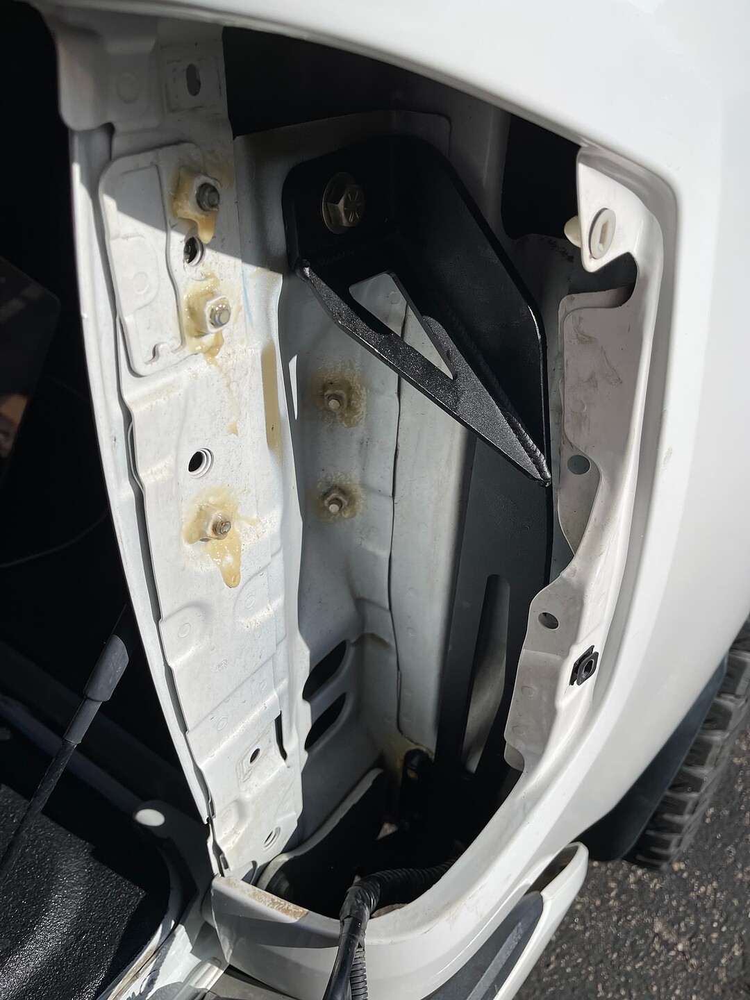

I had been getting some squeaking from an unknown source when rolling over bumps and this mod completely fixed that. I thought of putting in the total chaos stiffeners as well, but I don’t think they’re needed after installing these:

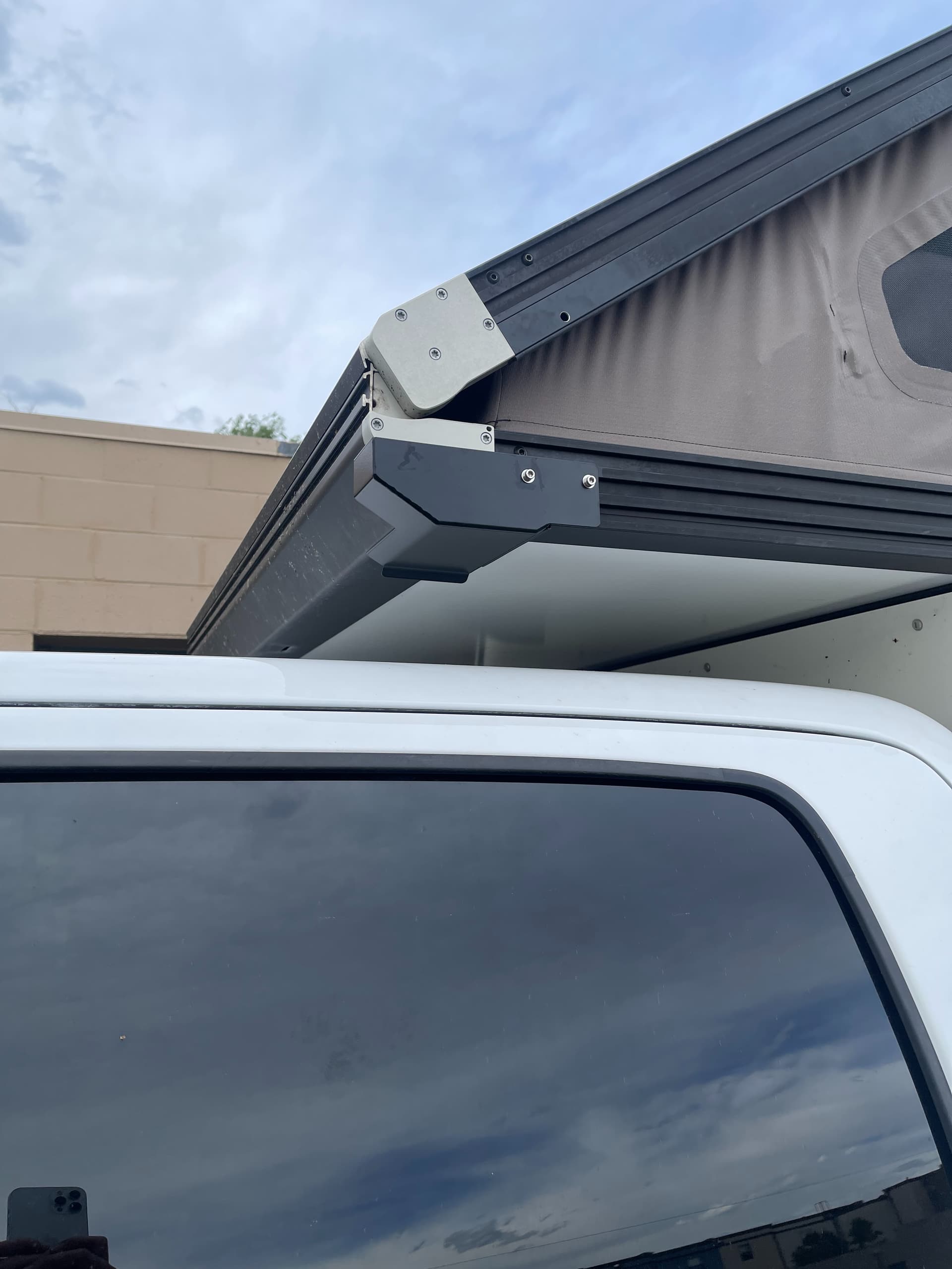

Also added a Mountain Hatch for the tailgate surface. I relocated some of the mounting points so I can still service the tailgate lock (have had the lock actuator fail before in the cold)

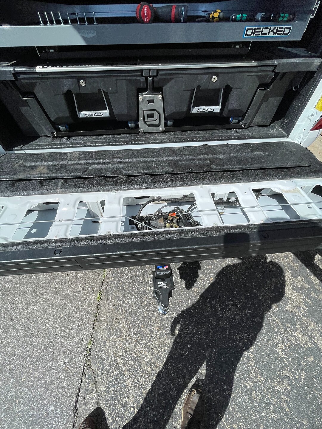

Then made up some spacers out of HDPE so that I can mount a Rotopax on the swing out and still clear the Side Hack. I also relocated the license plate mount so the plate wont be obscured by the rotopax.
Here is the final product. Moved my backup camera to mount on the top of the HDPE spacer. Perfect view of the trailer hitch for hooking up trailers (which I have to do often). Also a hint in these pictures as to a future project to be posted here soon.

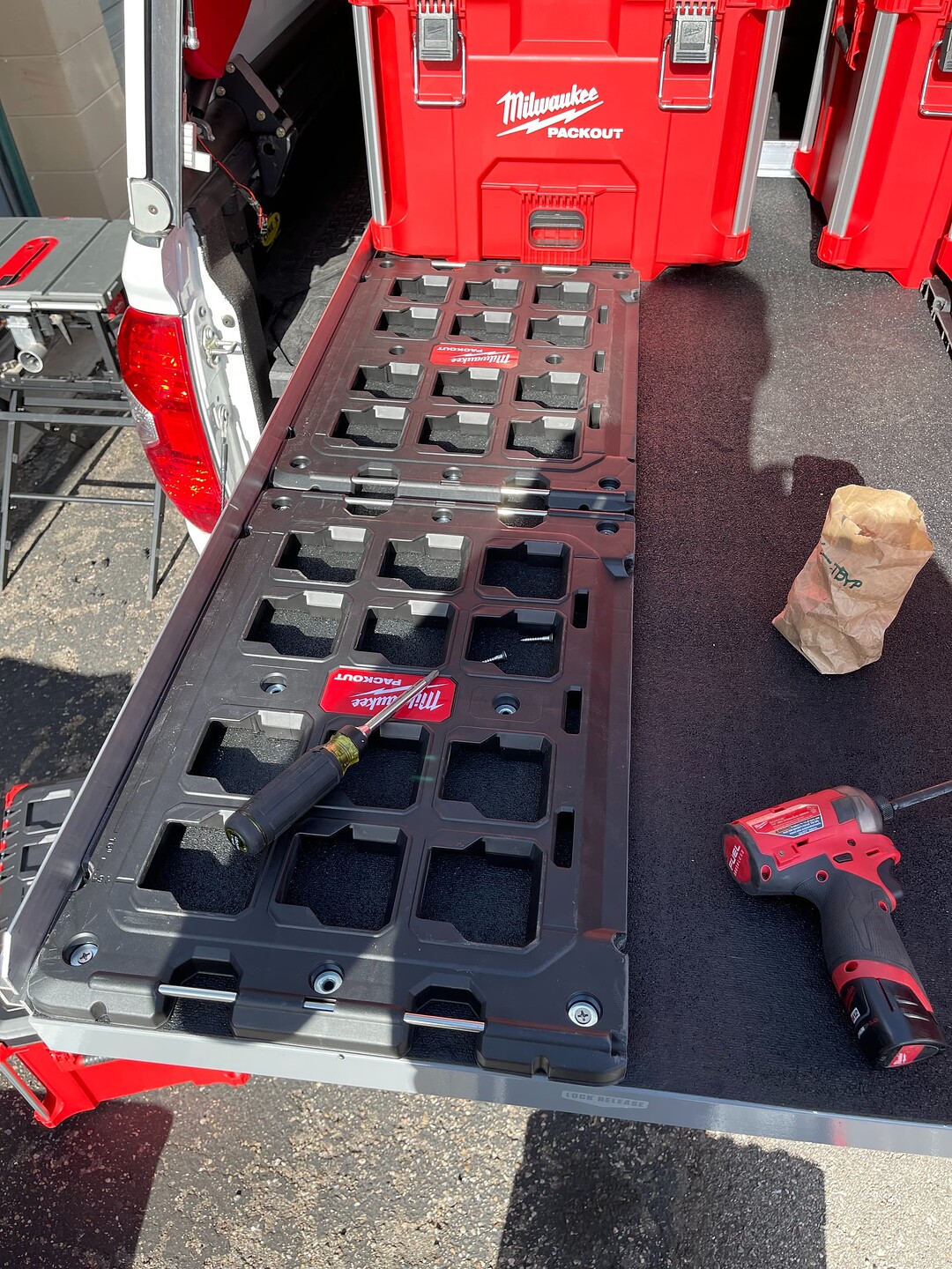

Modified some Milwaukee packout mounting plates for my needs to create a bench / storage system using their XL Toolboxes and their biggest cooler (same exact size as the XL toolbox)
Used a Dometic cordless tap, in connection with the cooler, a Packable Joey Mount, and some accessory Milwaukee makes that is some sort of cup holder??? to create a running water system. When you pull out the bedslide it clears the tailgate and the water doesn’t get all over your truck bed.
A few little additions: Got some of the Milwaukee Packout work surfaces to make a more comfortable bench setup, Screwed down my Cook Partner 22" stove to one of them so I can use it inside if it’s raining or on my tailgate table to cook outside.
Added a small Packout storage box under the stove. Planning to keep my tea in there. The storage box next to the stove will be to store other kitchen utensils etc. Can easily click it off and use outside, if I want to cook on the Rigd swing out table. This setup also has the added benefit of making the top of my stove relatively flush with the adjacent work surface, so I have a pretty reasonable “countertop” setup
