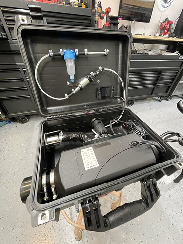

My latest build using one of my 3D printed kits (like this one - DIY Diesel Heater in a box: How-to - YouTube)
Did the fuel filter you have attached come with your heater, or did you buy a different filter?
It came with this heater, I hear it’s not a good one. (it’s my first time using this brand of heater). So I just picked up some nicer in line filters to replace. https://amzn.to/3KAEboA
