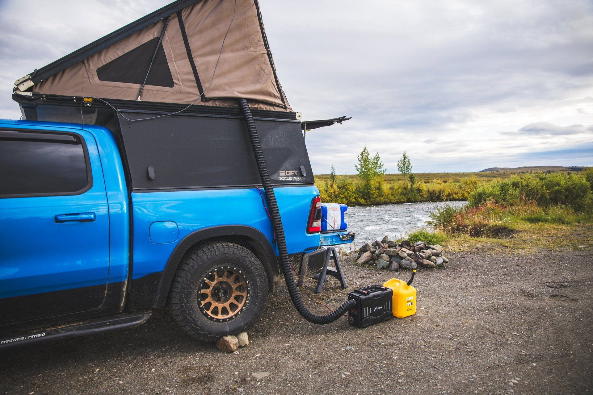

Just got the HCalory TB max for my camper. I do not have the camper yet, I pick it up in April. Just looking for some input on how others are using their diesel heaters! My plan is to put it on a wheel step I have. Then want to add a port to the side panel to put the heat in and run a hose from the tent back to the heater to recirculate. Again, this is the plan at this point but we all know how this can go. I live in CO and am looking forward to having a good source for heat in the unit.

I tend to do that. lol. Do you find that putting the heat line in the tent heats up the bed area too? Keeping a dog lower.
hmm not sure tbh. usually when im in there when not sleeping i have the floors moved so it heats the whole thing, but when i’m sleeping i close the floor and i have no clue how it is downstairs.
but if you’re open to sleep with only one floor panel not put in i don’t see why it wouldn’t work well.

theirs is a bulkier option as it’s mounted inside. if you go with a case type like I did then it doesn’t take up that much of space.

just get yourself a hcalory one and done. you can remove it when you don’t need it as well.

I like what they are doing but I just figured that I am not living in mine so the cheap chinese diesel heater is the better option…if it fails too, I not out a whole lot of money. I ended up getting the TB Max as it is supposed to be almost weather proof (they are going for a IPX4 cert on it from what I understand). I really thought about the pelican style box too, seen in this thread, but opted for the newer TB model.
