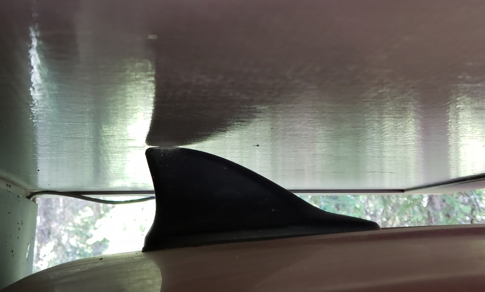

No interference on reception but if you have a shark fin antenna cover it may make contact at some point.
I’ve had my camper a little over a year and the other day I noticed the antenna was now touching the camper. I suspect it’s due to the plastic bedrails on my 2nd gen Tacoma compressing because the forward camper attach bolts were also lose.
Interestingly enough the shark fin was actually getting worn down by the composite bottom of the camper overhang.
I replaced the shark fin with a lower profile replacement and now have lots of clearance.

Refer to @Evan220 comments and pictures above. I believe a 3rd Gen (2019) Tacoma with a GFC V1 Camper has a different clearance on the shark fin than a 2014, which I believe is a 2nd Gen Tacoma. Your best bet is to email Support@gfcengineering.com and ask them.

The shark fin has never been an issue on 2nd gen Tacoma assuming you have stock bed rails. If you replace your bed rails with something thinner then there may be a clearance issue.
on a second gen esp if you are replacing the bed rails you will want something like this
