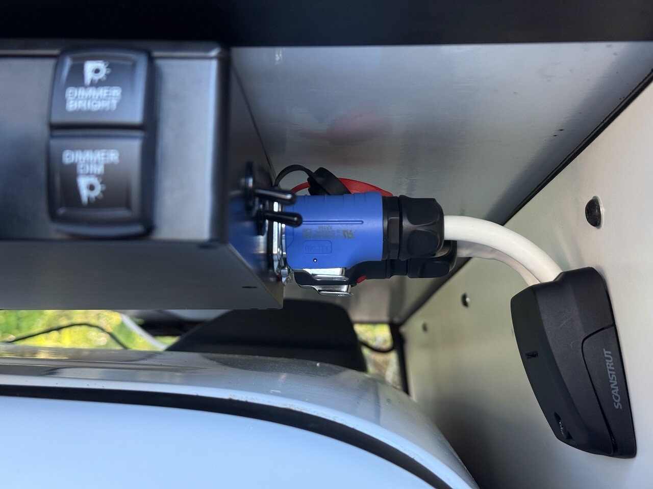

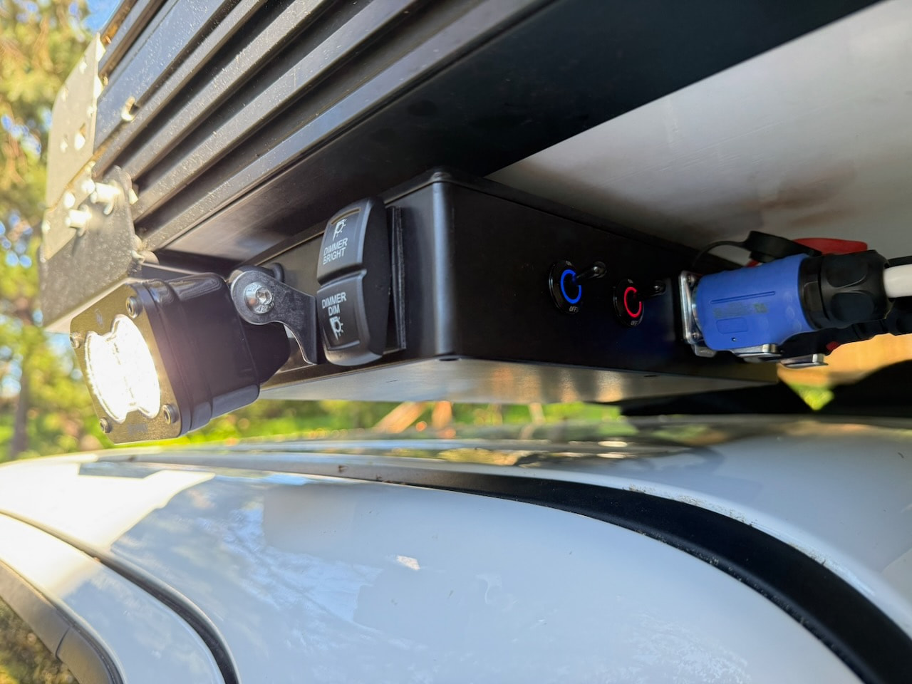

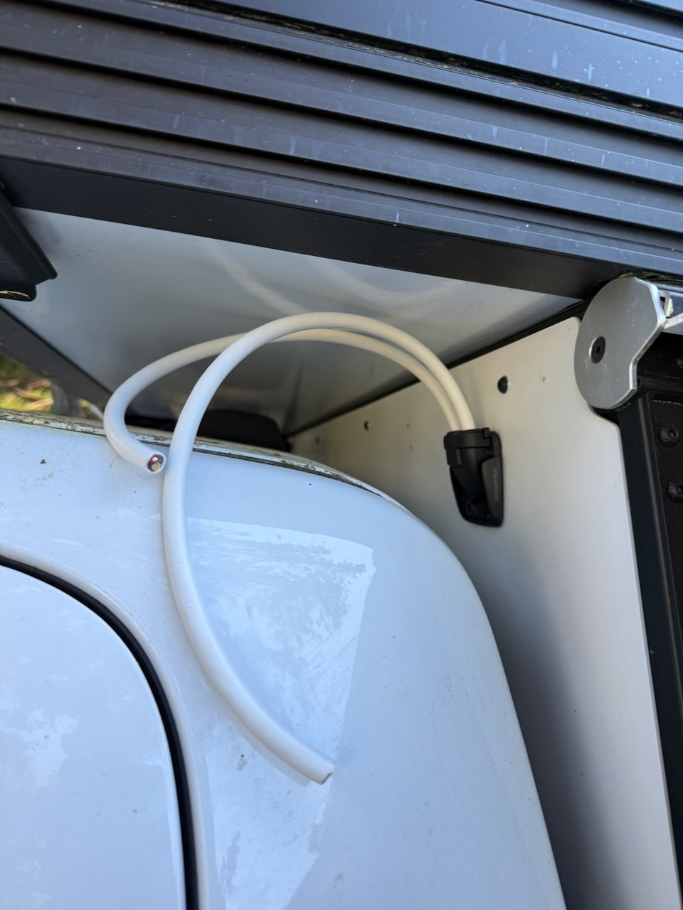

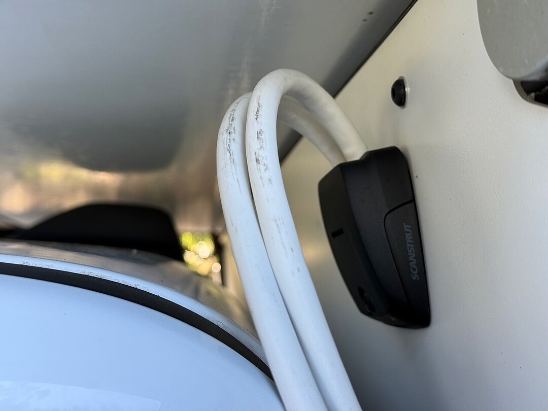

I prefer a clean install. Scanstrut 2 wire cable gland.

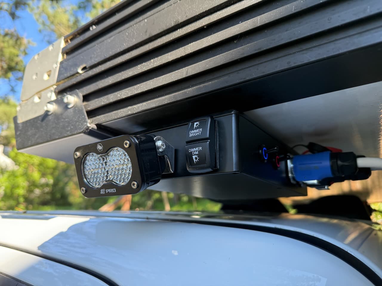

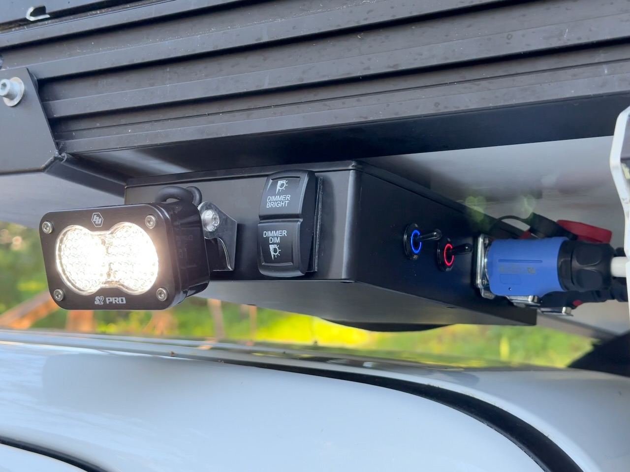

External power junction box with switched for scene light and Starlink.

:heart_eyes: Can you post a pic of inside where the power enters the wall of the GFC?

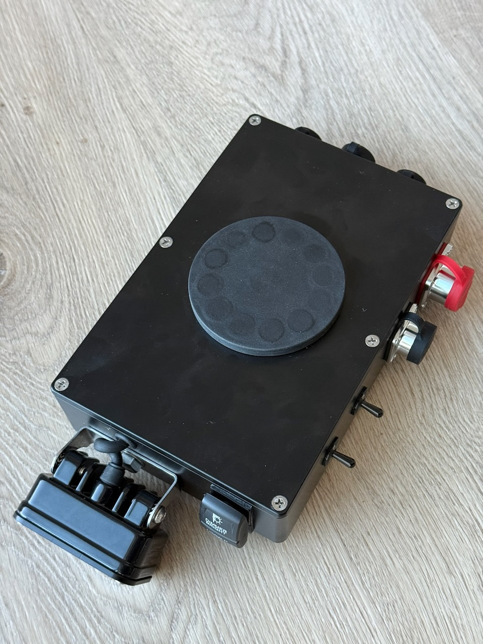

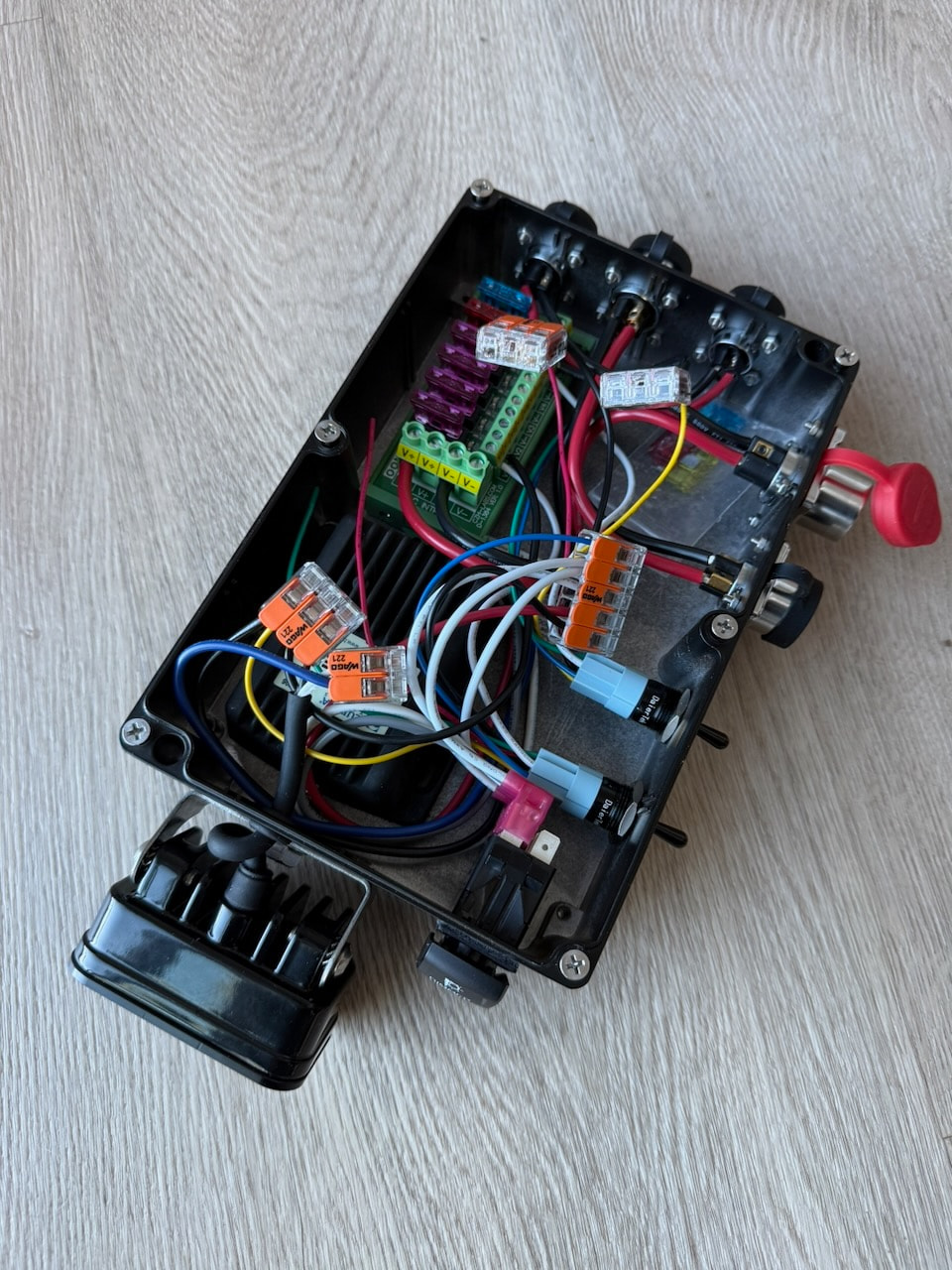

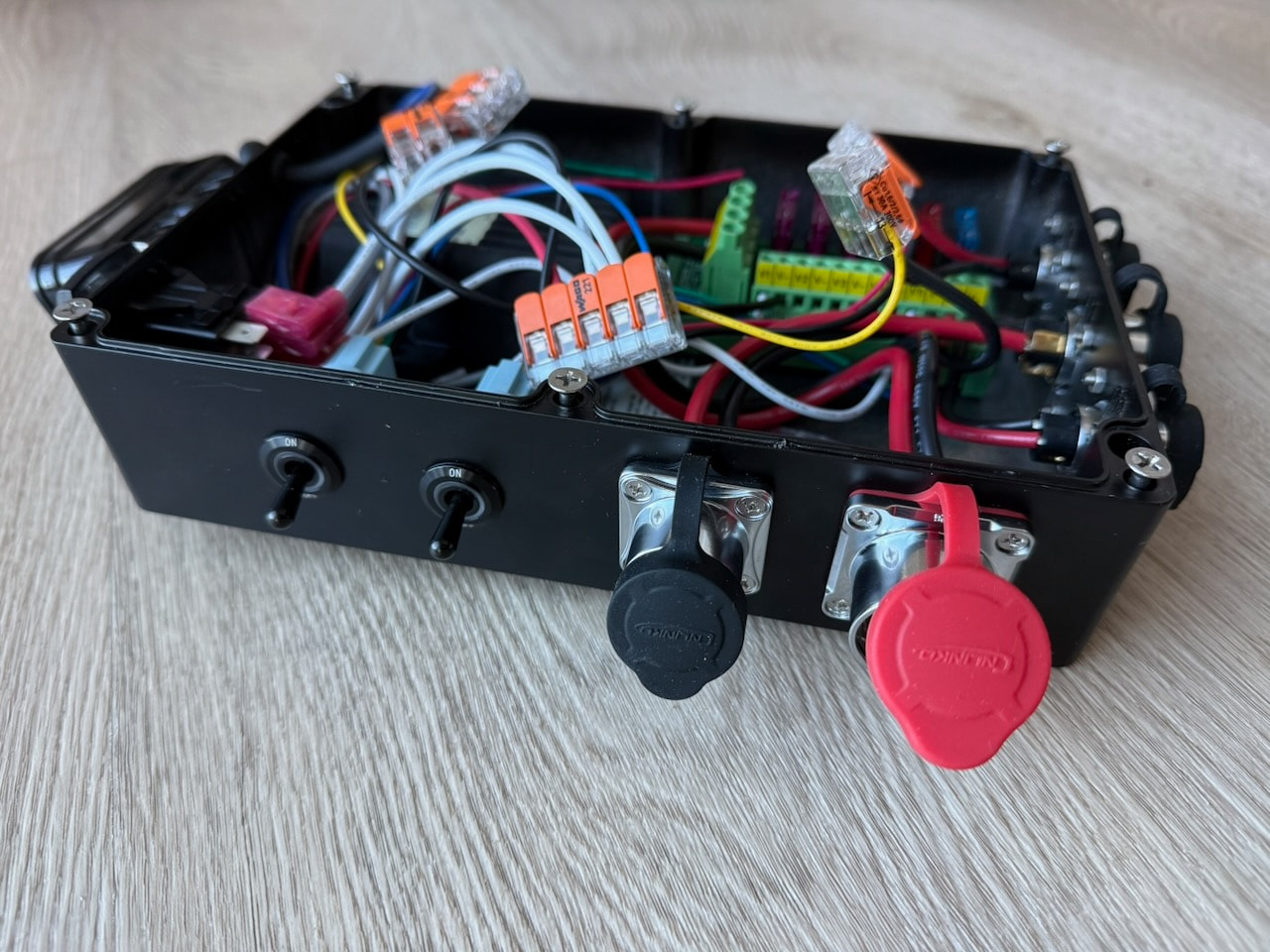

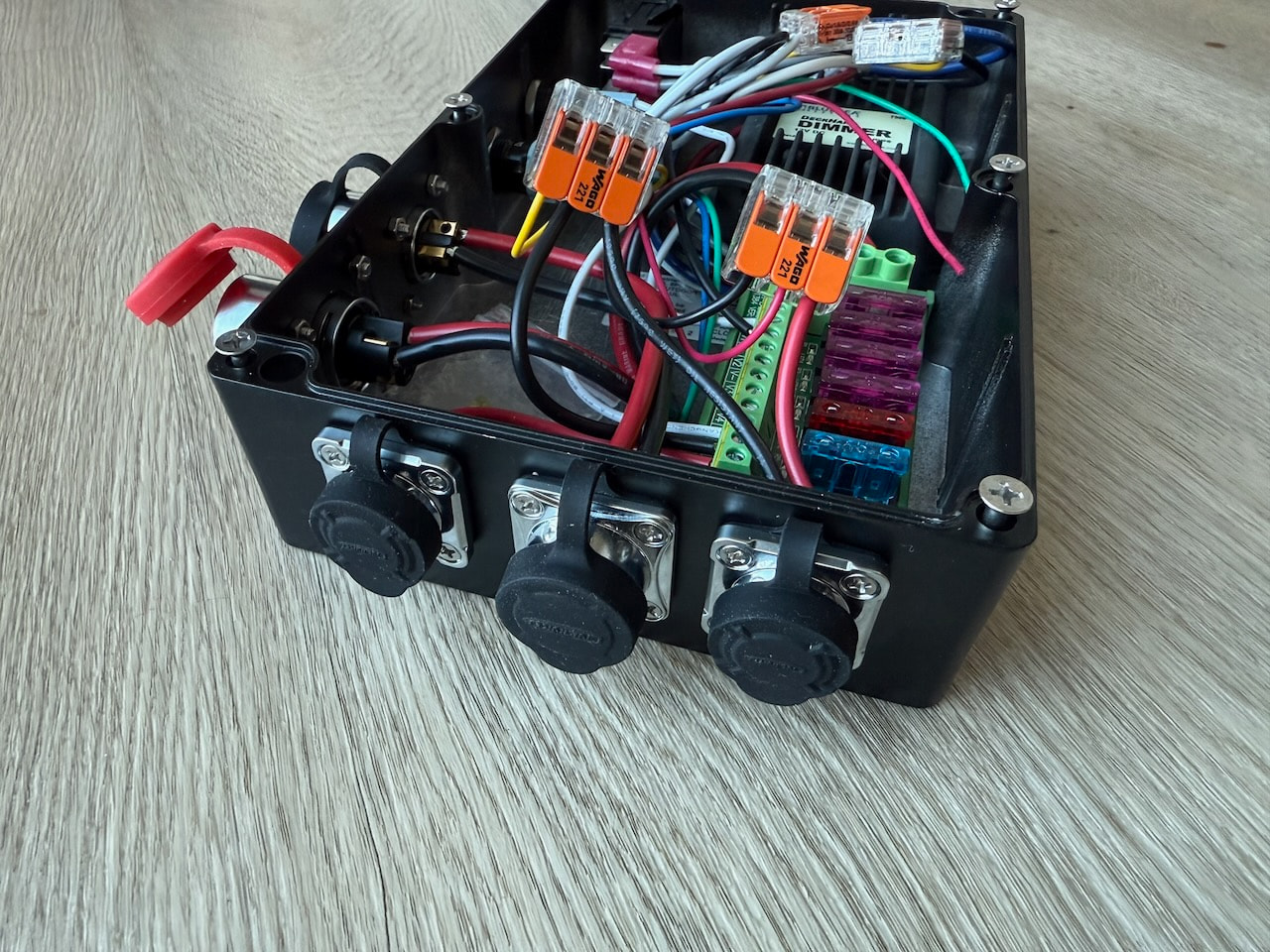

any chance you could give a bit more detailed write up on how you made this? Looks incredible
Here are some more detailed images for the build. Pretty happy with it, though the black enameled aluminum box I used is showing a surprising amount of corrosion after only one year- it’s cosmetic, but I plan to either repaint it or find a better box.
This is awesome and I’ll be putting something like this on mine!
