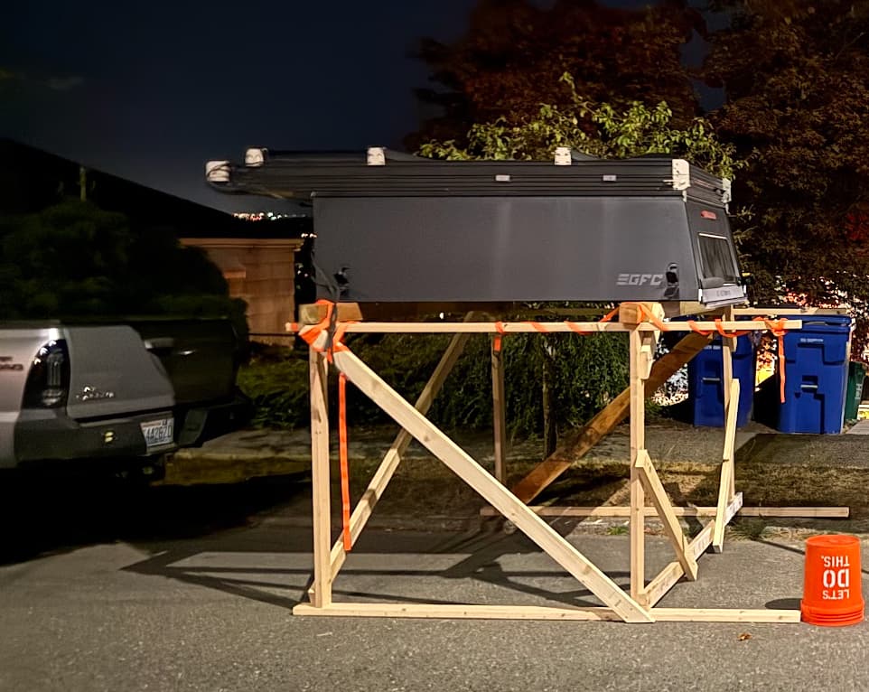

built frame around truck, lifted up onto frame, drove out - later back in and dropped back onto seal.
