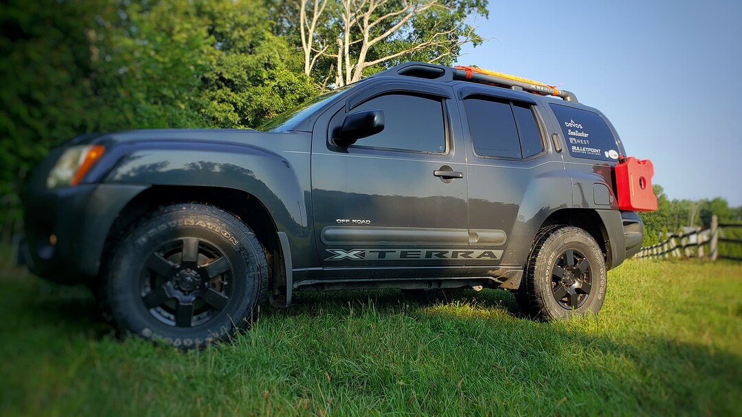

As Dan Hunneyman pointed out we like to keep our fuel/water outside our camper using the Sea Sucker RotopaX mounts. We have both the 5 gallon and 3 gallon models by SeaSucker – SeaSucker
Mark (& Teresa)
Hampstead Maryland
• Purpose Built Adventure Rig Ā© •
Ford Ranger FX4 - GFC Camper V2 # 1919
• Kia Soulverlander • Nissan Xterra Off-Road •
