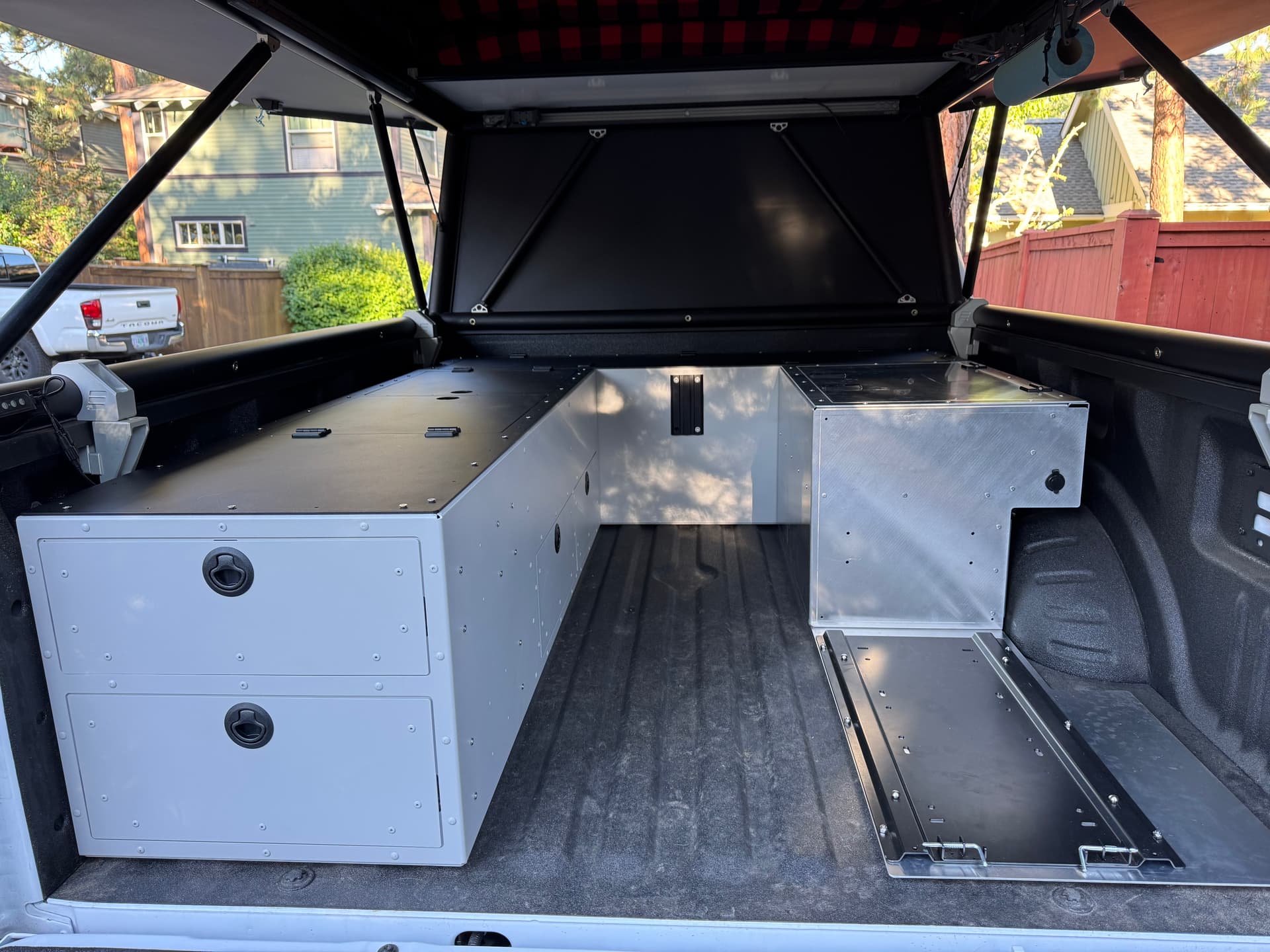

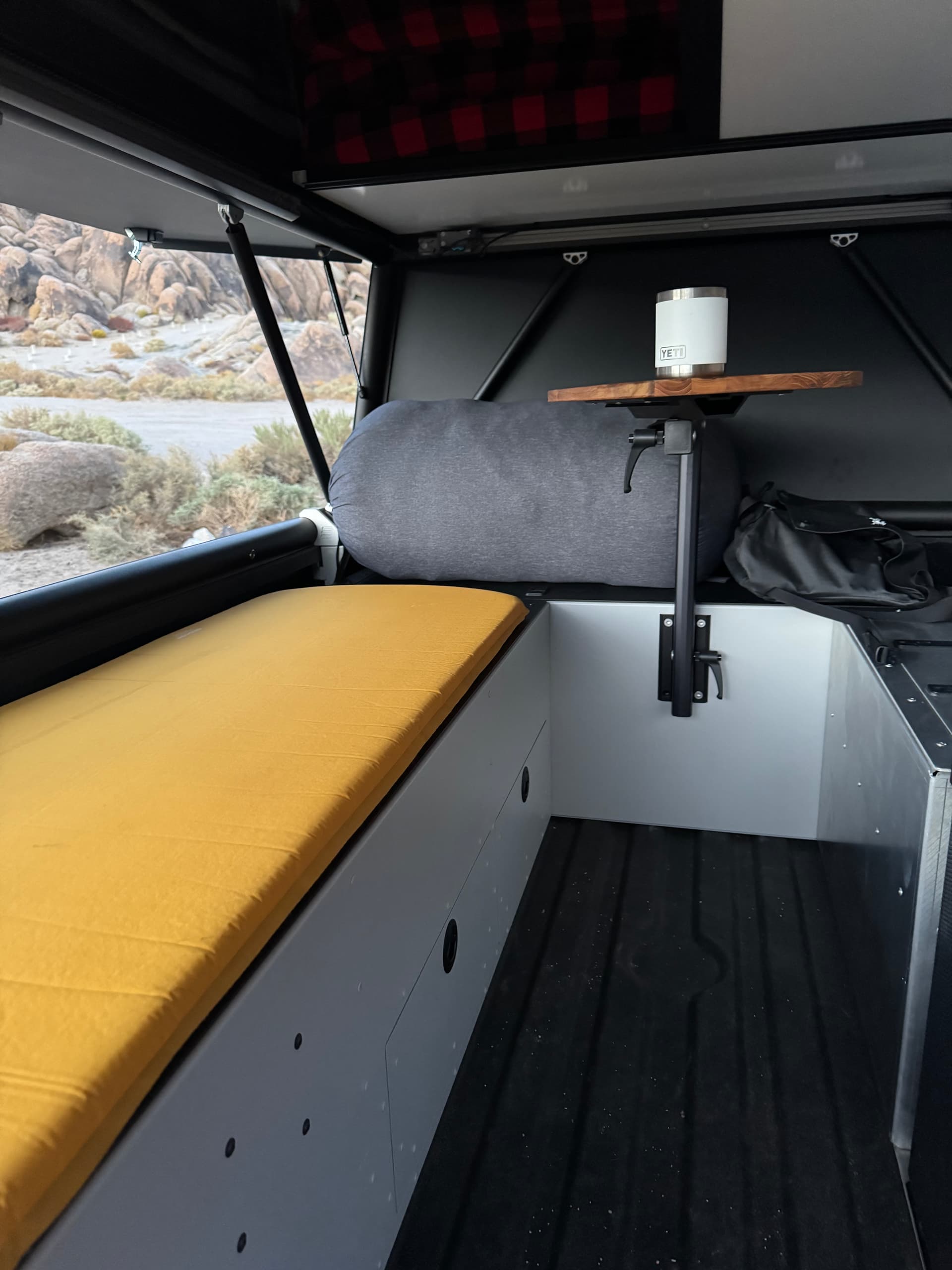

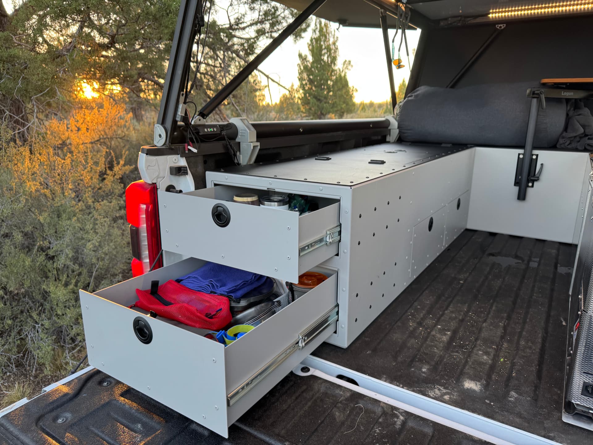

I am also working on a storage system for the back. We have run decked drawers in our last few vehicles and love their product though I think there is some opportunity to make it work better for our needs. I spent the last few months while waiting for the truck designing a drawer, fridge, water, battery system that will bolt in using factory threaded locations. Ford was generous with sharing their CAD data and I anticipate fitment will be near perfect. These drawers are being built with 0.100 aluminum, formed by a local sheet metal manufacturer that works on projects for the aerospace industry. I’ll get more CAD images uploaded once the design is final. I have a few things to check now that the truck and topper are here.

How cool is that. I mostly work on older vehicles where CAD is not available. Being able to get real OEM CAD would open up so many possibilities.
This looks like it will be an interesting build!
Yeah- it’s incredible and allows me to get 99% of fitment sorted before first prototype. Definitely saves some time and money!
Is there a link to find them? love it!

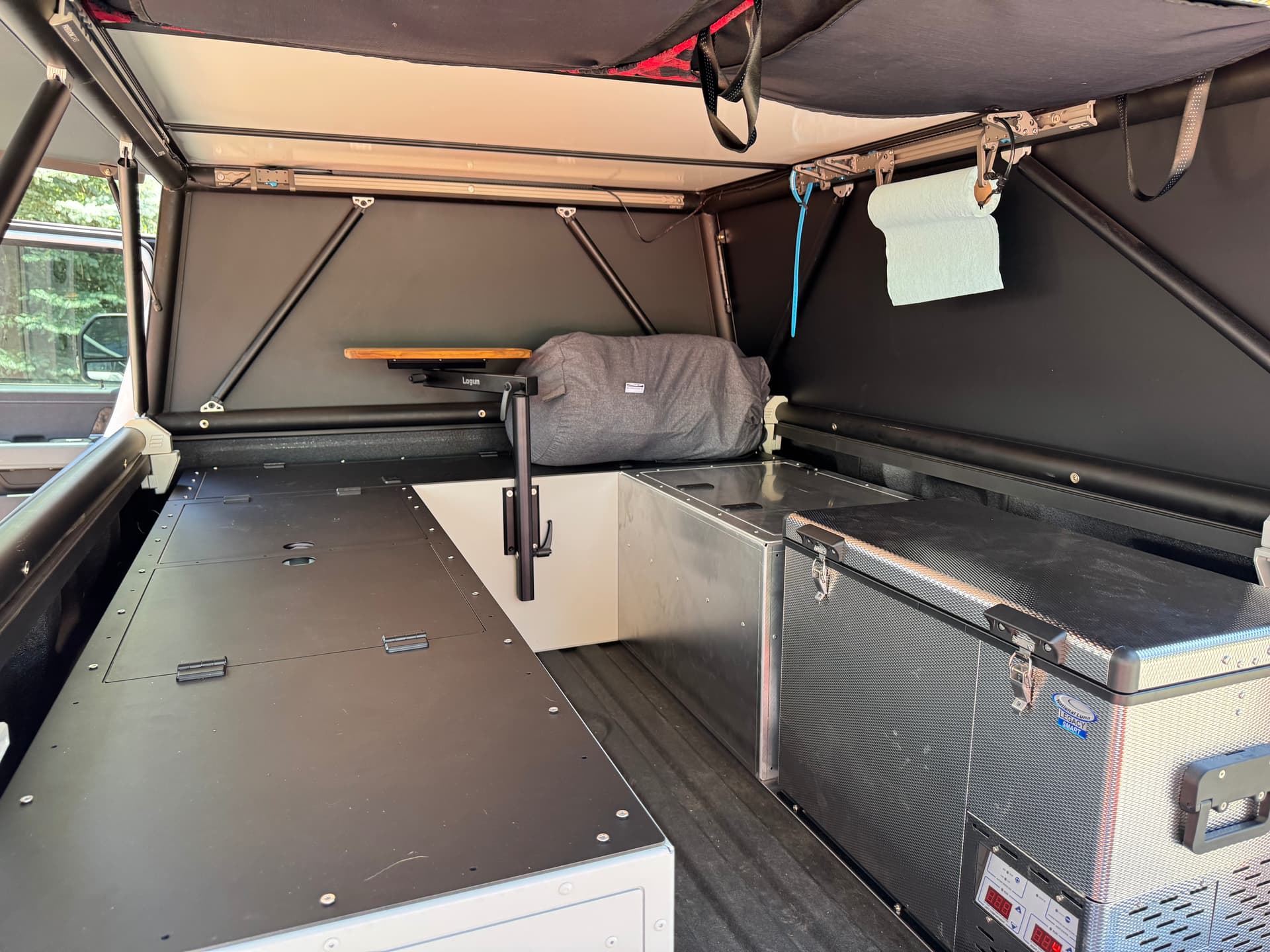

A few updates; I built out the interior and just got back from a two week trip thorough Colorado. The drawer system worked amazingly well, so much more convenient than what we have had in the past! That REDARC stuff is rad and kept the fridge/freezer running despite multiple days of 100+ degree temps.

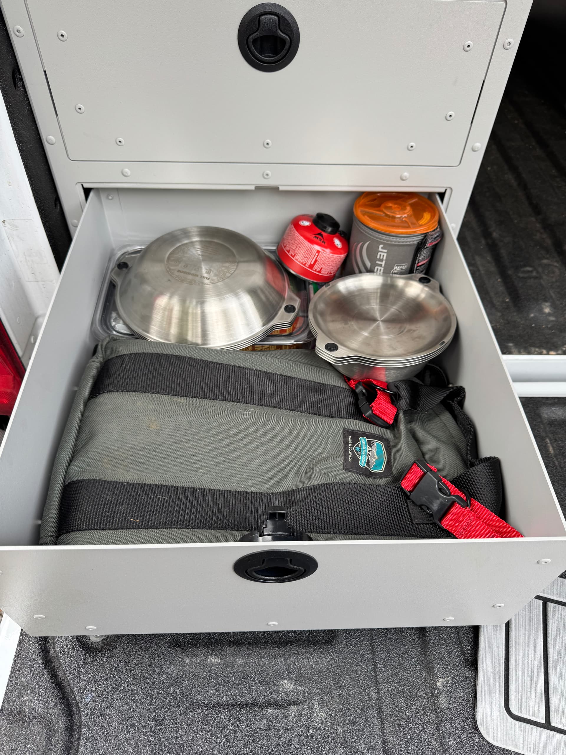

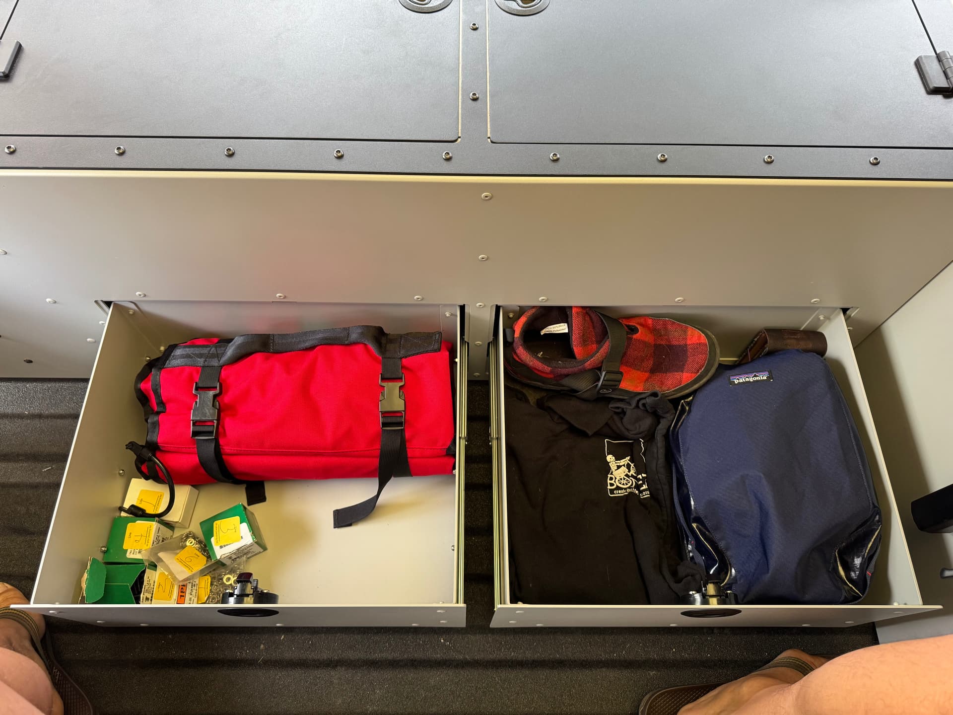

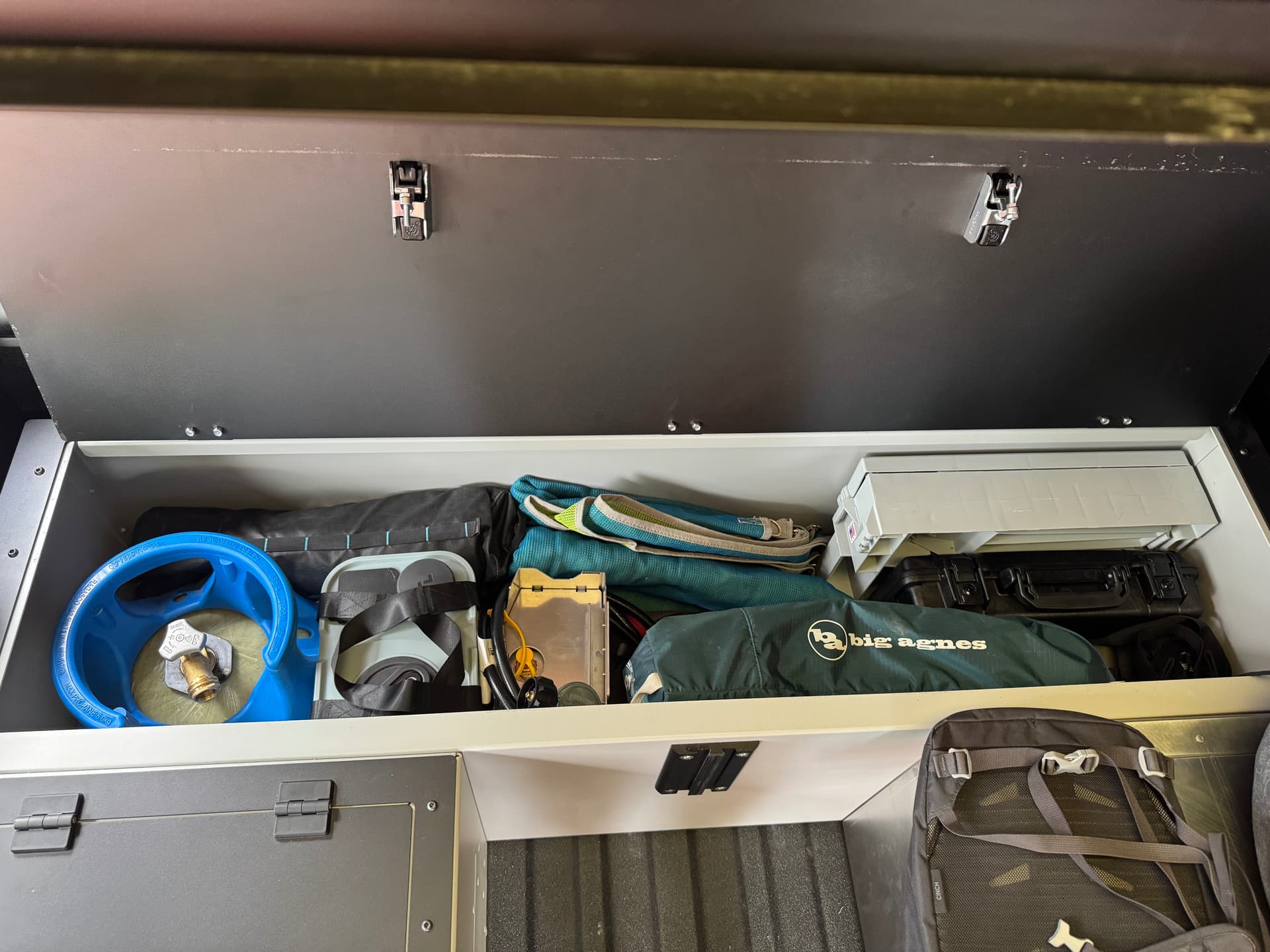

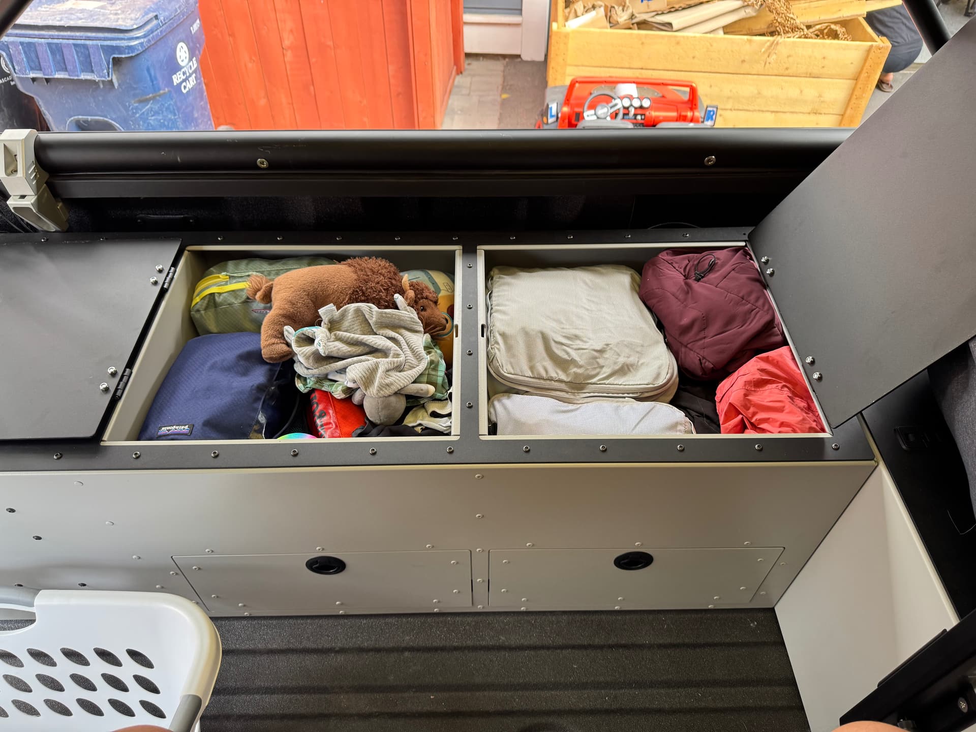

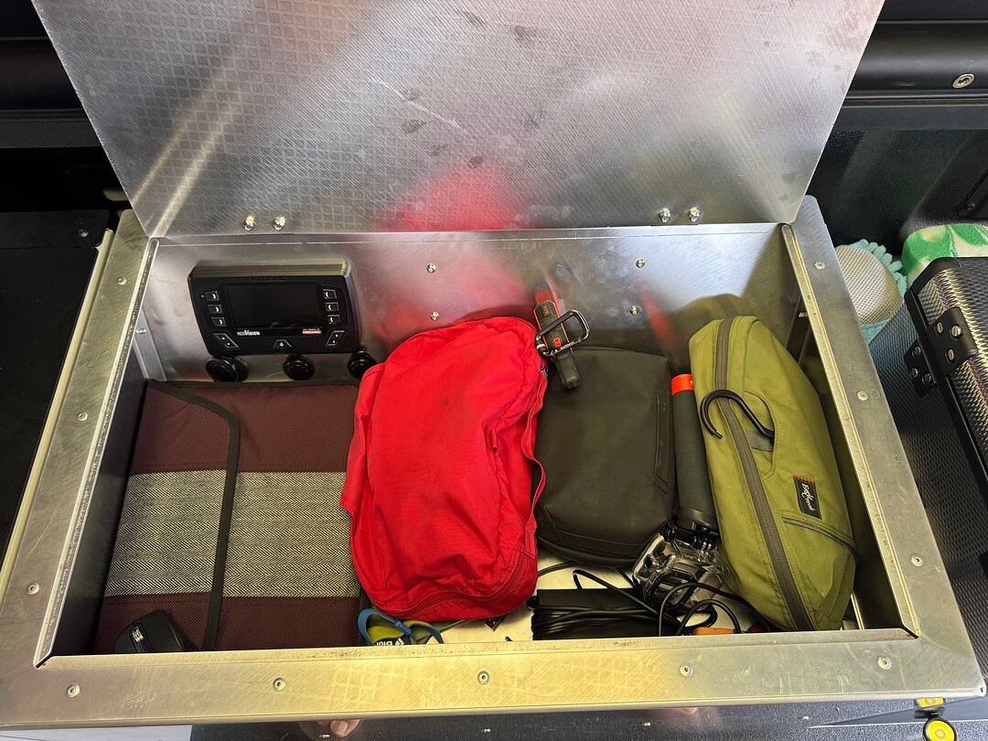

Interior: I think I mentioned this above but I really designed this for my family and what we do so not shockingly it met our needs really well. I didn’t have a great water storage solution and was kinda annoyed getting the Dometic go jugs from the front storage hatch when I wanted to just pull over a fill a water bottle or top off a water bottle before hike/bike/run. I also didn’t like some of the latches I picked for the larger hatches. The small round slam latches were the clear winner. Laser cut and CNC formed aluminum is definitely the way to go for something like this. It doesn’t care about getting wet. It doesn’t expand or contract. The rivets are rock solid and the tight tolerances make the hatches and drawers a pleasure to use. It also has gobs of space and doesn’t weigh a ton. We sat out a few really aggressive storms in the back and it was awesome to be able to hang out in there AND easily get all our stuff. The REDARC BCDC, Alpha 150ah battery and switching unit performed flawlessly. Seriously it ran all summer without doing anything on my end. The battery rarely dipped below 75% and I never needed to hook up my solar. That is will charging a slew of apple devices for 3 people, running, the fridge, lights, and charging my Anker brick that powers the starlink (rarely used). I don’t use induction or an inverter, so take all this with a grain of salt if you have higher demands.
I am currently designing a version that goes down just one side and then puts the fridge in the front. Kindof An “I” shape that converts to an “L.” I found myself a few times wishing that I didn’t have as much furniture in the back of the truck during day to day truck/hauling activities. I think this is fairly purpose built for recreation and folks who do longer or very frequent trips (or who can afford a standalone adventure vehicle). Now, I want one that keeps all the same functionality (storage, batteries, water), a bit scaled down, but leaves bout 60% of the bed wide open. Currently working on that in CAD. I can see running that one as an everyday solution and then using the full setup for our bigger trips where we are really living out of the truck. Maybe just leave it in all summer?

One of the cleanest, best-executed build-outs I’ve seen in a while. Did you do the laser cutting and CNC forming yourself, or did you use a resource like SendCutSend?
I used OSHCUT for the big parts because send cut send limits part size. I have a local mfg that built kinda the first prototype for me. They are fantastic but basically doing me a favor and trying to fit my one-offs in between bigger jobs so I lean on SCS and Oshcut for virtually all prototyping work where able then have the local guy build things in multiples. They do outstanding work. CLSFab.com
