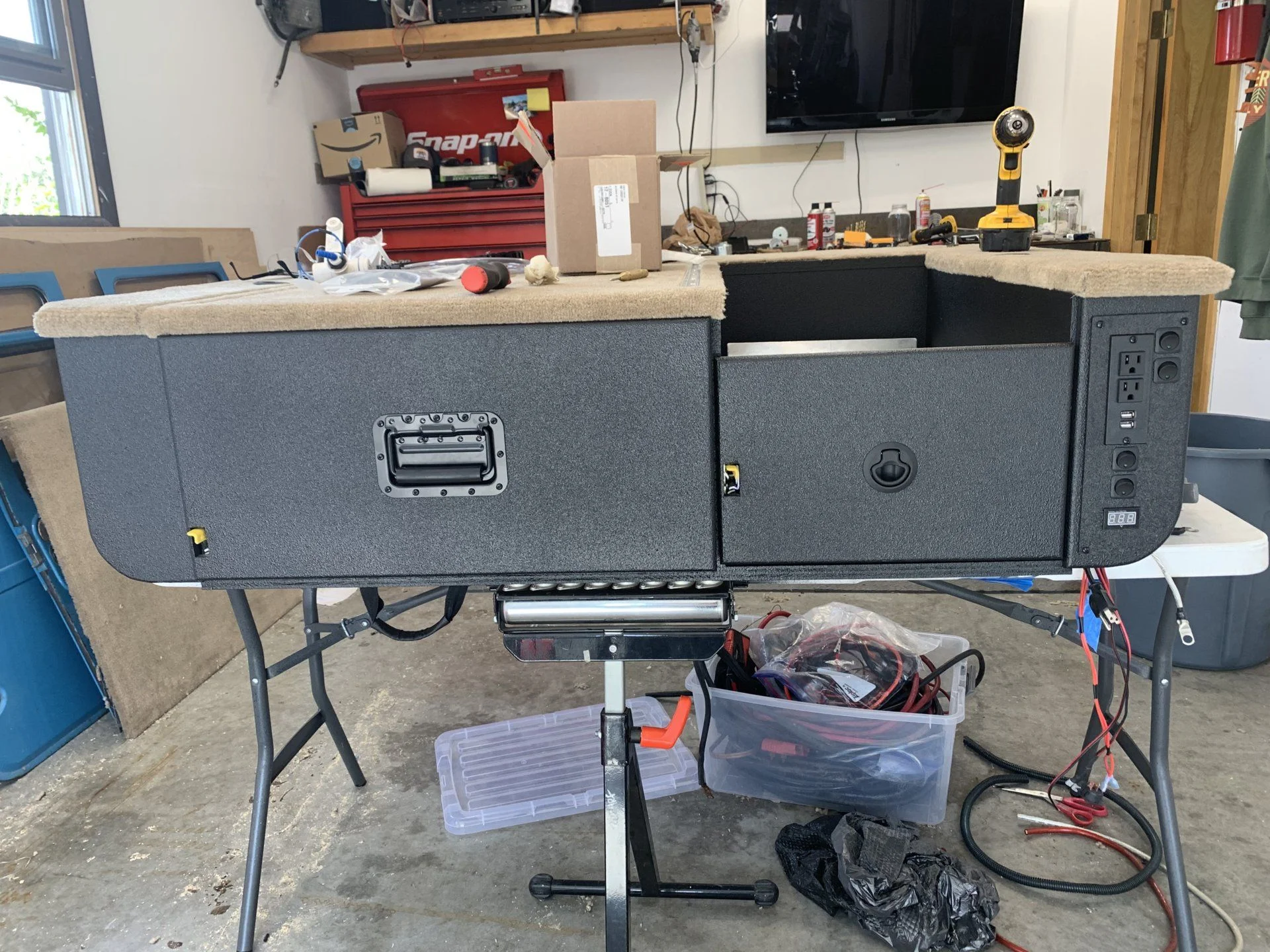

I would use a professionally applied bedliner over 1/2” or thicker Baltic birch plywood. Do it after making all the holes, if you plan to add slides or other fixed storage. It will be waterproof and easy to retouch if it gets damaged, which is unlikely if done correctly. The aerosol bed liners are not good.

Have you thought about a Decked system with a scrap of carpet thrown on top? That would be my approach.
