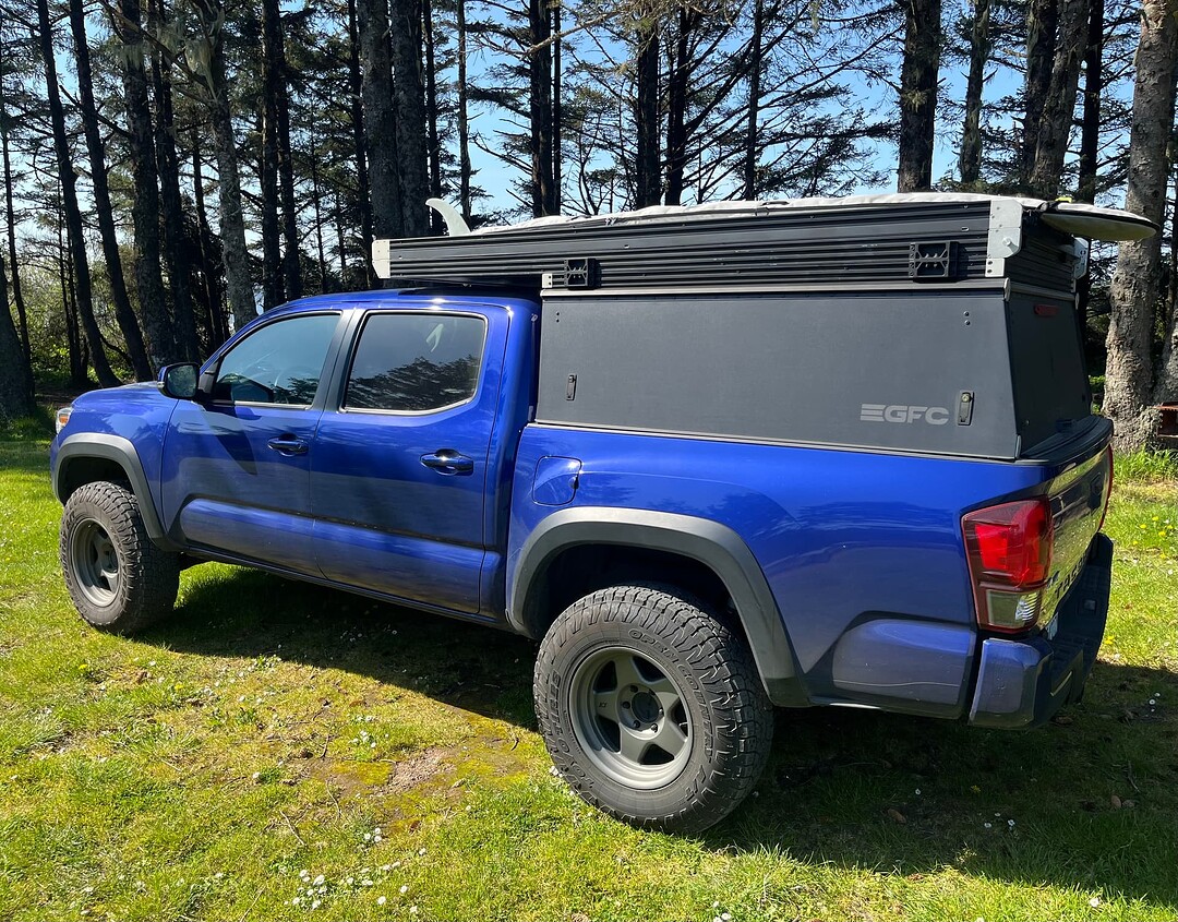

I cut the sharkfin down by about an inch. I forget what the height was, other than it being almost exactly 2" lower than a regular GFC Platform Camper.

A few months in and absolutely loving this setup. I ended up painting the hardware black to make it a little less obvious that the tent is removable. Every time I see a standard camper, I notice the larger gap between the tent and the cab. All told, with a 2.5" lift and 33" tires, i measure 6’7" clear from flat ground to the top of the tent. Super handy for parking garages at work that are around 7’ marked clearance.

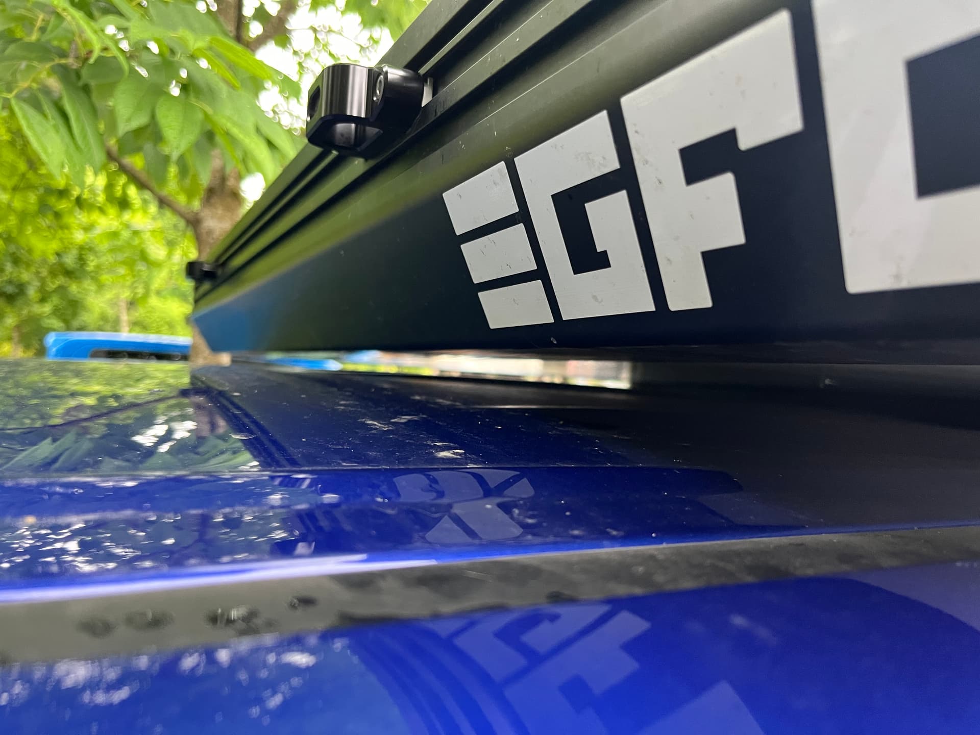

Awesome! How much clearance do you have over the roof? I am considering this setup for a 1 gen tacoma.
It’s about an inch of clearance above my roof. Still loving this setup. If you’re thinking about this for a 1st Gen, I’d definitely confirm that it will fit as it won’t be the same clearance as a 3rd gen. I’d run a hard straight edge off the topper above your cab to make sure. It’ll be tightest over the center of the cab so that’s where I’d be sure to measure.
Oh nice, that is really tight. Have you had any problems when the vehicle flexes?
none. I feel like if there is any flex, it would be deflecting side to side, so it kind of follows the curve of the roofline. I have not taken it off any sweet jumps though.

It’s snug, but I can’t see it ever hitting the cab. I don’t do anything crazy with this truck, mostly fire roads and beach stuff.
