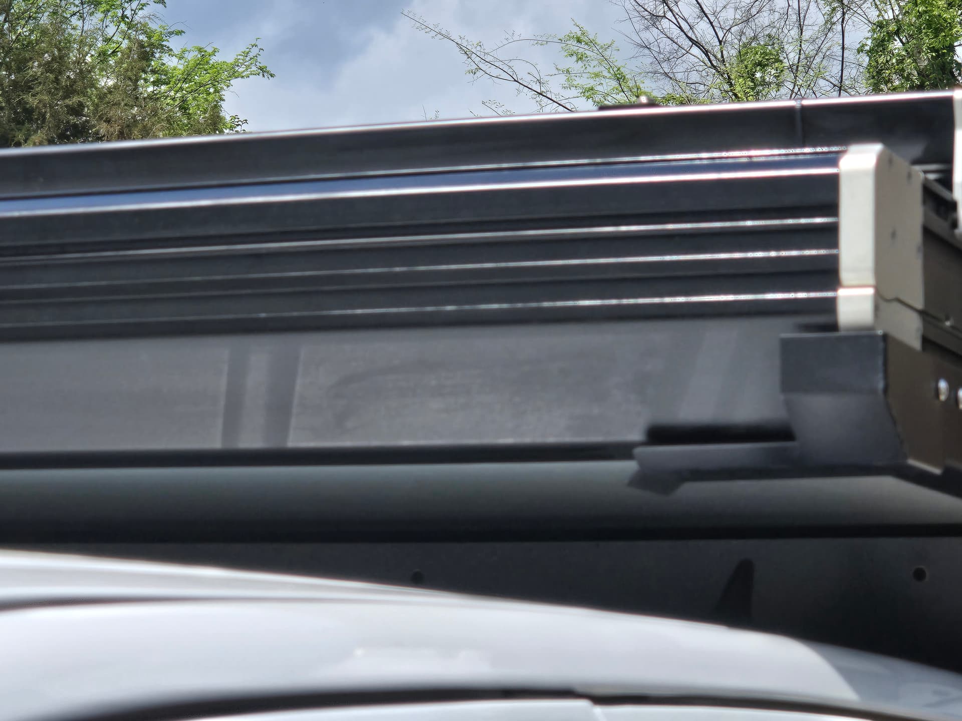

I decided it was time to reseal the anodizing on leading of the GFC. And yes in Oct '23 I use EverBrite. I was not sure at that time how I would like it but as you will see it worked very well and you can see the results in the after pictures.

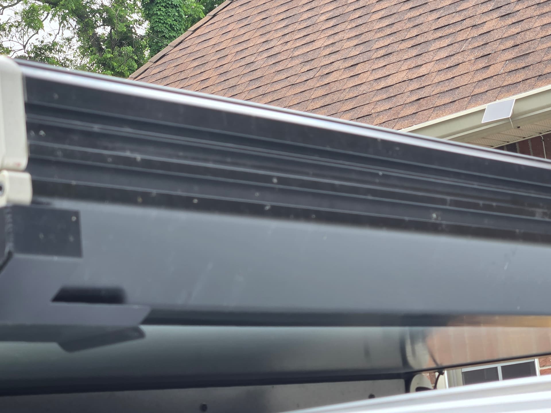

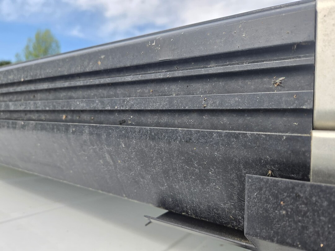

Before

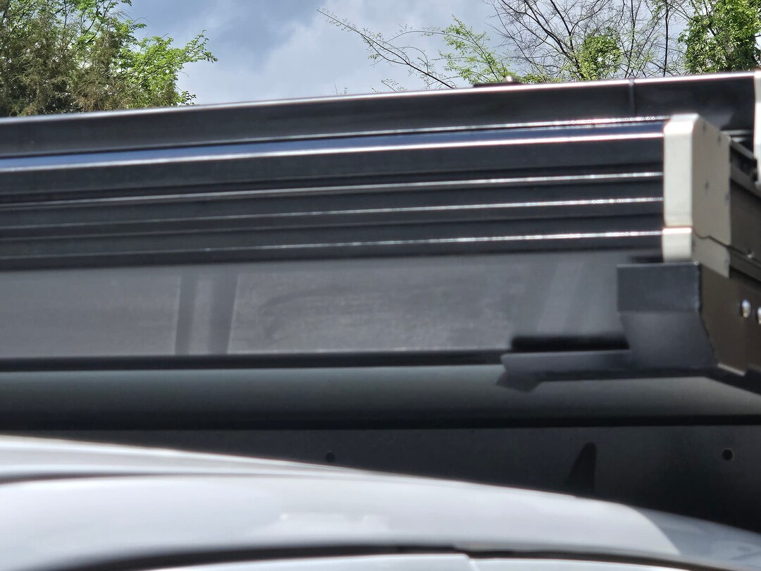

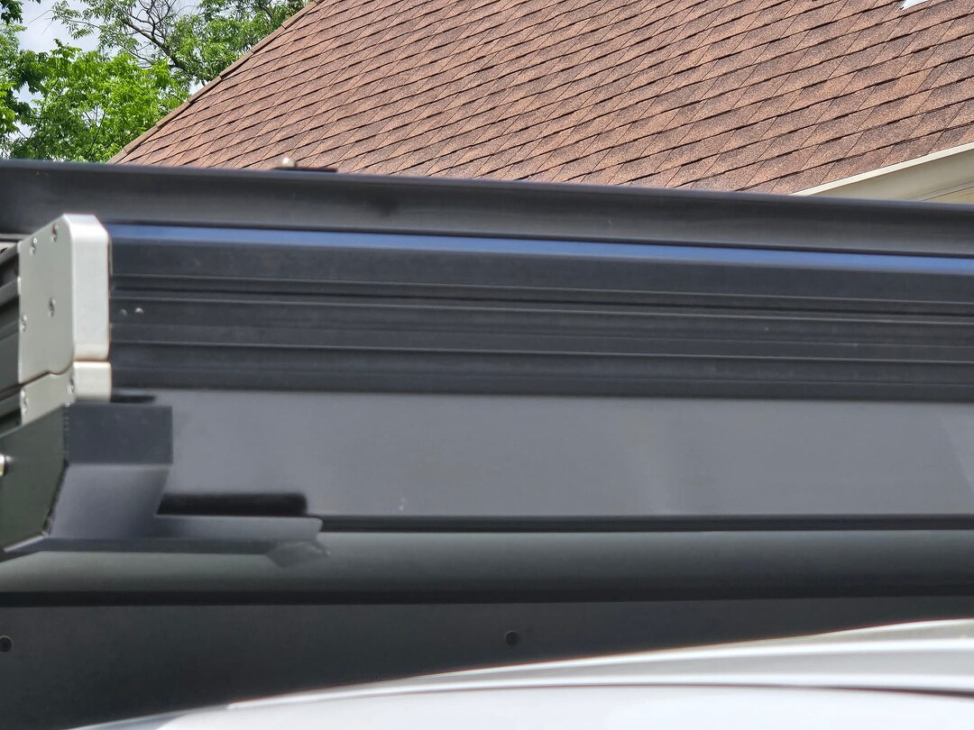

After
Left front. Note: You can see the reflection from the roof of the truck on the black.
Right Front.

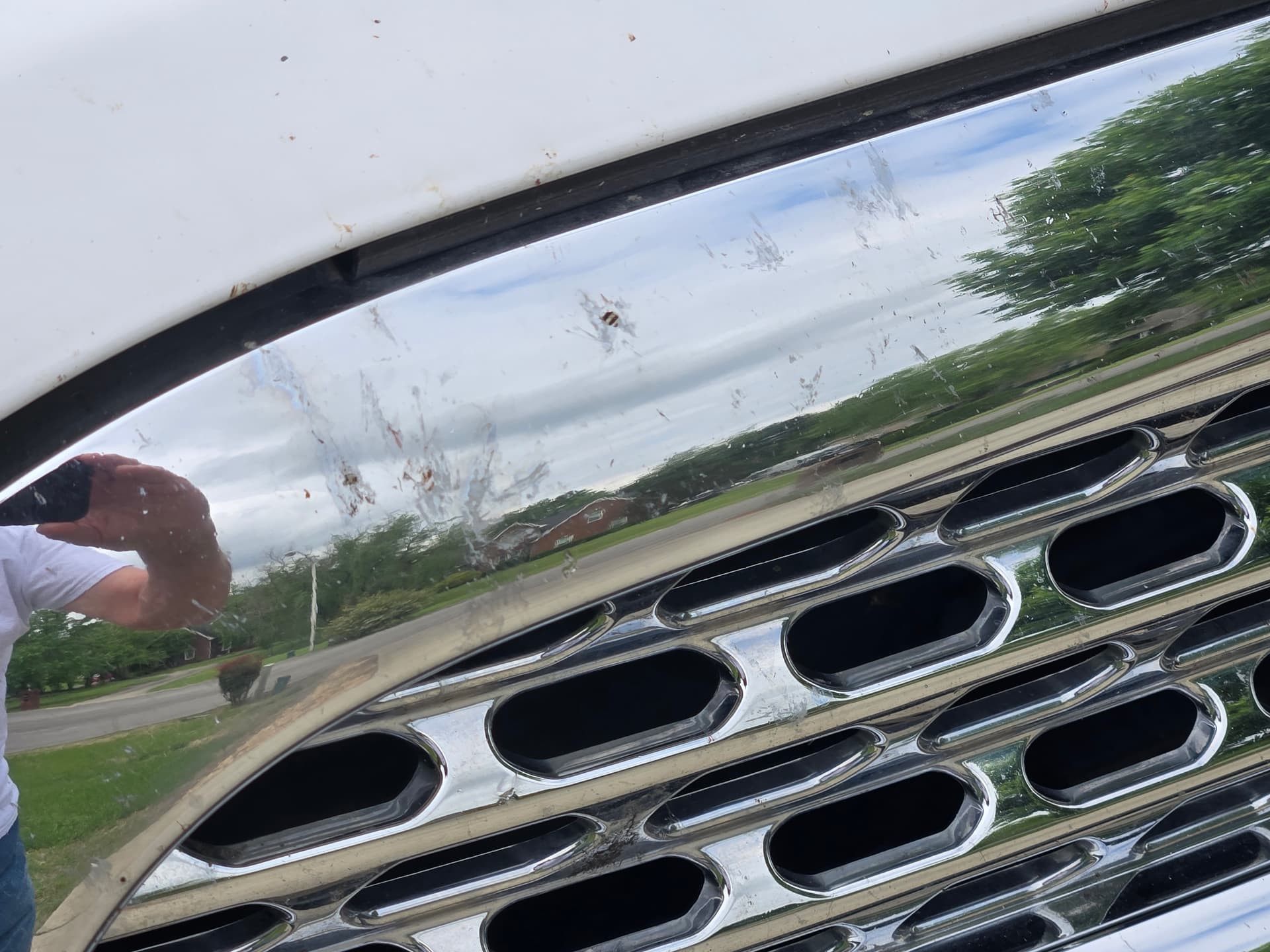

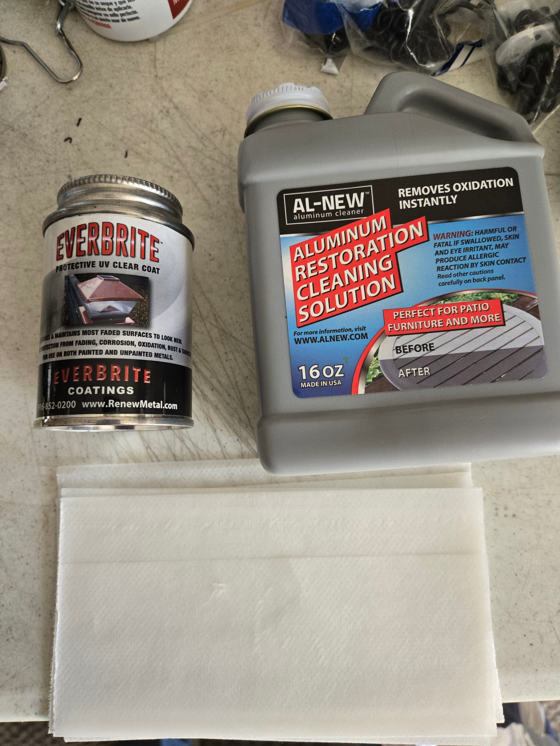

  1. Use a couple cheep dryer sheets and a small bucket of water to remove the bugs.
    The dryer sheets even works on the front grill and hood of your car. Just make sure to wash all the softern off after using them.
  2. Use Al-New Aluminum Restoration Cleaning Solution.
    Follow instructions on the bottle.
Before going to step 3 I let step 2 dry overnight.
  1. Use EverBrite to seal the Anodizing.
    Note: Use EverBrite in the shade or on a cloudy day!
    Follow instructions on the bottle. If you notice I have a small can because it doesn’t take much.
I also only use Al-New on the sides and back.
I haven’t seen a reason to put EverBrite on the sides.
