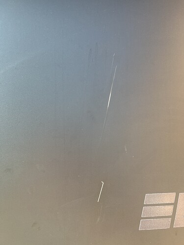

Does anyone recommend a decent way to fix a gouge on a panel? While installing the awning, it slipped and left a decent size gouge in the panel.
Not a lot you can do outside of re-powdercoat the panel unfortunately. Sometimes a sharpie can hide it a little bit.
i’d do something more than sharpie like auto paint touch up pen. once the seal is broken corrosion will get under the powdercoat.

I would turn it into a lightning bolt! :zap: Put one on the other side too, and it would look meant to be.

Leitner Designs has a powder coat touch up spray on their website. Not sure the exact consistency, but when I had their rack it seemed similar to the panel finish. I’d test it on something before spraying the panel, but I think it’d be a decent fix for a low price.
It’s made my Cardinal, who offers multiple different powder coat spray paints. Here is the color chart. Maybe @Thayne can chime in with which one would be closest. Would be good information for everyone to have.

Clean the burrs off of it. Time for a wrap!
My V2 GFC looks like BK01 (very common black powder coat) and from my GFC order I saw Panel Color: Black (C241-BK01)
FYI, there are spray paints to match specific powdercoats and also paint pens. I am not recommending the attached paint because I’ve never used it, but it’s pretty easy to find, your local powder coat shop may even have it. I don’t know how to fix a gouge but having the exact color match paint can’t hurt :wink:
Hey @GFCTundra - Sorry to hear about the gouge! The paint that @Vice_Chief shared above is what we would also suggest for touch-up, but If you do have a local shop that offers powder, it might worth stopping in to get hands-on with a professional before you snag some.
Awesome! Thanks everyone. Although the lighting bolt would look super cool, I might try to paint first. FYI, for anyone looking for touch up, the LVP site offers the C241-BK01 in a pen as well as spray. Going to try the pen first to see how that works and will report back.
