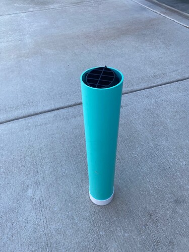

:joy: I had to do the same thing to my hose when I had my canopy. The hose scuffed the paint. I like the dryer vent move, that would hold the hose in more securely when you’re piping to the top.
I wanted to mount mine on a tire step but couldn’t find any to fit a 13.5ā€ wide tire.
Also looking at some type of sleeve for my heat duct. I was thinking about cutting up some kid size cotton pants or something :joy:. Just need a small section so it doesn’t rub the paint.
Nice setup! I plan on doing somthing very similar with mine. Hadn’t considered paint scuffing from the hose…

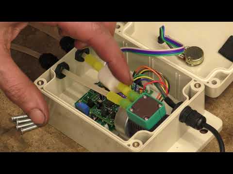

Took the plunge and ordered an diaphragm-style Silent Pump designed by James Brown Smith in the UK. They’re hand made by him, and should resolve my issue with the noise & vibration produced from the dosing pump.
I’ll report back with results in 20 days or so (lead time is 10 days & 7 days for shipping from the UK)

Further details and pics attached:
Just three wires to connect. Blue-Neg to same as the burner, and Green and Yellow wires connect to your pump wires any way around. (Some systems may require a fourth +12v wire)
There is no standby power draw.
Works with 12v and 24v burners.
Can be mounted in any orientation.
Fully compatible with the Afterburner controller.
The dial on the top is for fine tuning (or quick altitude adj) as every bodies installations are slightly different. I will mark the dial position with a white arrow for a 5Kw burner for example running on diesel to give optimum heat and lowest carbon monoxide throughout. If for example you want to burn a different fuel then the dial can be used to increase or decrease injection quantity per pulse as well as the normal adjustments of fan speed and Hz in the burner controls. I can also set up for any size burner that uses a clicking pump, so just let me know.
Unlike the standard pump, this pump can pump any fuel without increased wear from non lubricated fuels like Kerosene. This pump can happily pump Diesel, Kerosene, Petrol, Paraffin, Jet fuel, without increased wear to internal parts.:slight_smile:
