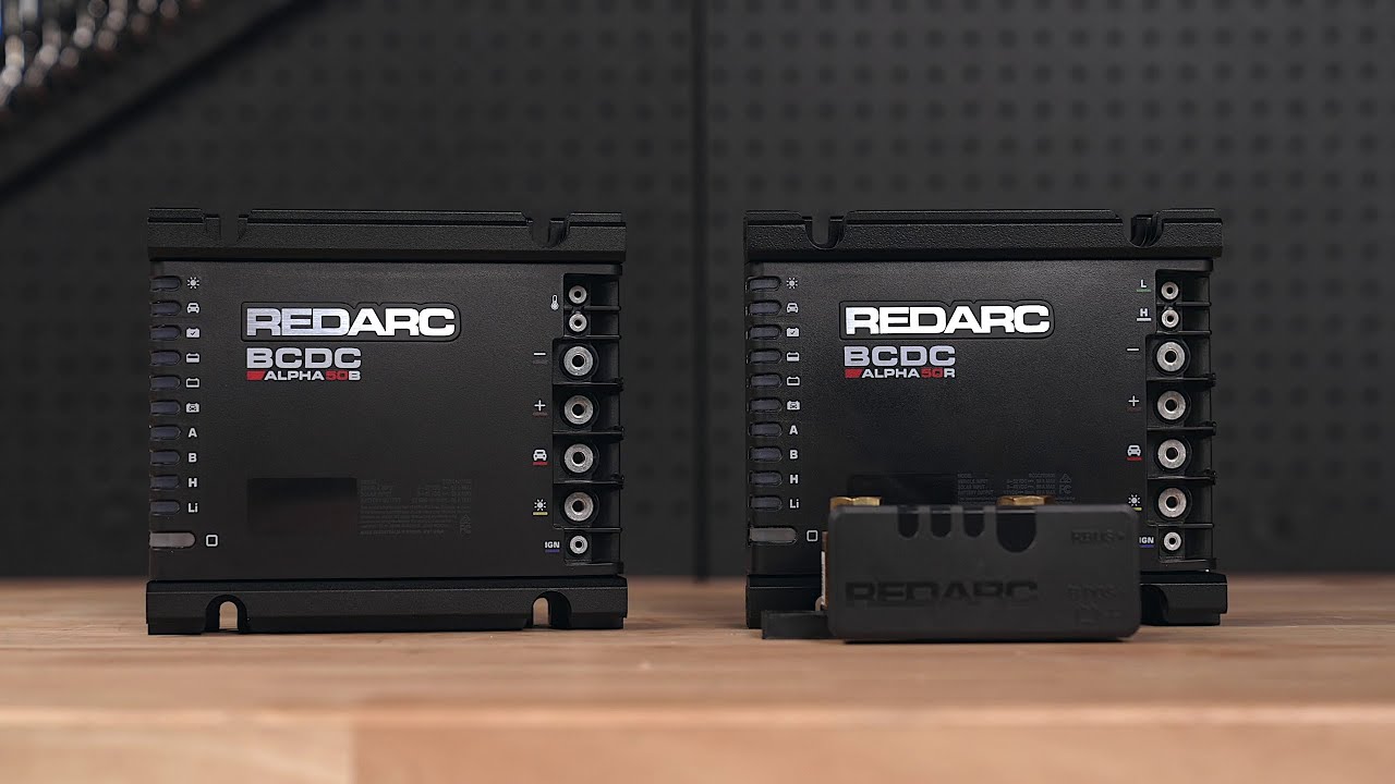

This video was helpful. The BCDC “classic” is sealed, which I want. So is the BCDC Alpha. Alpha may be the answer for me since it’s smaller, has nice terminals, and is roughly the same price.
Anyone here have experience with an Alpha?
