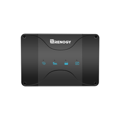

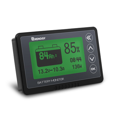

Since you’re already going down the Renogy brand, why not use their MPPT DC Charger? It’s a great unit, if you don’t want to use an app just get a shunt with a display.
I’ve been running my renogy system for years in different variations. I’m currently using the 30A MPPT Charger and it works great! Charges off the alternator, uses solar and it’s affordable.

I see he’s using the Renogy charger.
i use Renogy because it was the only one available in stock ready to ship at the time.
Redarc would be my first choice when looking for DC-DC with MPPT but it was out of stock at the time and estimated delivery date was way too late… well beyond my departure date for the Big North Trip last year.
If both were available ready to ship, I’d go with Redarc. Unfortunately Victron doesn’t have an option for DC-DC with MPPT in one unit, at least not at the time when I was putting everything together.
