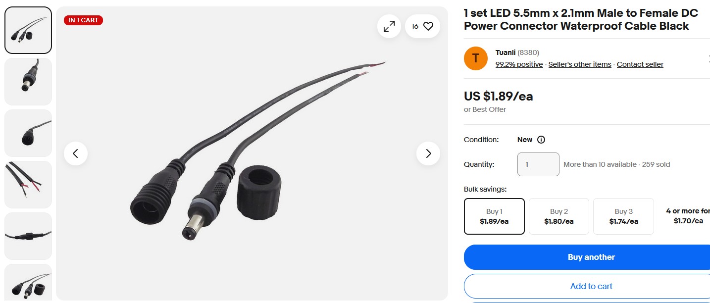

For my build I bought a 5521 adapter through ebay, see photo. This is the only place I could find the waterproof 5521 connector that GFC uses. You could also use any generic 5.5x2.1 connector but it would not be sealed or have the threaded collar to retain it. If you want plug and play, the cigarette lighter adapter cord that comes with the GFC is your best bet.

Waterproof 5521
