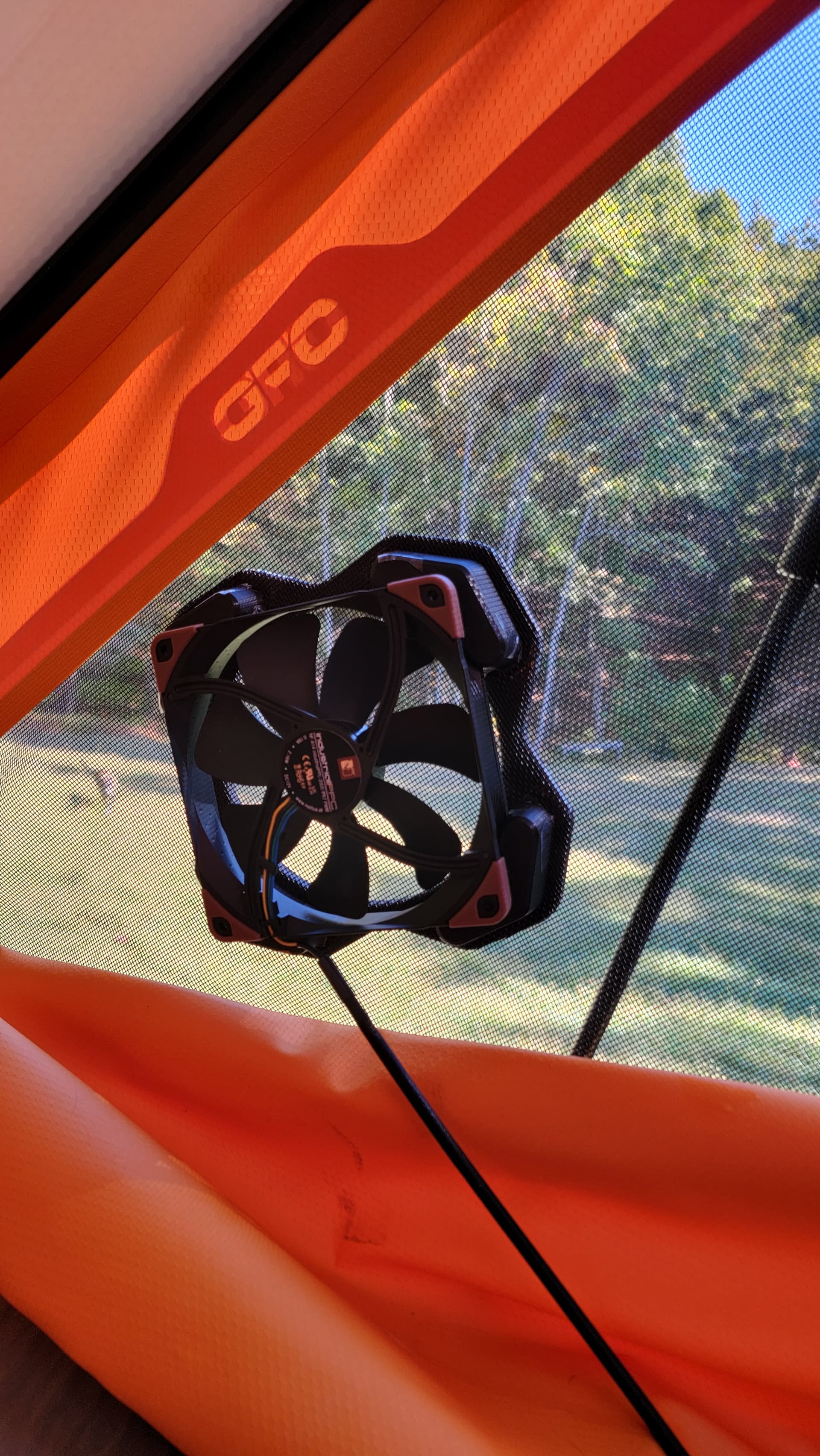

I’m alittle late to the conversation, but I was also struggling to find a good portable fan. I ended up designing my own that magnetizes any of the fabric surfaces. Right now I have it charged by a battery pack that we have up there already to charge our phones. We used this one but I’m working on updates.
How does that stick to the mesh?
This is really cool.
She said magnetizes, so I assume magnets on one side and ferrous plate or additional magnets on the other side of the mesh, clamping into place. Frames likely 3D printed. Pretty cool idea.
That’s what I figured but am hoping to get some details because that looks like a great idea.

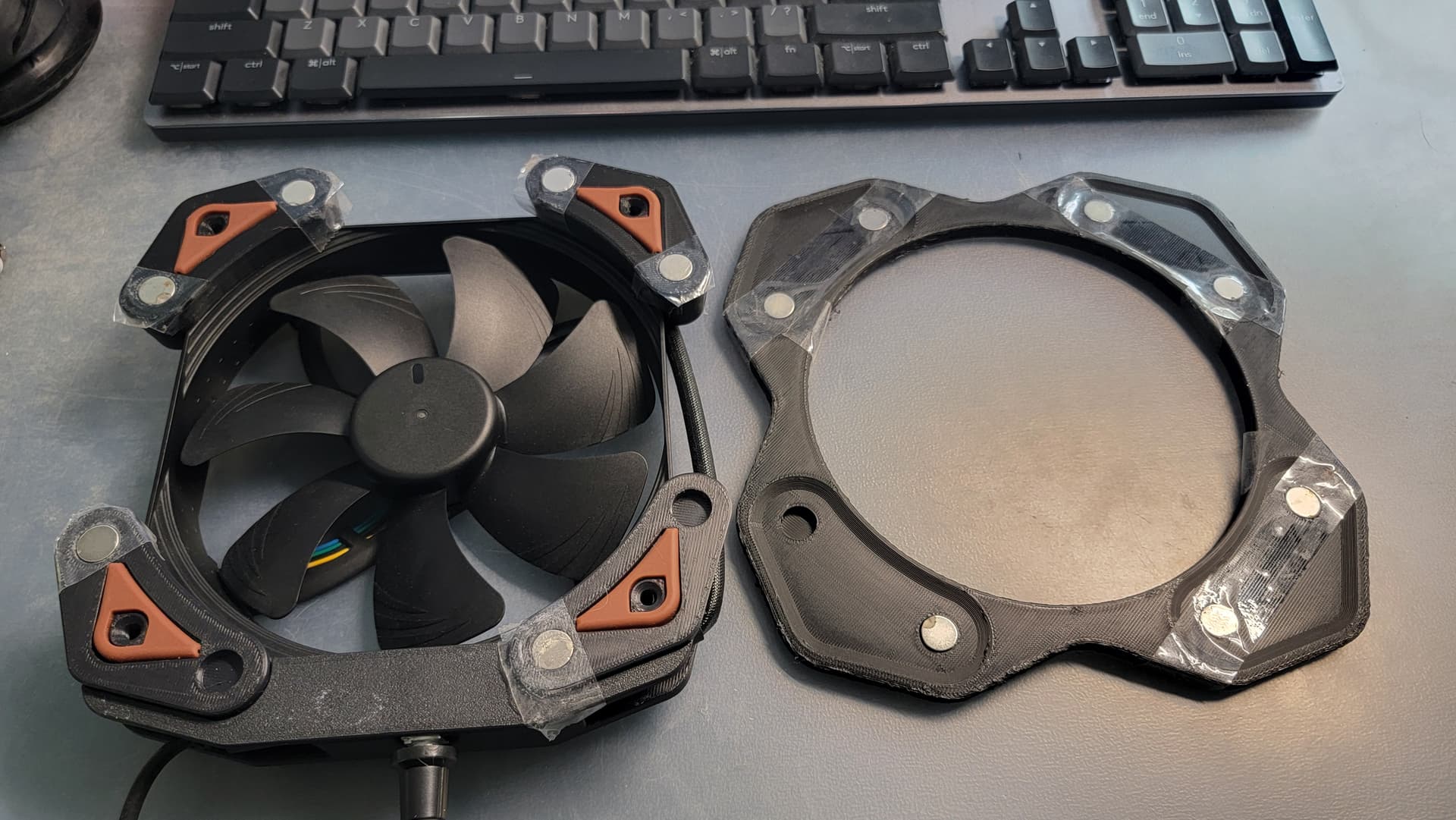

Thanks, it’s been a fun project! It has magnets on both sides, and the frame is printed with ASA. I had considered using a steel sheet metal plate for the final iteration, or if I start selling them. I had the magnets from a different project. I got the second iteration mostly assembled, and here’s a picture. When I’m happy with design, I’m planning on printing the magnets in place. I added a speed controller to it as well, steps up the 5V USB C to 12v PWM which is what the fan runs on.

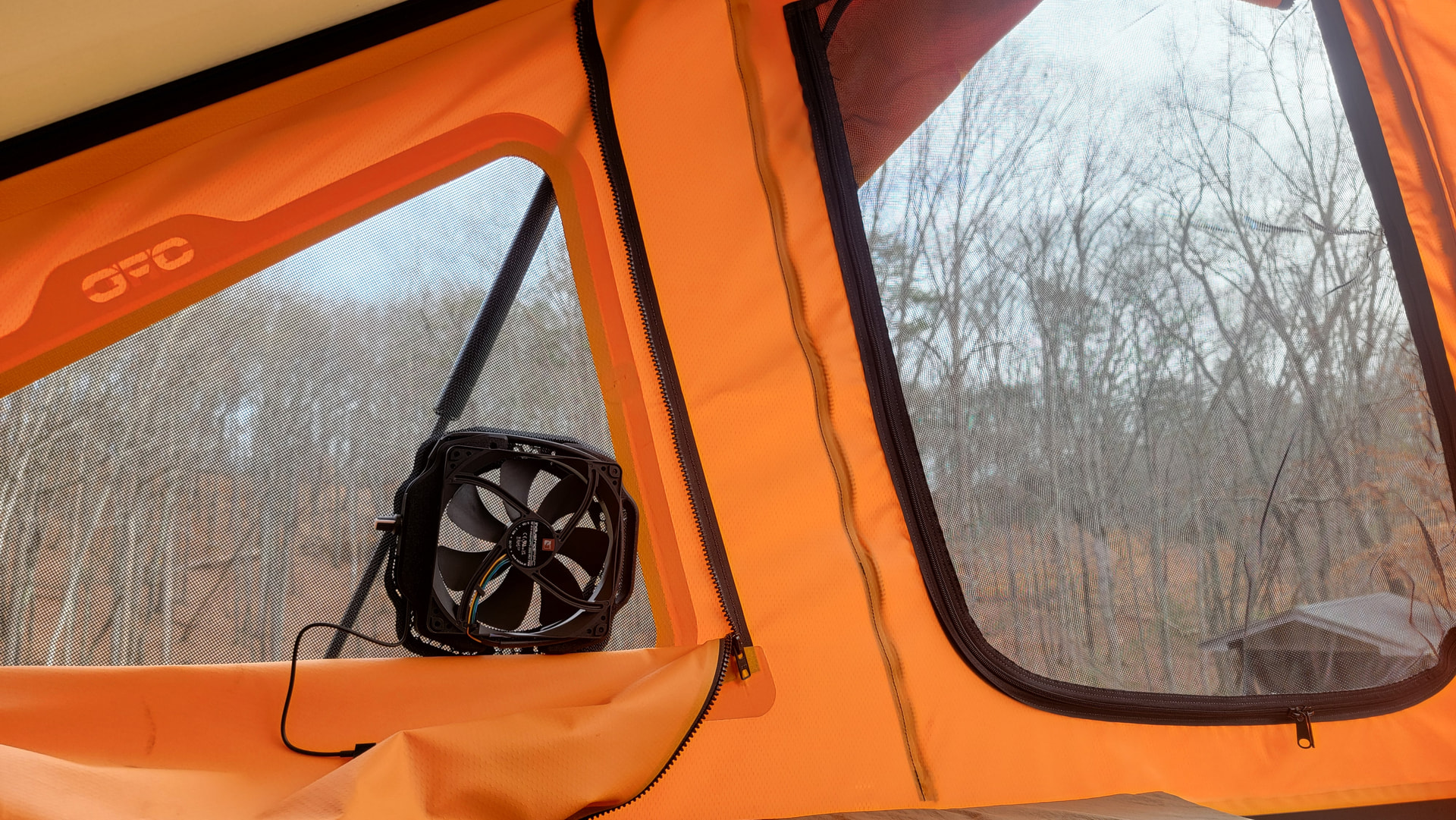

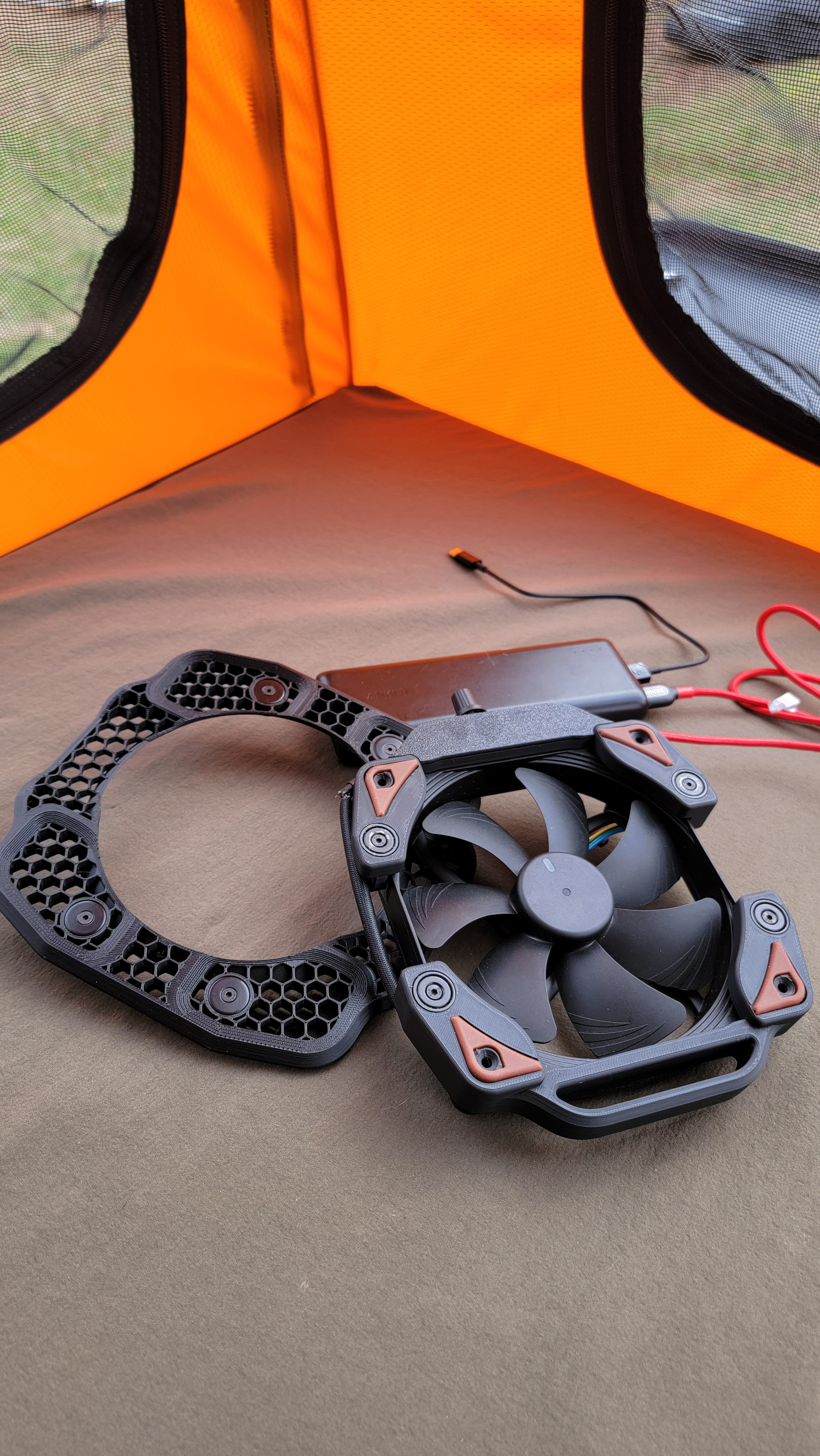

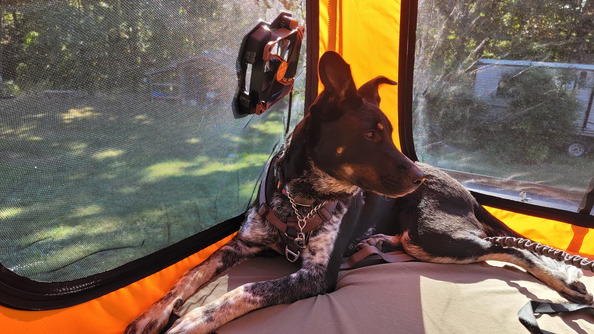

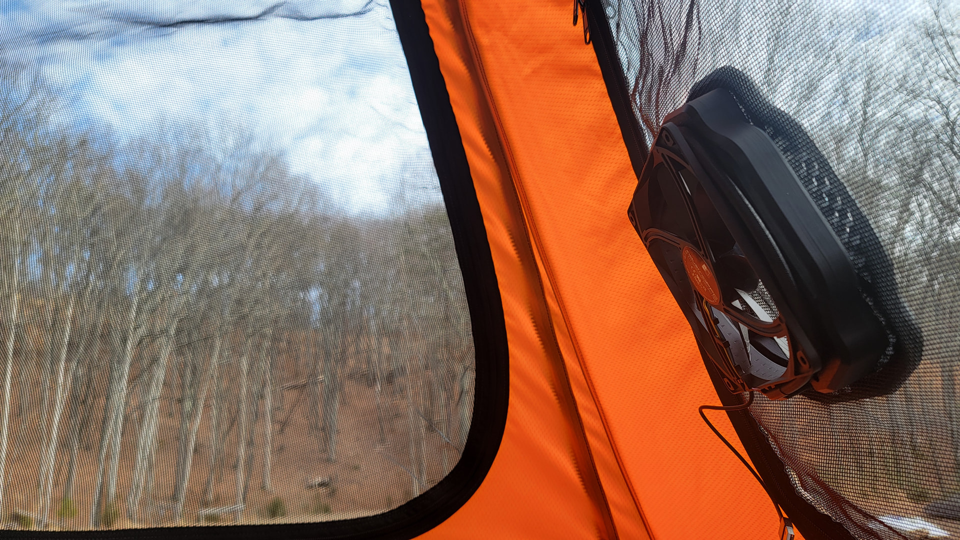

Quick follow-up to this thread since a few people asked about the prototype I shared a while back. I ended up finishing the design and will be doing a small production run.
The final version mounts through tent mesh using a magnetic clamp, so it stays put without hooks or straps and keeps airflow elevated without taking up interior space.
The fan is IP67 rated, USB-C powered with adjustable speed, and was selected to balance airflow and noise. It’s quiet enough to sleep with but still moves real air. In a GFC V2 Pro it can refresh roughly a tent-volume of air in about 30–60 seconds, depending on venting (107.4 CFM, 31.5 dB(A) max). The mount components are printed in ASA for durability and UV stability.
I’m planning to soft-launch these at $109 including the fan, starting with a small batch to make sure everything ships smoothly. I wanted to share the update here first since the early feedback was helpful.
Happy to answer questions if anyone’s curious.
