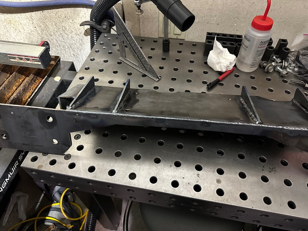

Made some progress on the new front bumper. First I made a tray for the winch out of 3/16" steel and tied it into the frame horn supports using the factory holes and hardware.
Then made a front plate that works with the factory bumper mounts/frame horns.
Then I tacked them together on the Jeep, removed it all and finished welded it along with some braces to stiffen it up around the holes. My thicker material tig skills need some work for sure.
