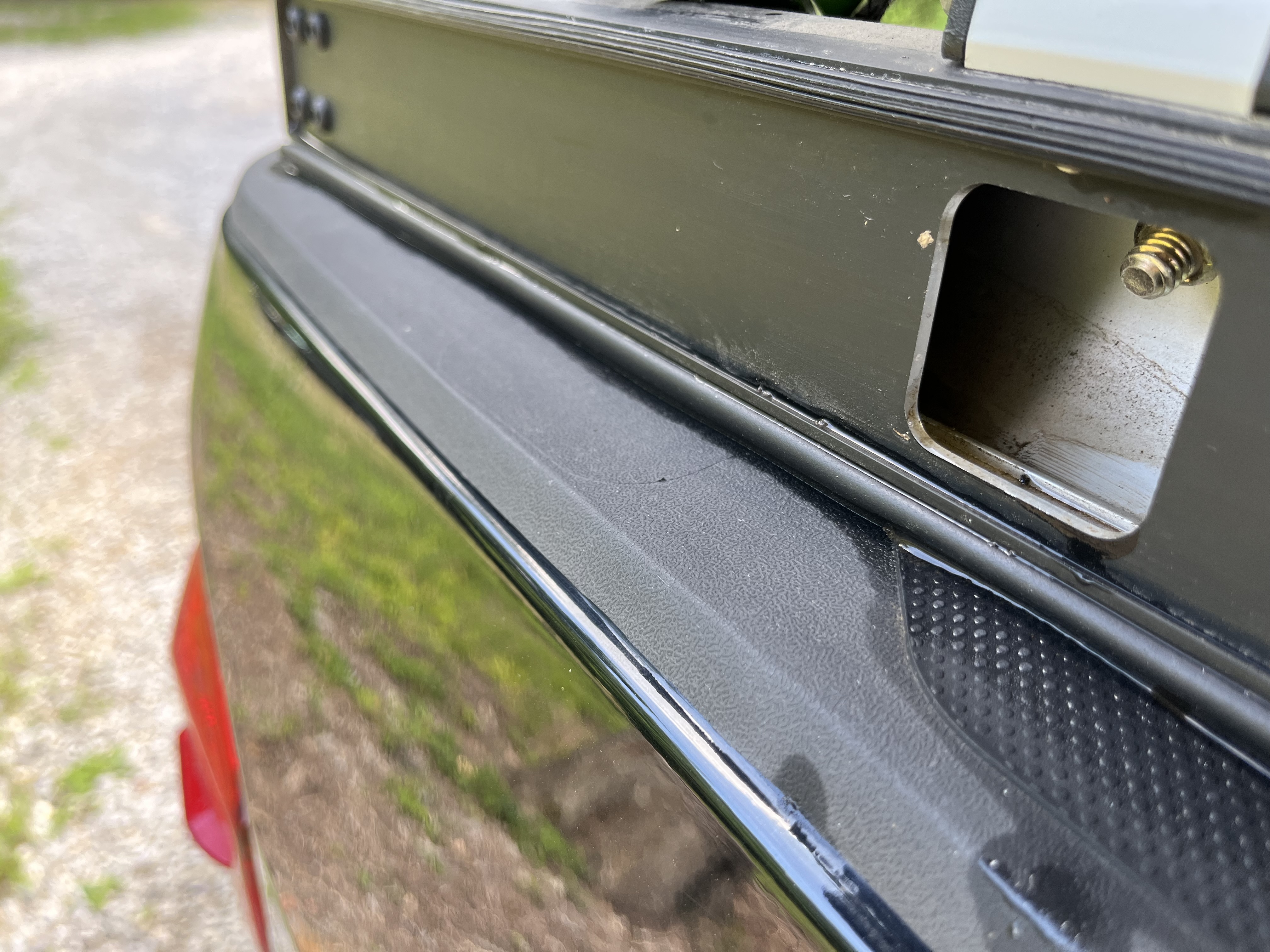

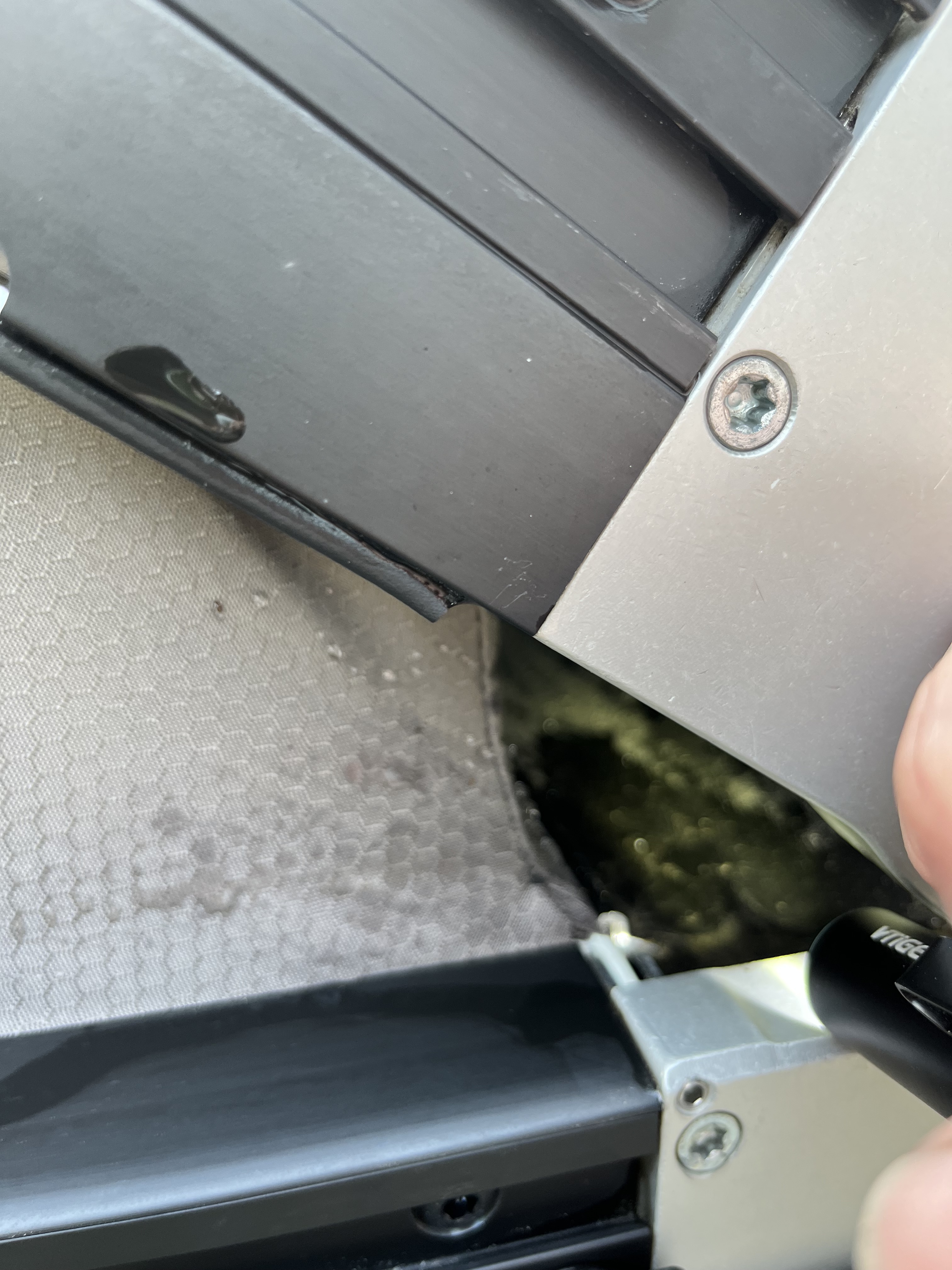

The GFC has never been completely leak free, but after 4 years things have suddenly changed. Water is coming in from the front somewhere and running down the mattress rails. Soaks the mattress and pours in the truck bed.
The bottom tubes are also filling with water.
All seals still look good. I’m wondering if there could be some kind of drain holes that are clogged?

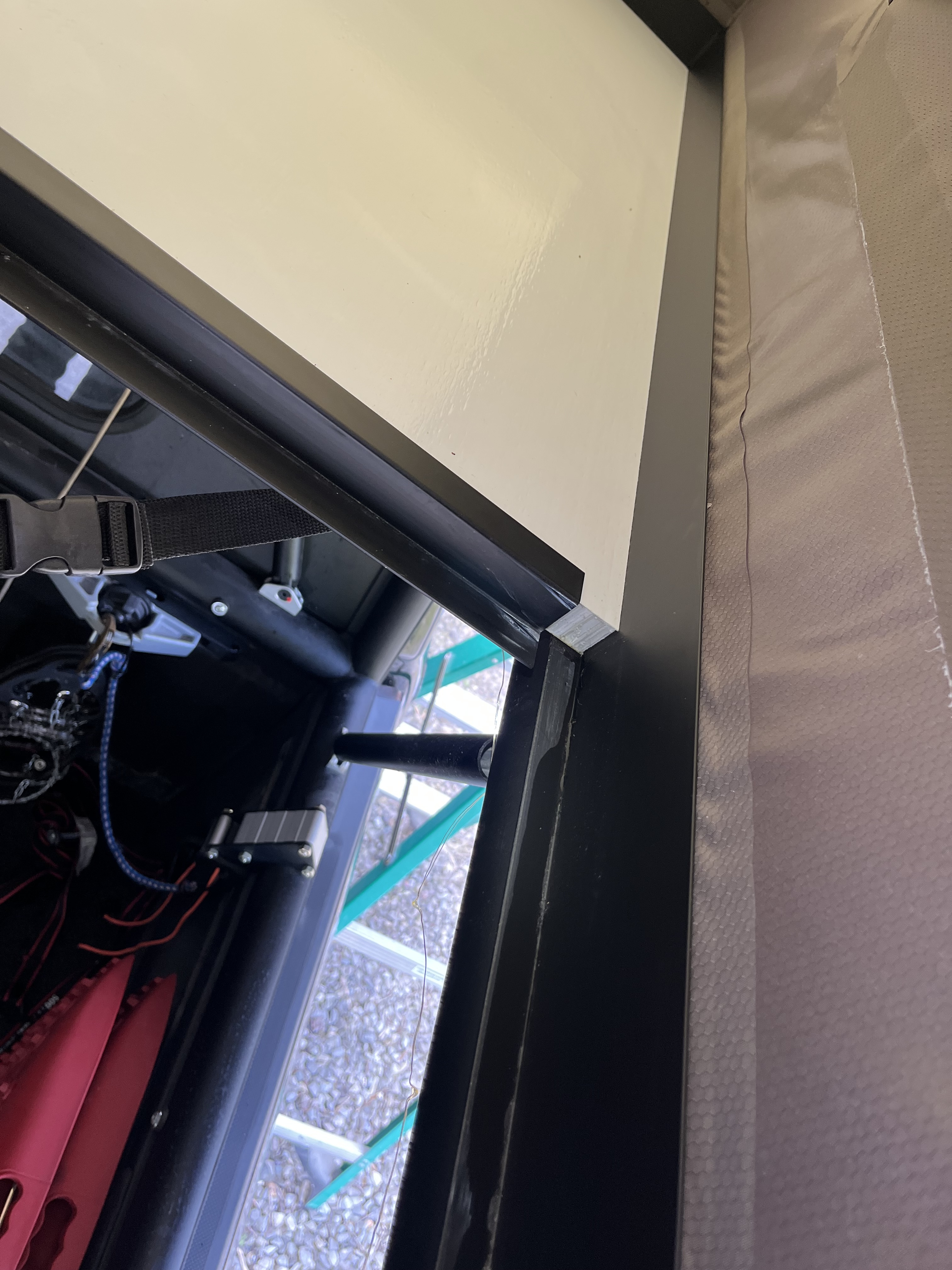

I will add, I’ve had the weather kit install since Feb 2023 by a GFC distributor. Prior to that my cushion (rear right) would get wet, been dry since with no issues until recently when I’ve driven in some hard rain I’ll notice it dripping into my bed from right where the fixed panel ends. I probably should submit a ticket.

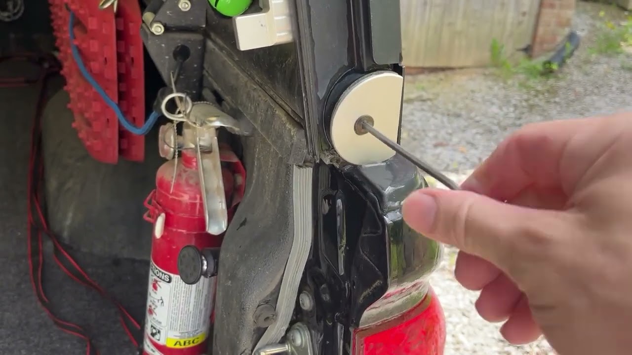

If I can’t figure anything out by winter I’ll probably drill small weep holes in the aluminum end caps.
