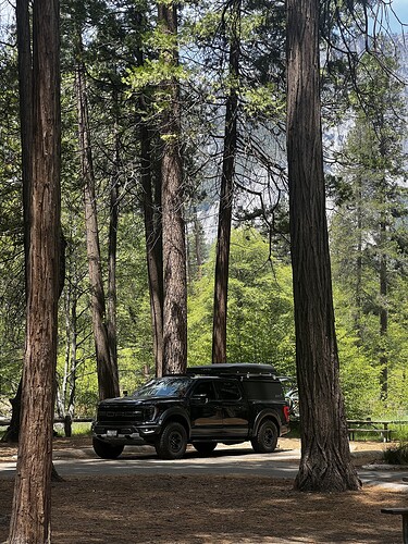

Great question and I asked my self the same thing. I have a Gen 3 Raptor and I opted to go with a GFC Platform Topper and a Ikamper Skycamp. The main reason for the Ikamper was the added space when camping. It’s me, wife, 2 boys and 2 dogs. I love the platform topper and the storage it provides for camping. I still off-road a bit and have had zero issue. I have also had no issues with road noise or drag.
I will say if it was just me and +1 I would have went with the platform camper. With that being said I have been a happy camper thus far :100:
