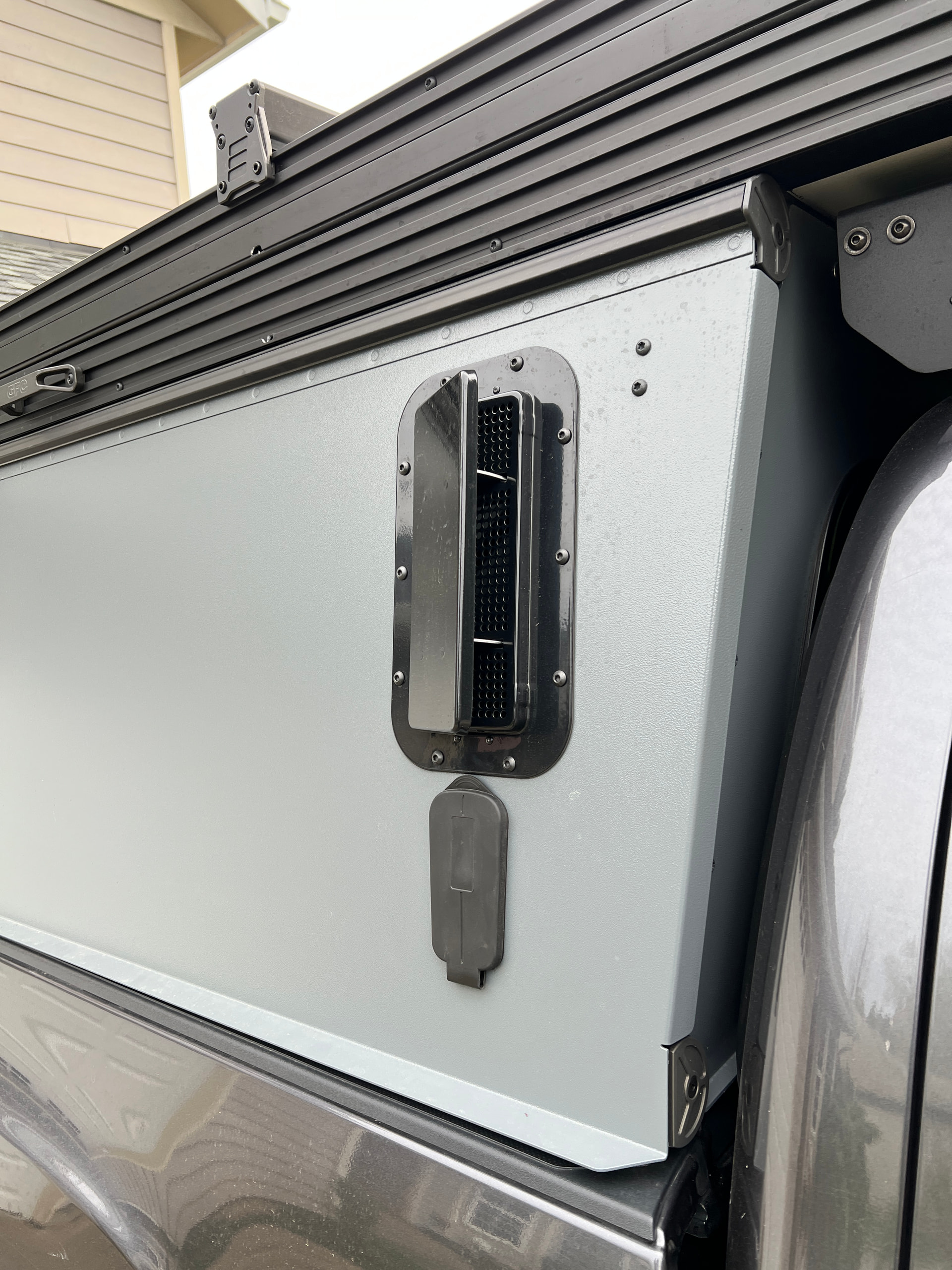

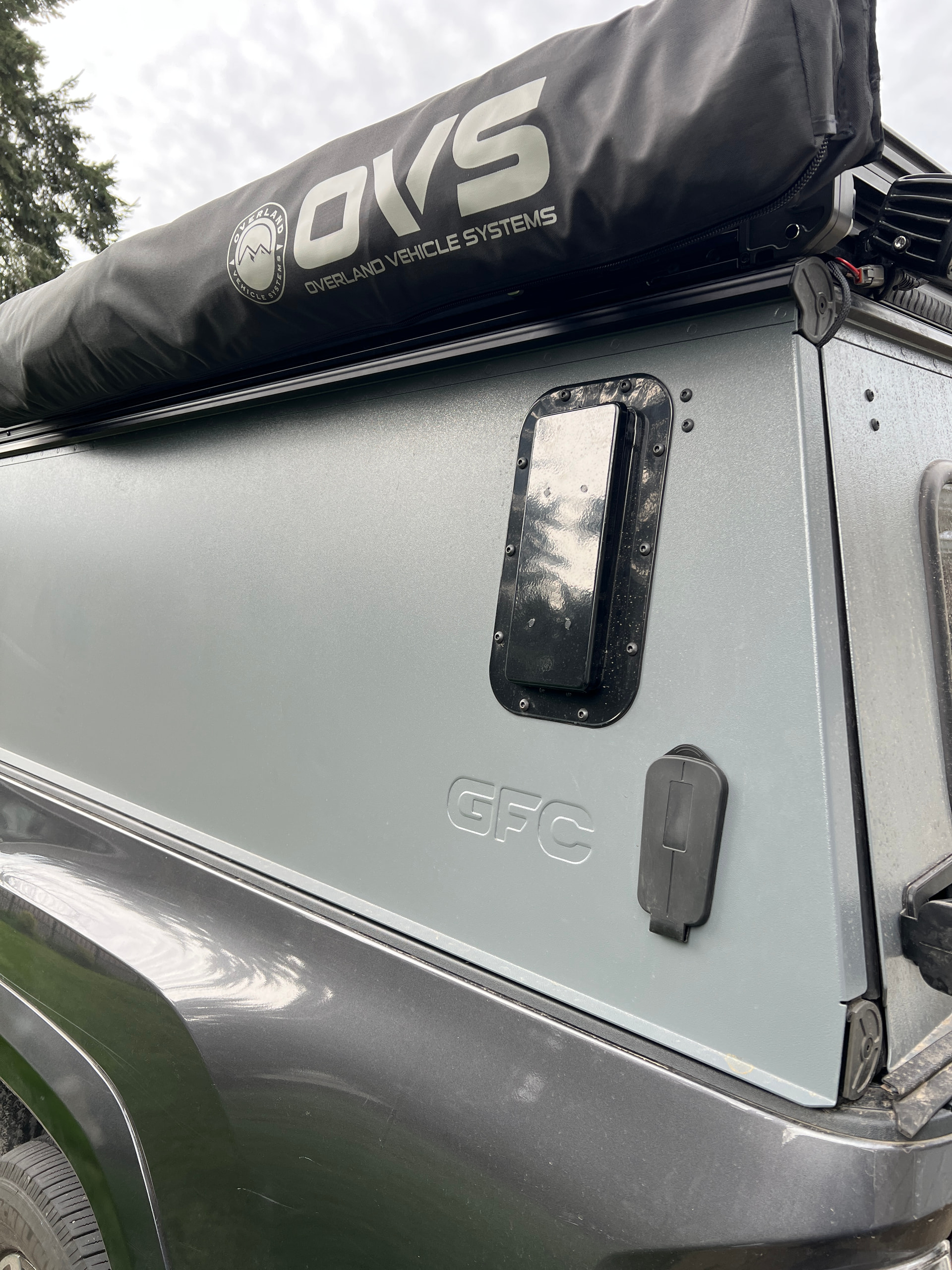

Postive pressure and Dog airflow. (thanks @PDX_Keith) I put one passenger side front and one driver side rear. My thinking is, I wanted cross flow when bringing my dog not just positive air pressure. When I need positive pressure I close the one in back. If you don’t you’re not creating positive pressue where its needed which is all the little cracks and whatnot to keep the dust out. When it rains you can close them, as you shouldn’t need them as there should be no dust. Or with the dog you can reverse their direction (the ones installed are reversable).

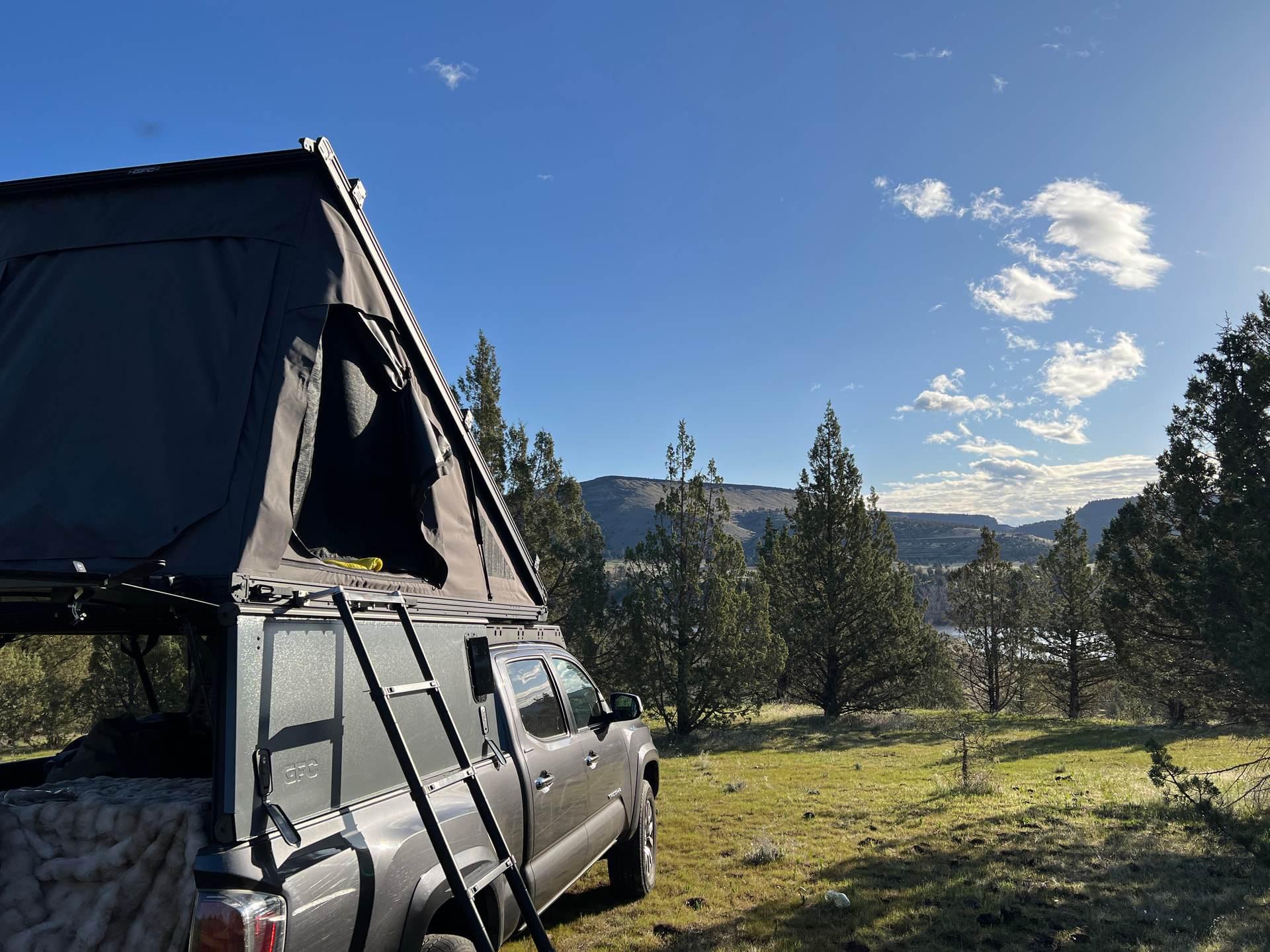

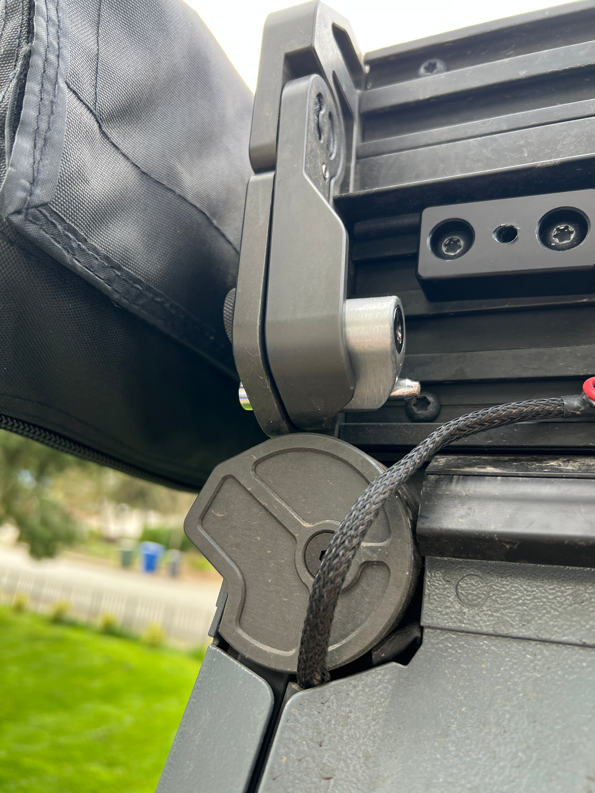

Ladder and mount: I chose to spend the extra on the alu-cab telescoping ladder as it has better and wider steps useful for older feet. This required some adjustments of the ladder to make the GFC Mantis claws work but, it works great. The strength of the ladder also allows me to have it at more comfortable angle. I chose to install on the right side as I chose the awning install on the left side. Having the awning on the left side just felt more natural.

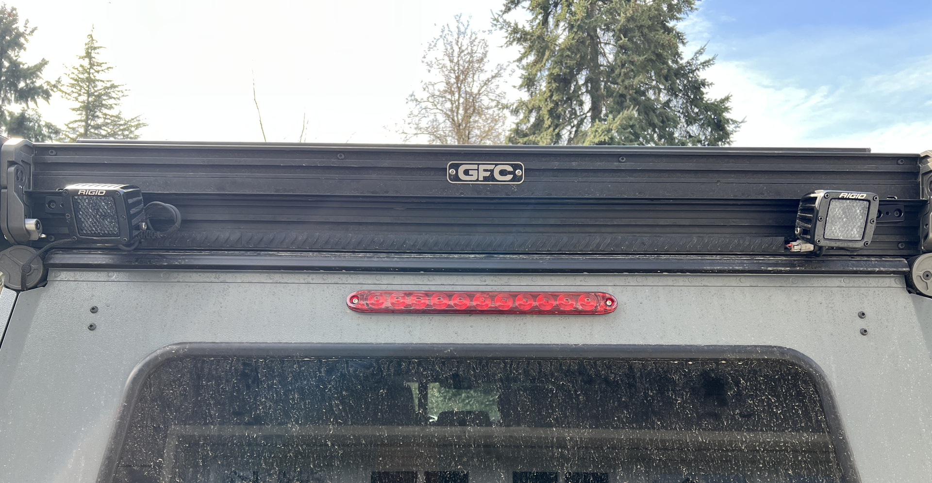

Lighting: I have the built in lighting for the tent and the truck bed that was part of the build. They plug into the Jackery (more on that later) and provide ample lighting. For outdoor lighting, I have the lighting kit for the awning from OVS and Rigid lights attached to the back of the tent mount. These are wired to my backup system so they automatically come on when backing up, in this situation they run off of truck battery. There is also a switch mounted on the back driver side of the truck so I can turn them on running on the Jackery. They do fit below the awning so they light up underneath it. For Trail lighting I installed the Rigid Industries 930314 SR-Series Pro Combo Light Bar on a Trailrax Modular roof rack, I chose this lighting setup as I didn’t want a bunch of individual lights but still achieved the same distance, side and up front lighting. It works brilliantly (no pun intended by then again why not).

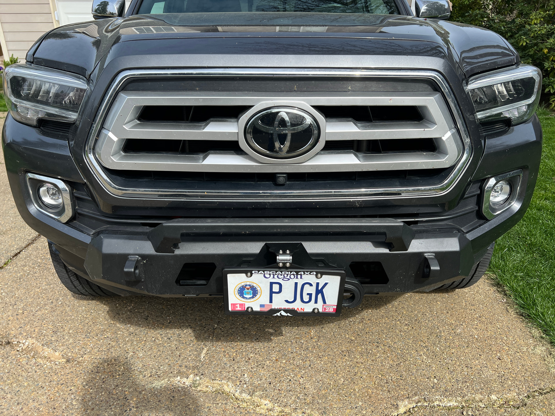

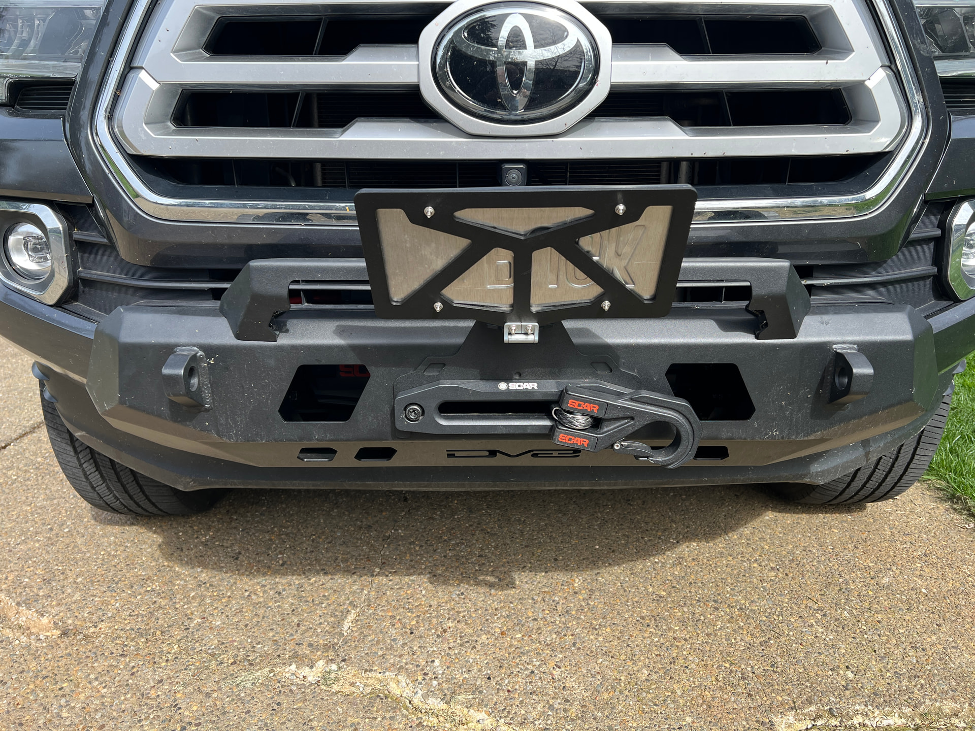

Recovery: I have your basic 48” 5000 lb trail jack and the Scar winch hidden behind the Hiline front winch bumber and also the Flipster V3 | Winch License Plate Mounting System

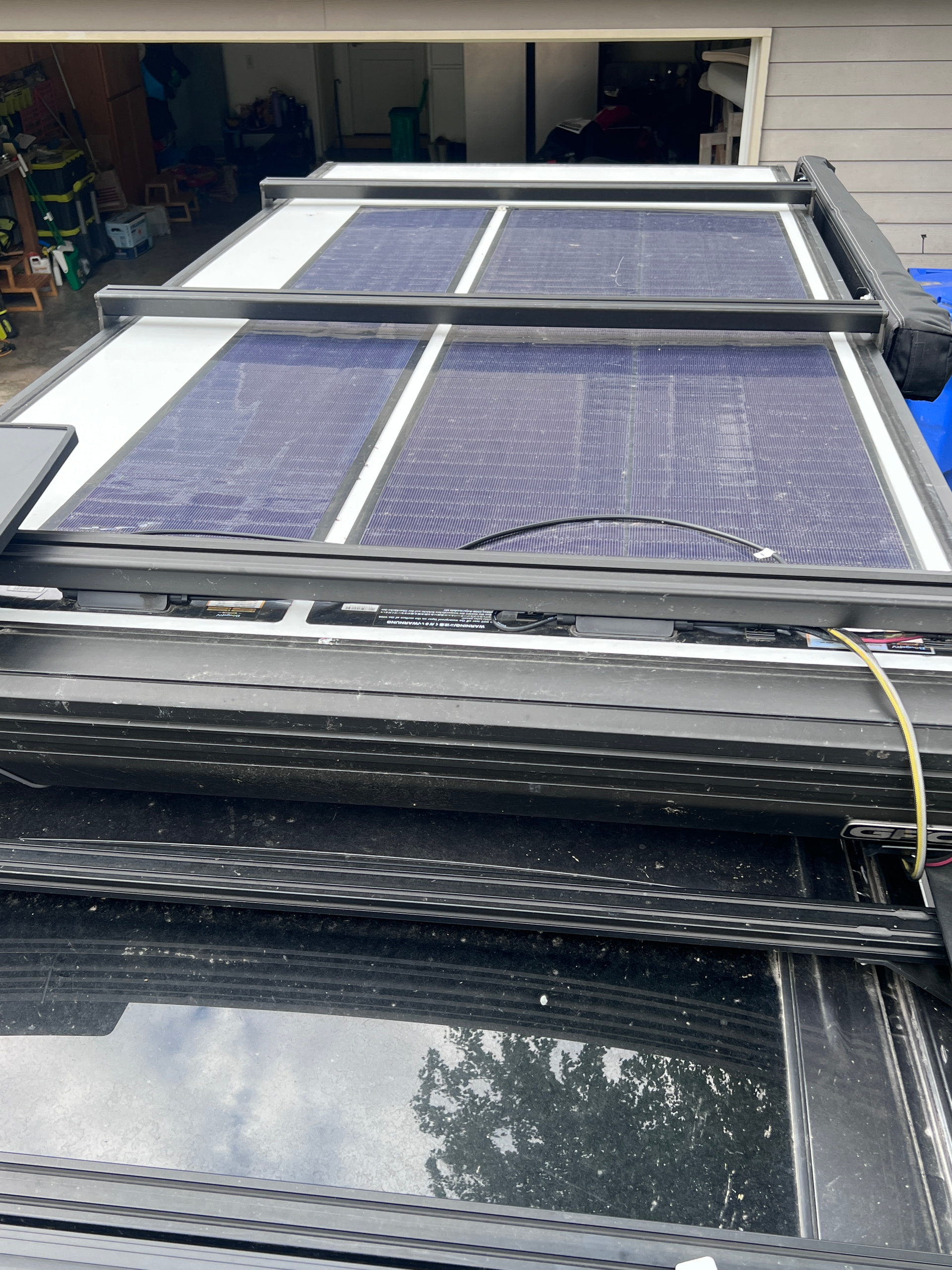

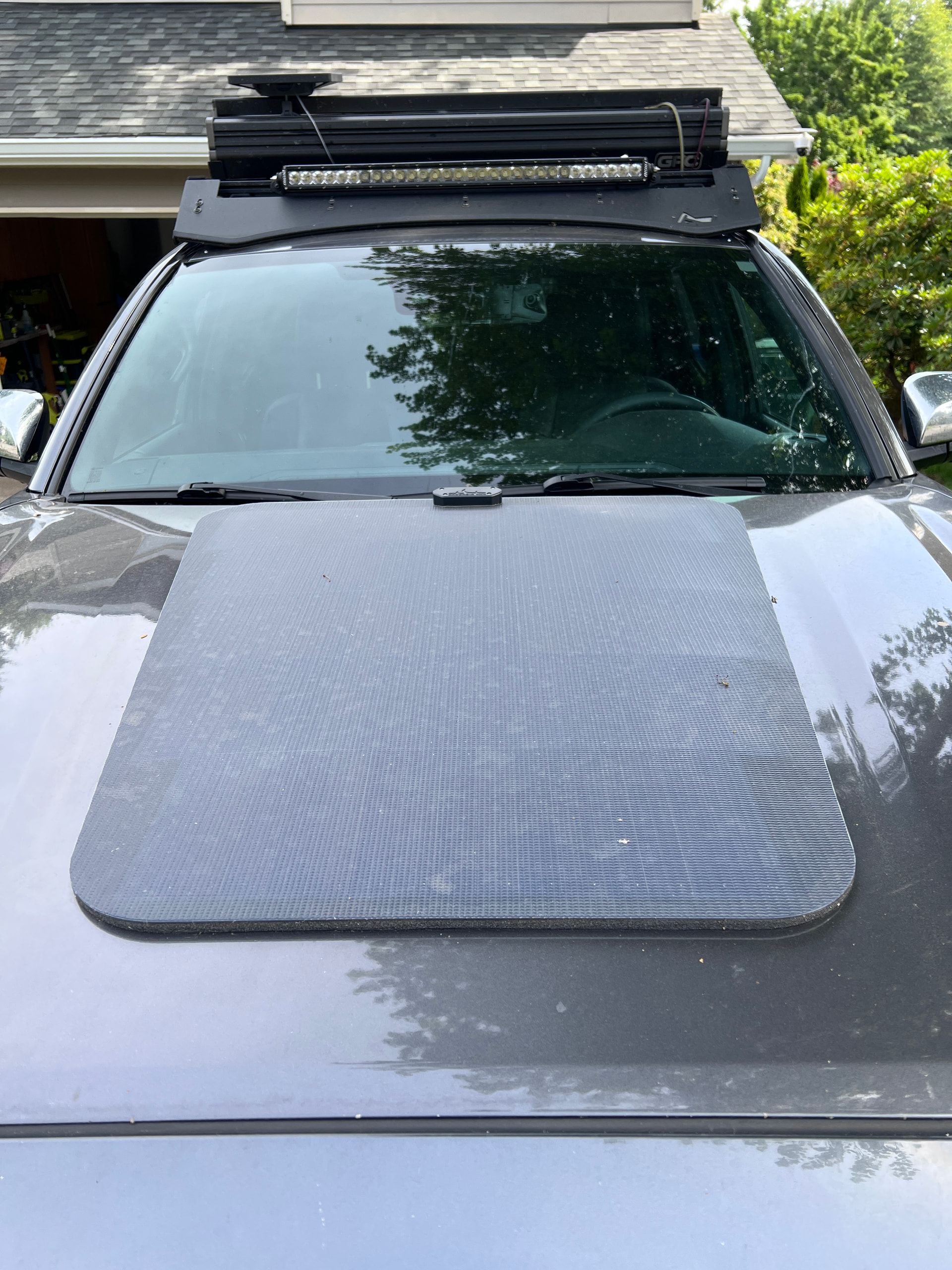

Time to add more updates. I installed the 200W solar panels from GFC, they were super easy to install, then I added another 100w unit next to them and a 92w hood mount solar.

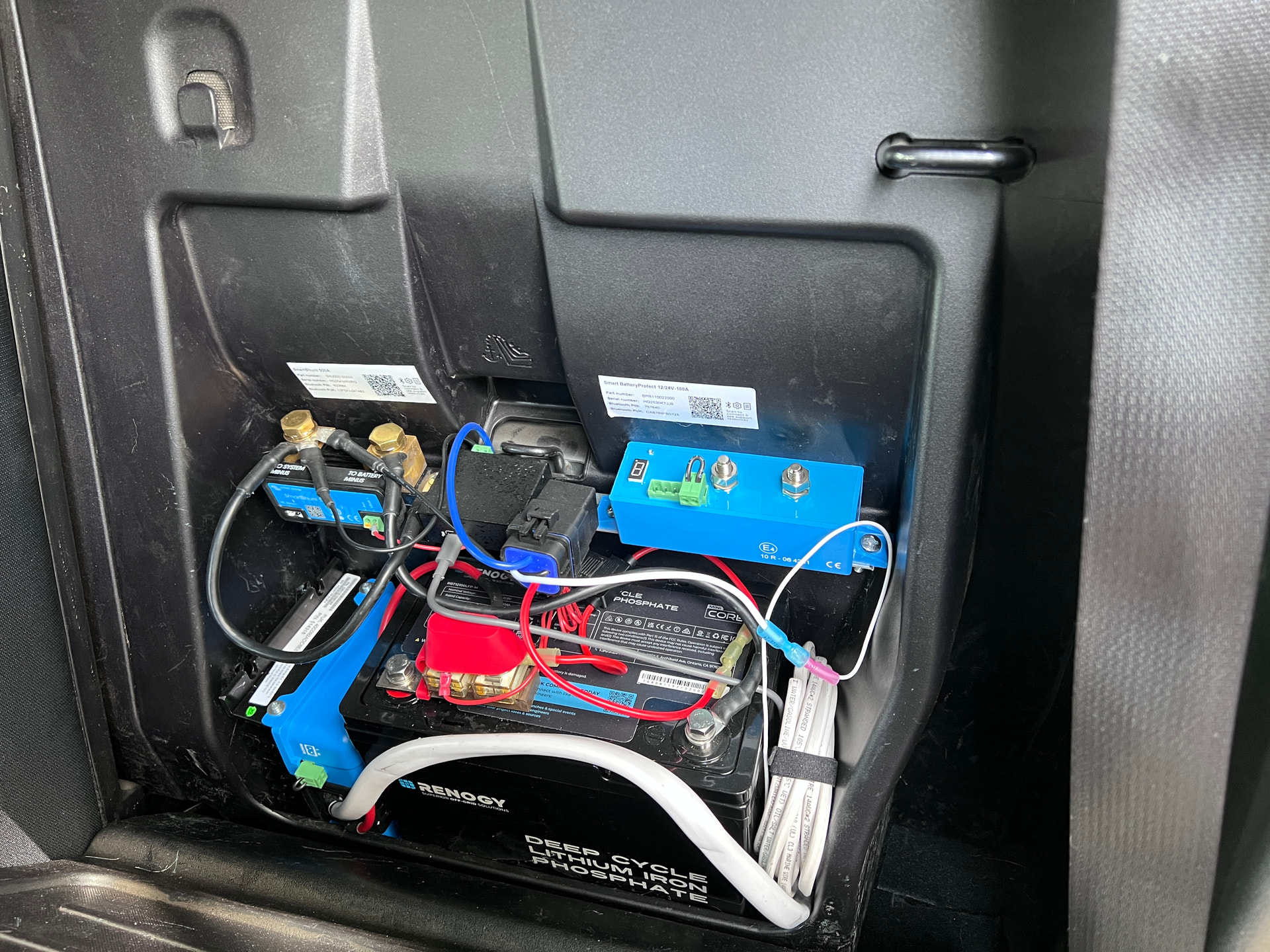

I got all this to fit in the space behind the driverside passanger seat: Renogy battery, Victron DC/DC converter, Victron BatteryProtect, Victron SmartShunt, Waterproof relay, DC to USB-C PD, and the necessary fuses. There has been no issue with heat.

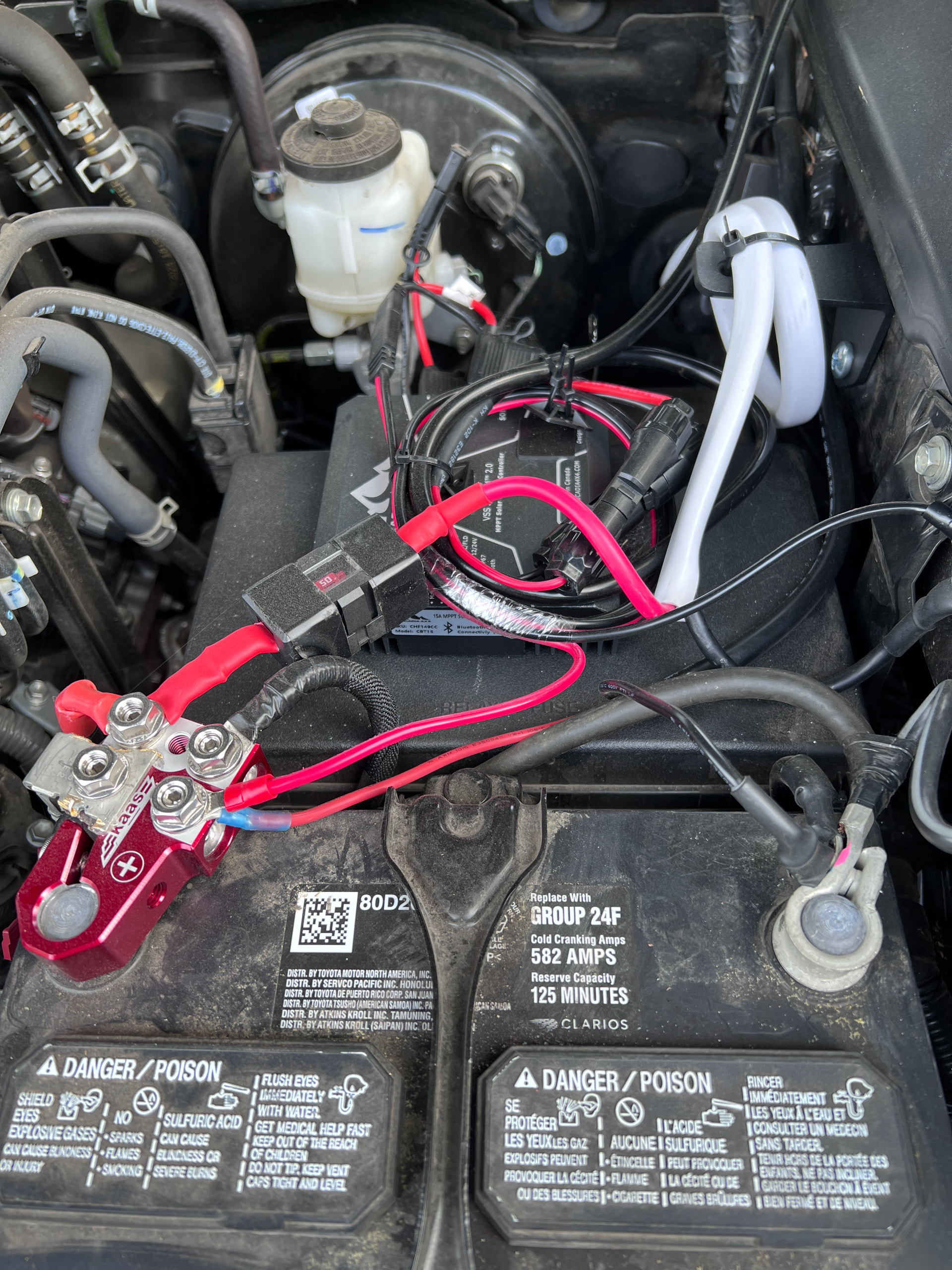

For the Solar inside the engine bay, it was the Cascadia 15A MPPT Bluetooth Solar Charge, Controller, fuse, and a terminal connector to attach all that damn stuff.

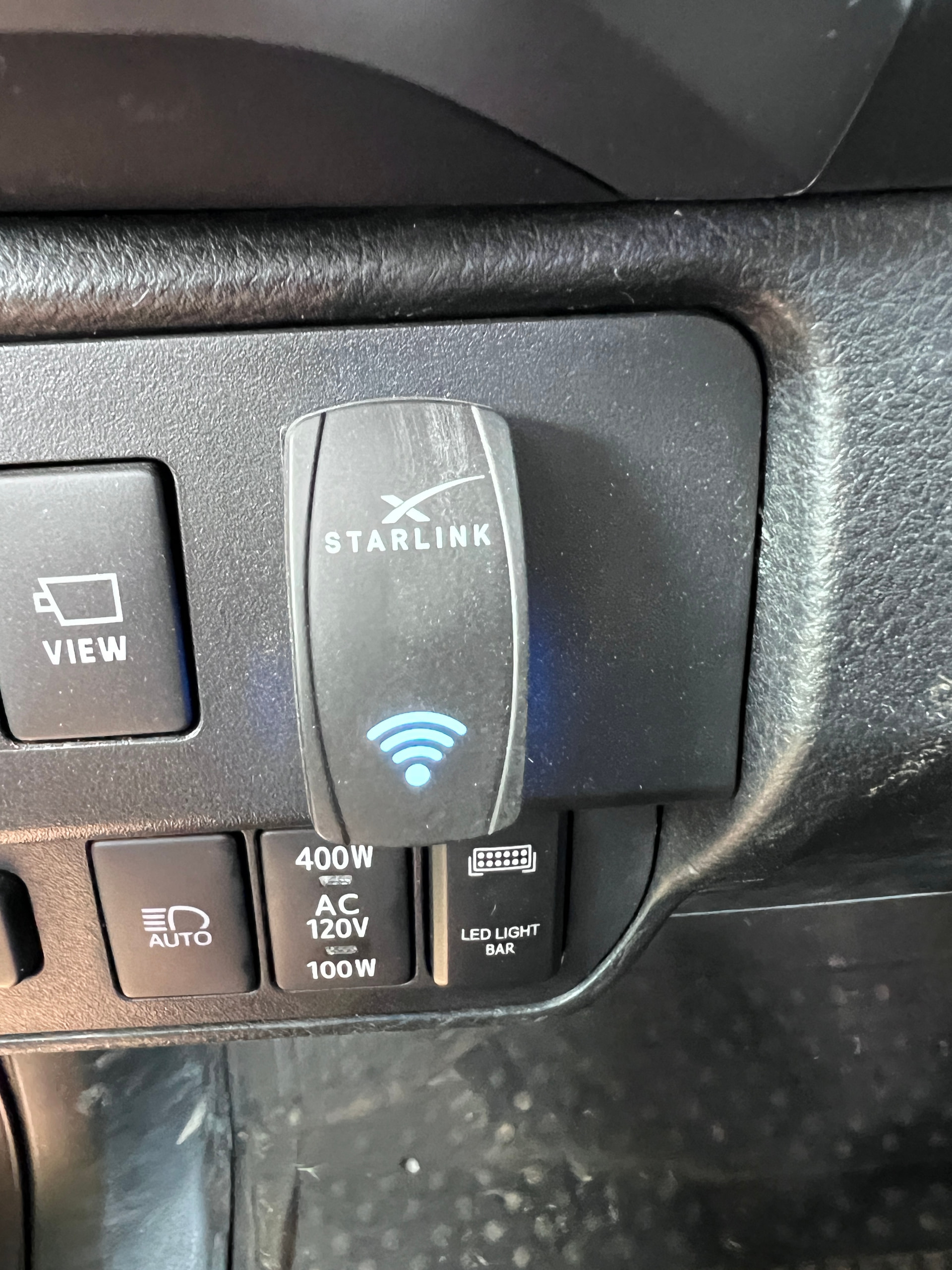

Starlink swith and Starlink USB-C cable
Did you wire up the 100W panel using the white/yellow cables on the passthrough?
Yes, I did. So now I have two solar power cables feeding my Jackery.

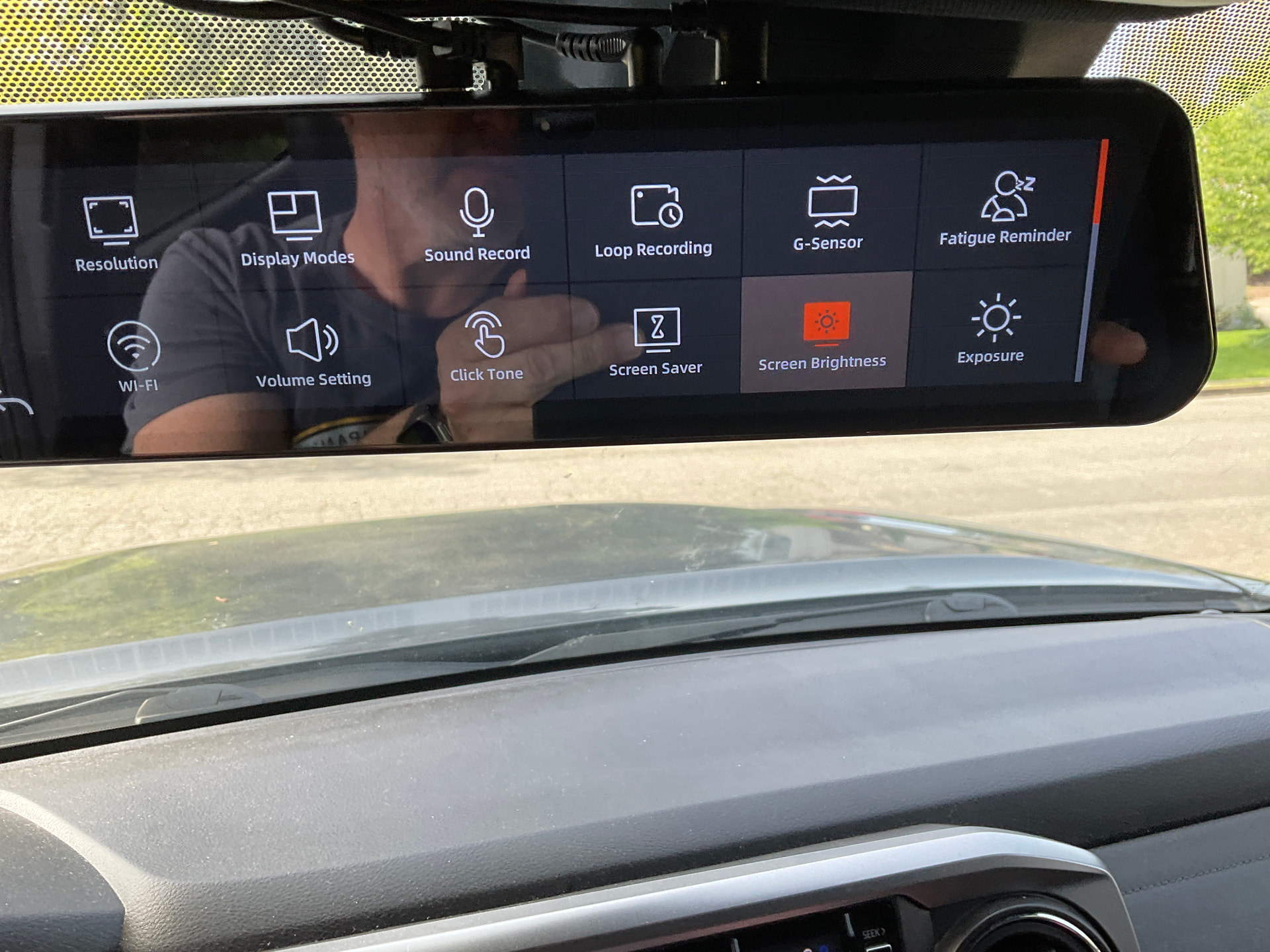

Also added was a WOLFBOX G900 Tripro Cabin Version 3 and the mount, then I mounted the rear camera using the Use More Force mount.

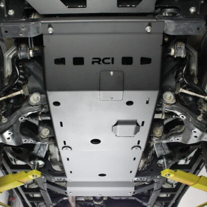

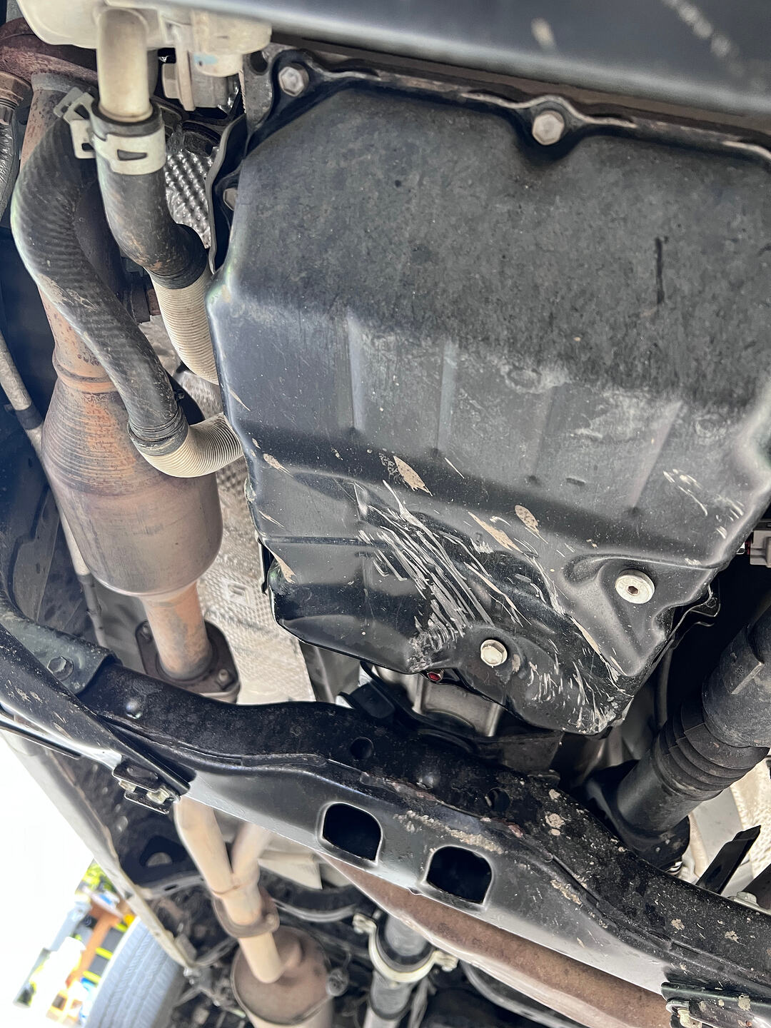

After this (transmission pan) damage:
I installed real skid plates
This is not my truck (sorry, I didn’t feel like getting under my truck to take a pic):
