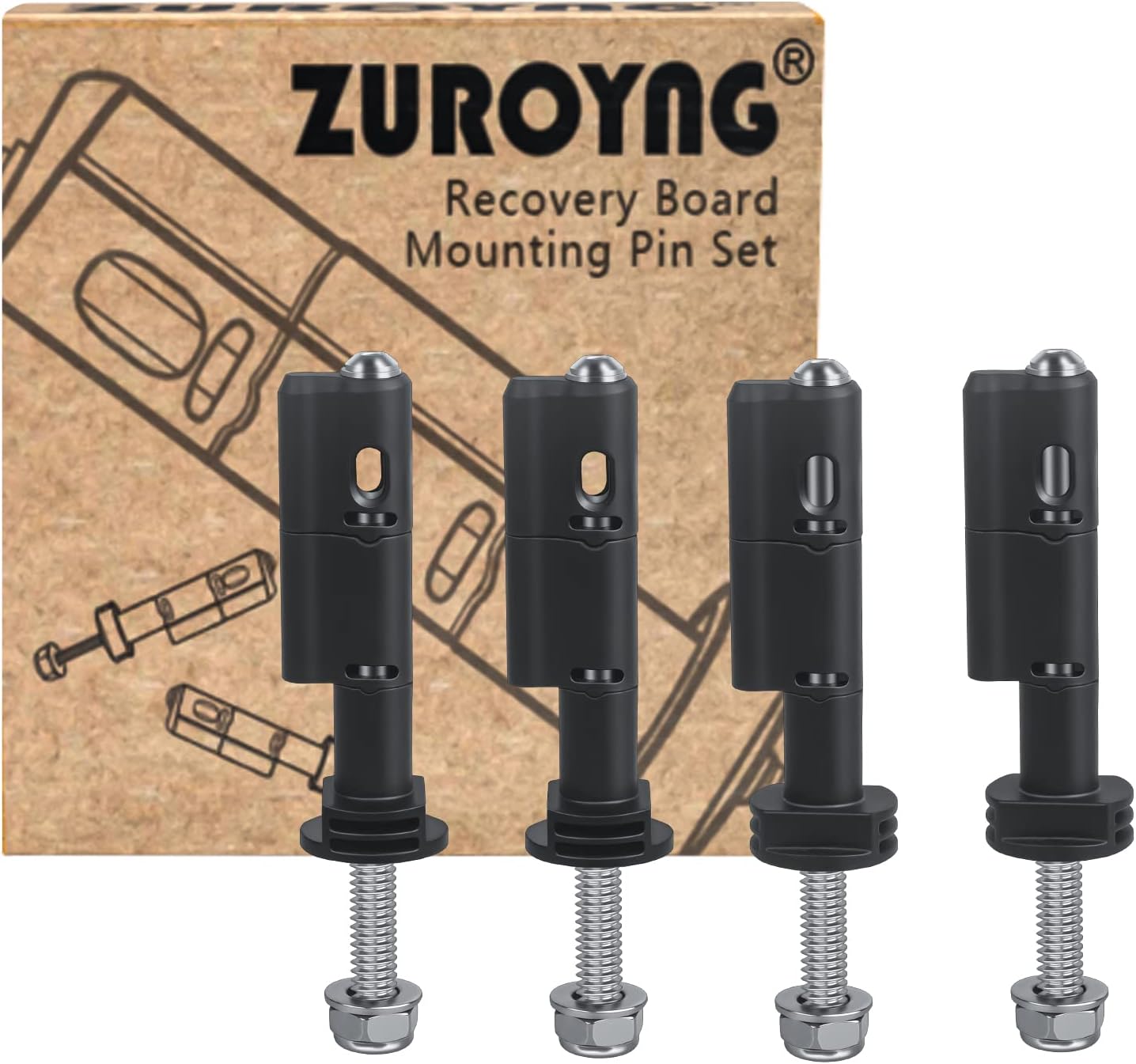

Did you use the 17mm or 40mm pins?
I used these:
