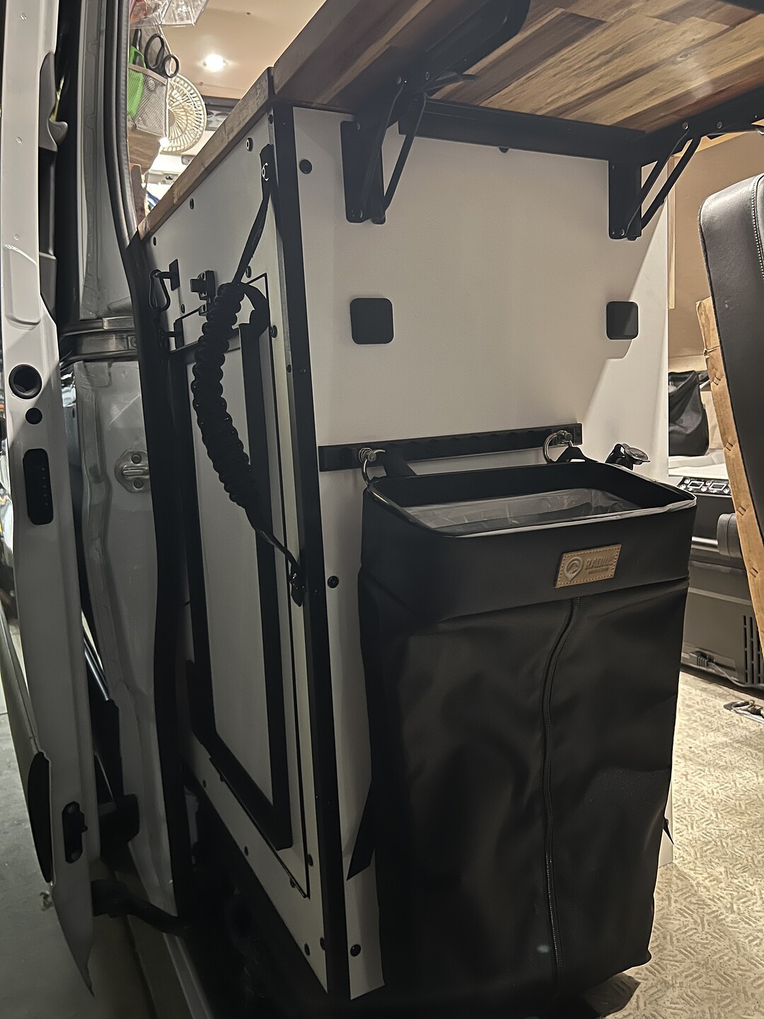

This last week I added a 12” section of L-Track below the folding countertop extension to secure a Radius Outfitters Canvas Trashcan. I bedlined some aluminum angle for the vertical corner of the galley to protect the laminated edges and to give it a more finished look.

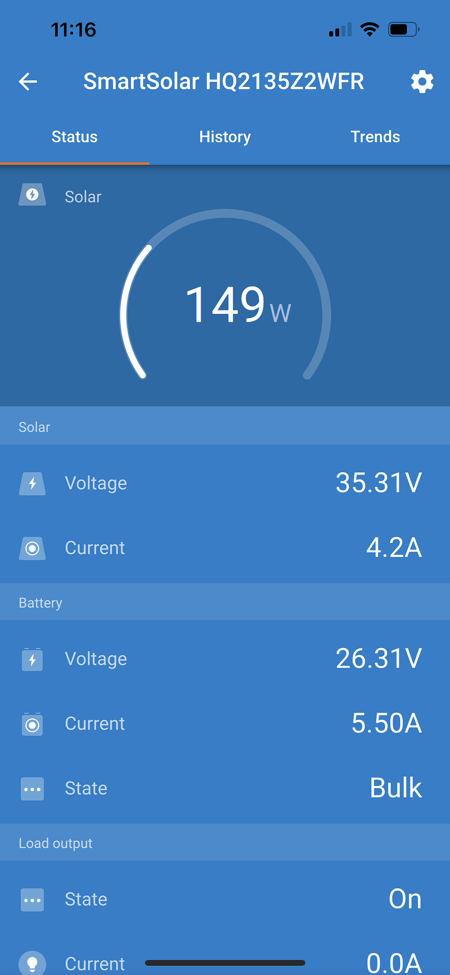

When I did the electrical wiring this past summer, I prewired a 10awg duplex line for a portable solar panel. The duplex wire goes from a Victron SmartSolar 75/15 MPPT Solar Charge Controller (in the electrical cabinet), through the driver side lower access panel, outside and underneath the van to the trailer hitch.
I wanted to finish this up in preparation for a camping trip in a couple weeks. So, I used a Curt brand trailer hitch L-bracket that’s made to secure 7-pin trailer harness to mount up a water resistant junction box. The duplex wire goes into the junction box and and then to a DC plug/outlet.
I went with a 200W ALLPOWERS Portable solar panel and am very impressed with its value, packable size, quality of construction and output.
https://www.amazon.com/dp/B09725M32Z?ref=ppx_pop_mob_ap_share
I did a test run on a partially cloudy day and was pulling around 150W! Having the ability to adjust the angle and move the panel around is great. The 400W roof panels were only pulling in around 150W because of the angle of the sun and the inability to orientate the roof panels.
I added another 20 feet of duplex wire to the panel to give me a little more portability. The setup and tear down of this system takes less than a minute.

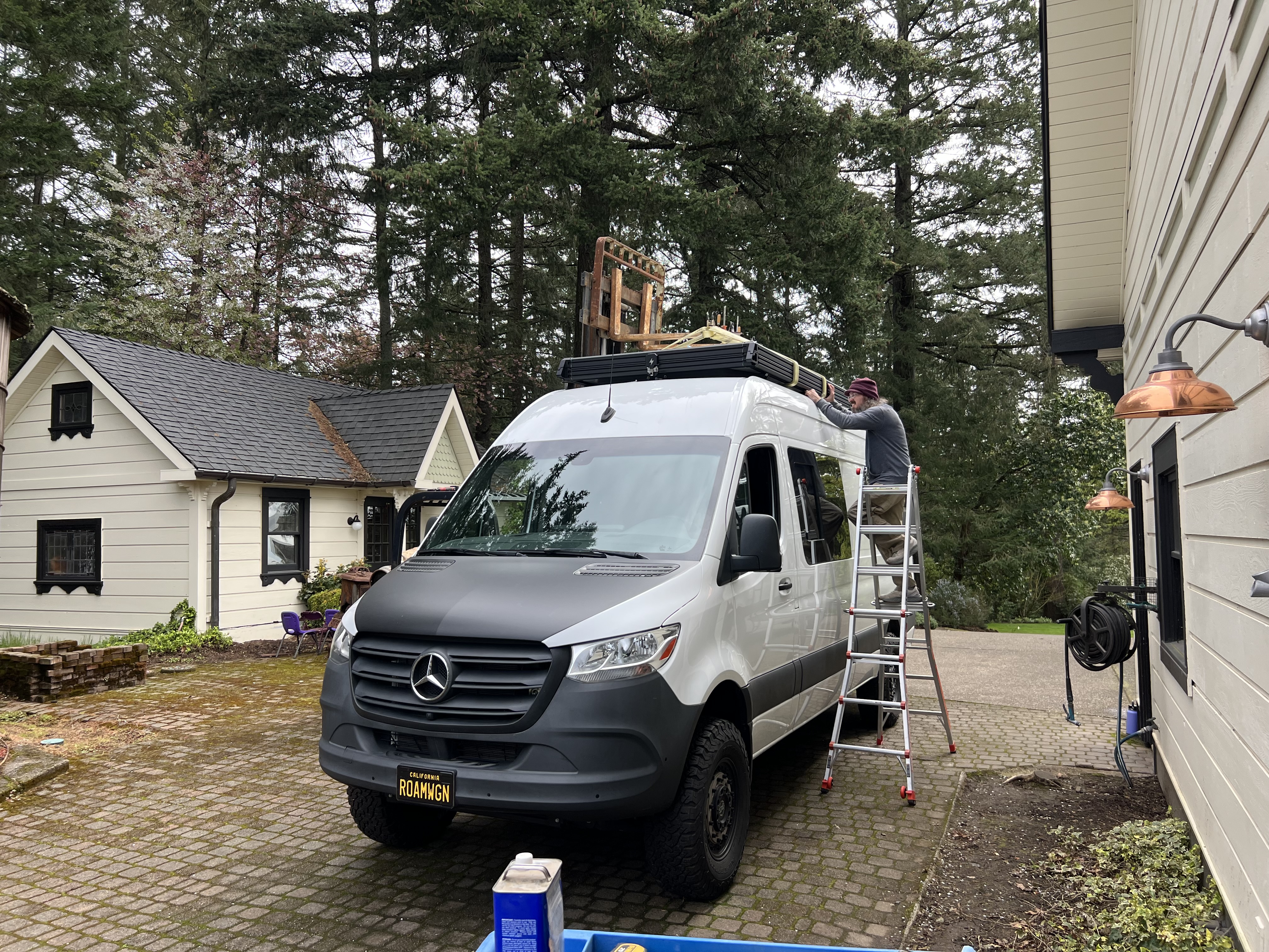

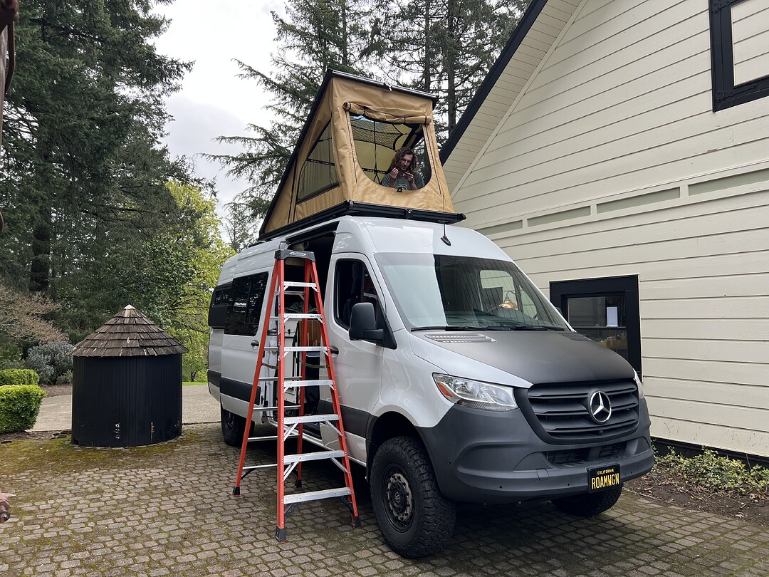

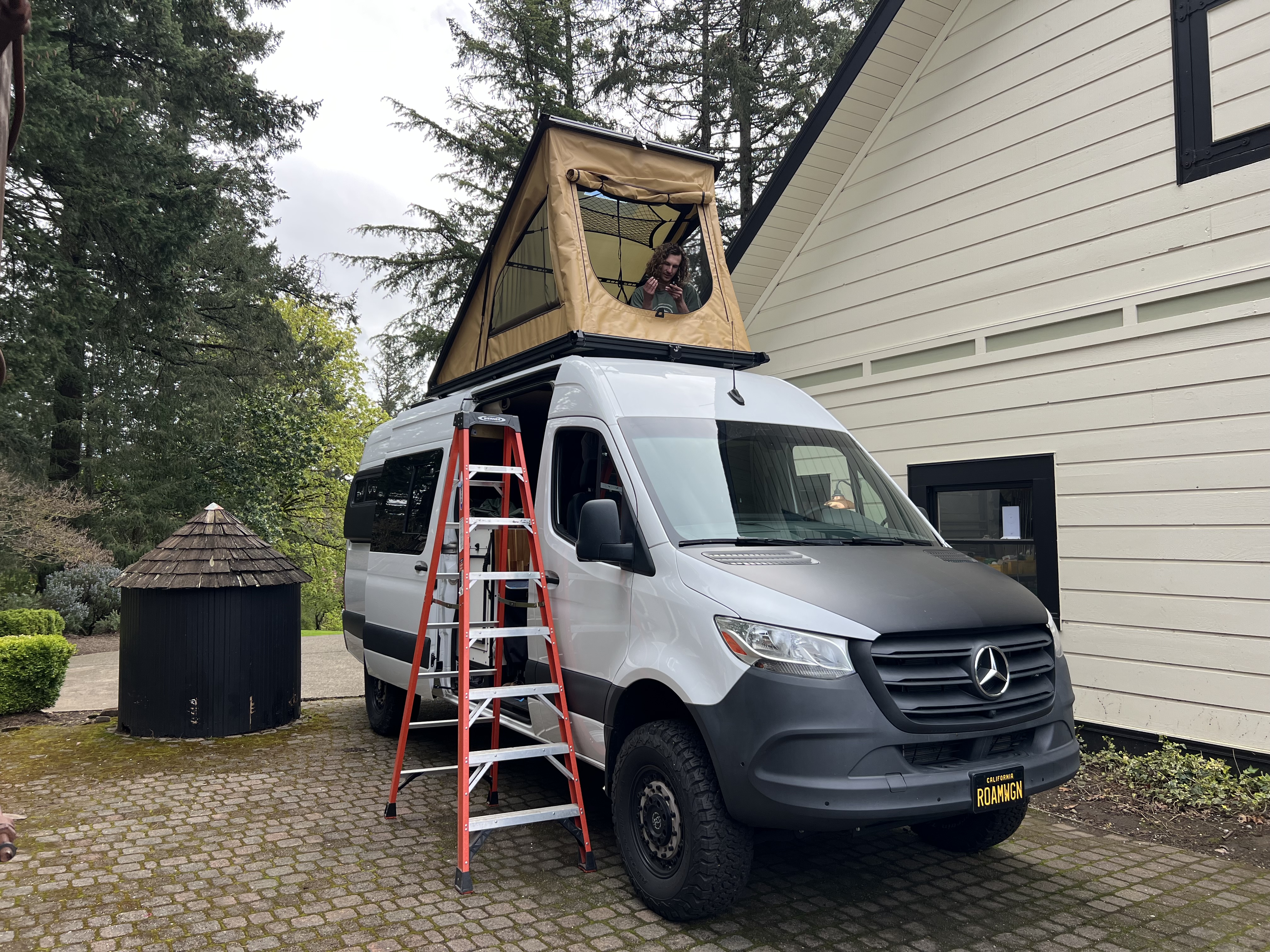

Hey GFC Fam,
I ended up going with Super Pacific’s Cloud Cap for our build. I was contemplating buying a GFC and modifying it to allow a pass-thru on the roof of our van; however, when SP came out with their Cloud Cap, it made perfect sense to go that route.
