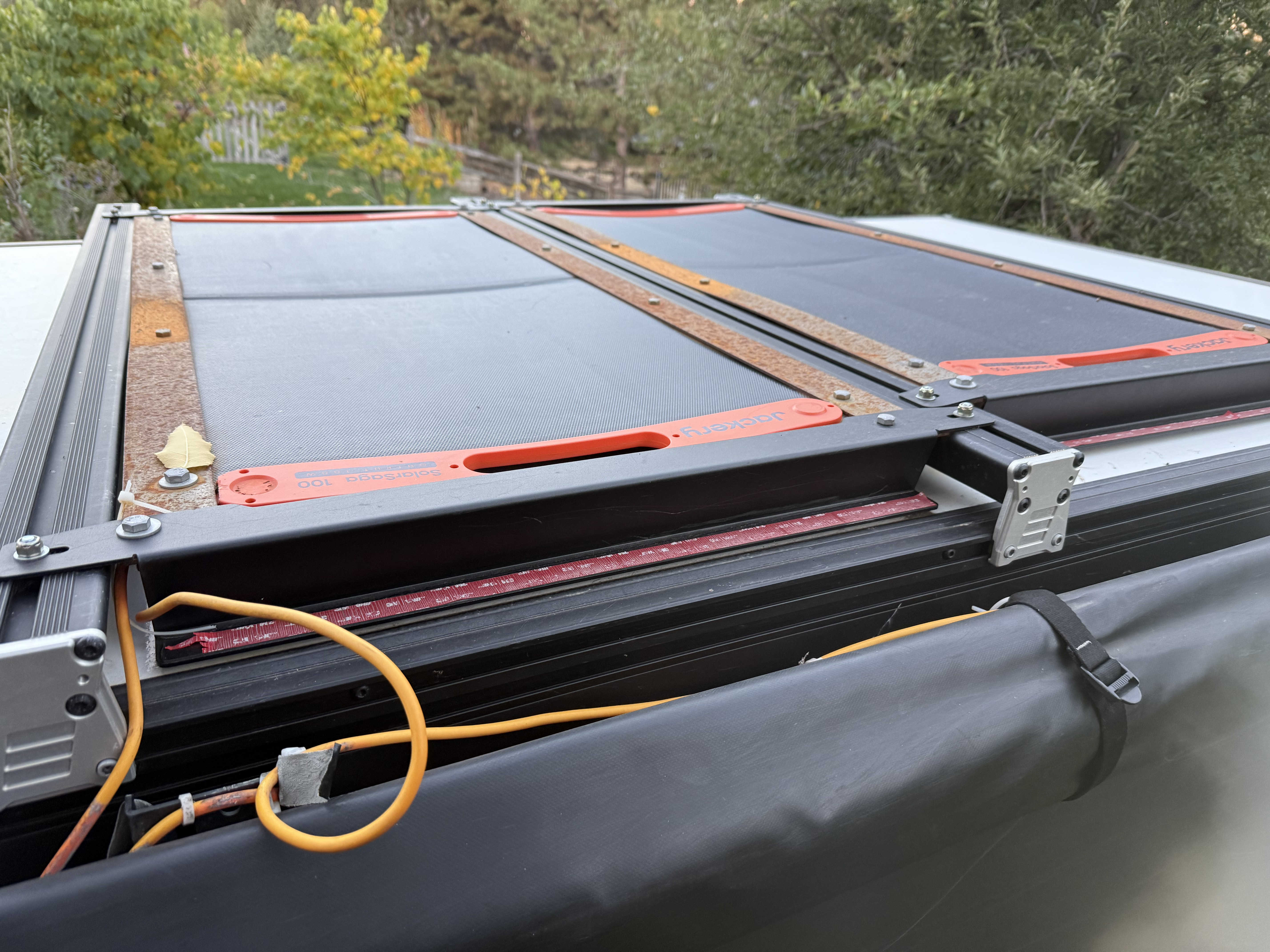

I have been using Jackery Saga 100 Solar Panel trays and when got my GFC V2 Pro this past Fall i tried a few different ways of attaching them to the GFC beef bars and solar trays. As the GFC solar panel trays appear to be designed for rigid solar panels, i wasn’t able to find a decent way to securely attach the flexible Jackery panels. This past weekend, i came across an online video that sparked an idea - which was to create a rigid frame around the Saga 100, then attach the frame to the GFC solar panel trays which are then attached to the beef bars.
I opted to use flat steel bars - 2 each which are 6’ long x 2" wide and 1 which is 6’ long by 1" wide. They are all 1/8" inch thick. I used galvanized washers/nuts/bolts - 5/16". The bolts are 1". The total cost of the steel, nuts/washers/bolts was around $150 at Home Depot.
I cut the 2" wide steel bars to 52" each - leaving right at 2" extended past the 48" length of the solar panels. I cut the 1" wide bar to 44" and used the remaining length to fit between the foldout “stands” on the back of the Solar Panel. So when needed i could remove them from the roof of the GFC and stand them upright on the ground.
The rigid panel/frame mounts flush with the beef bars and allows for air flow beneath the solar panel.

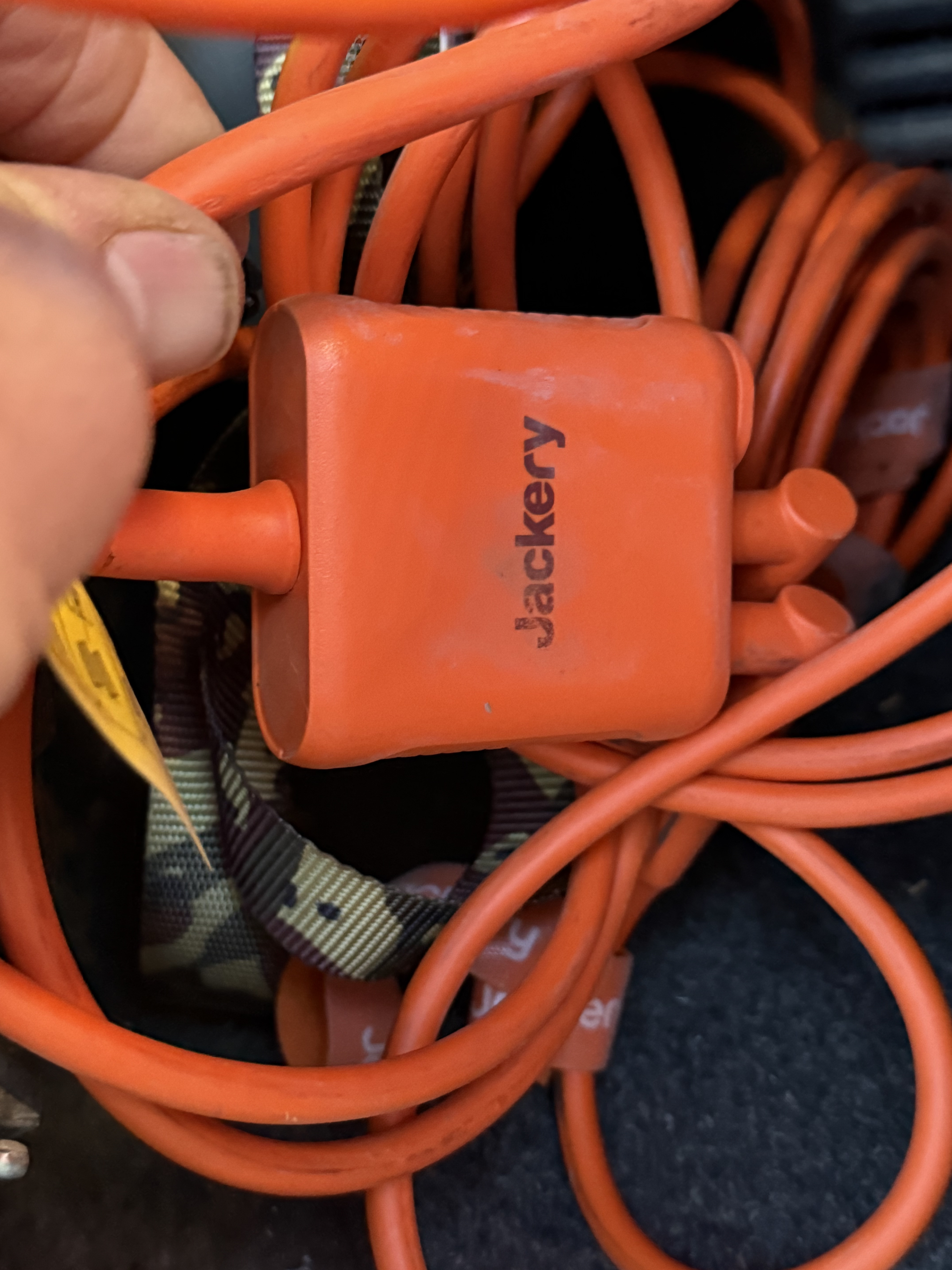

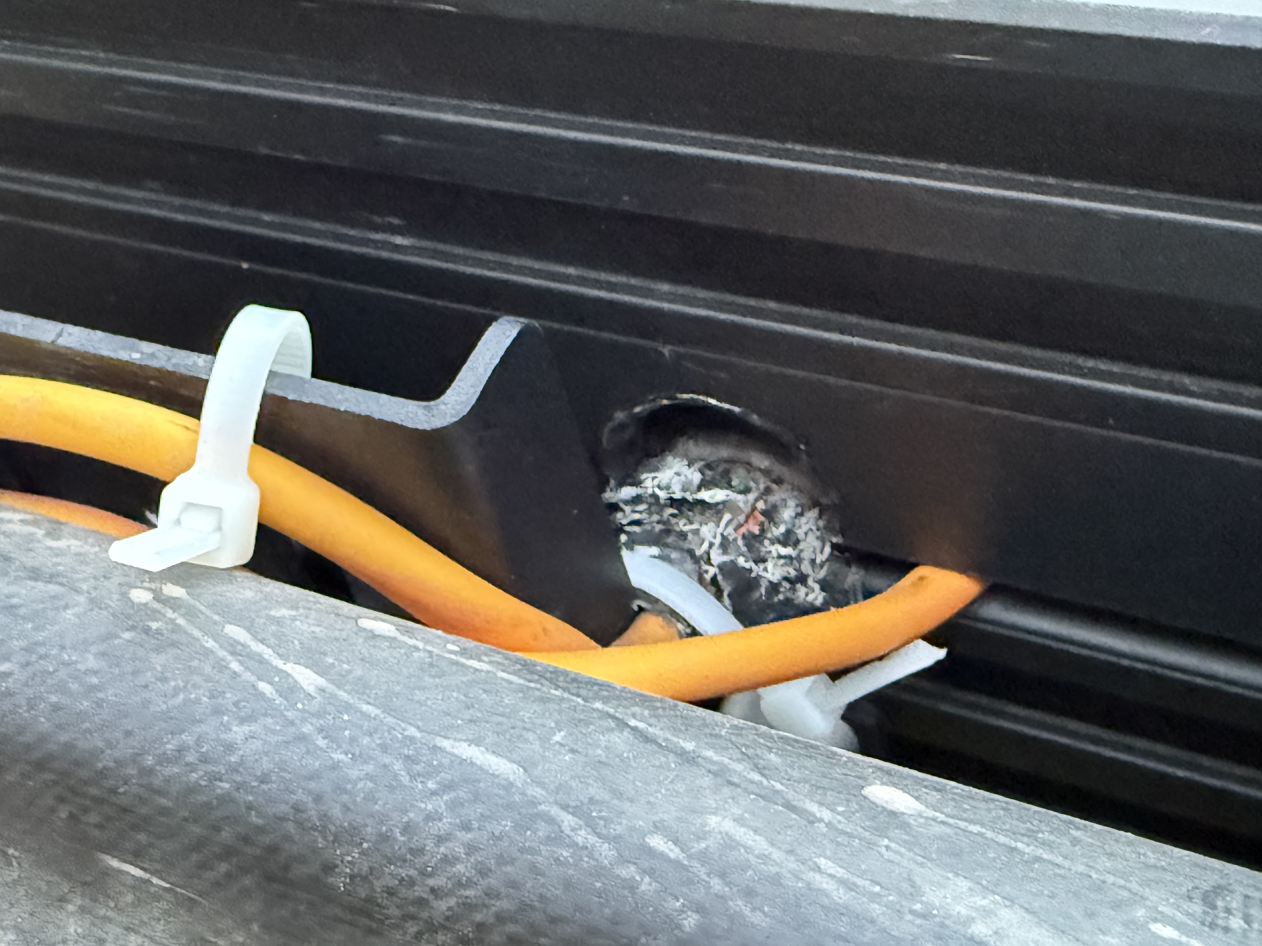

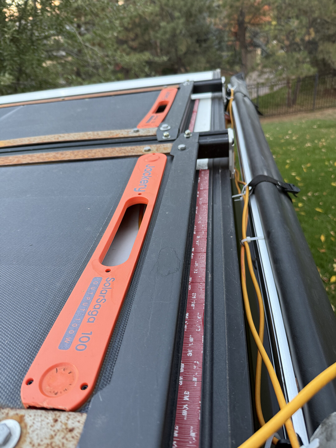

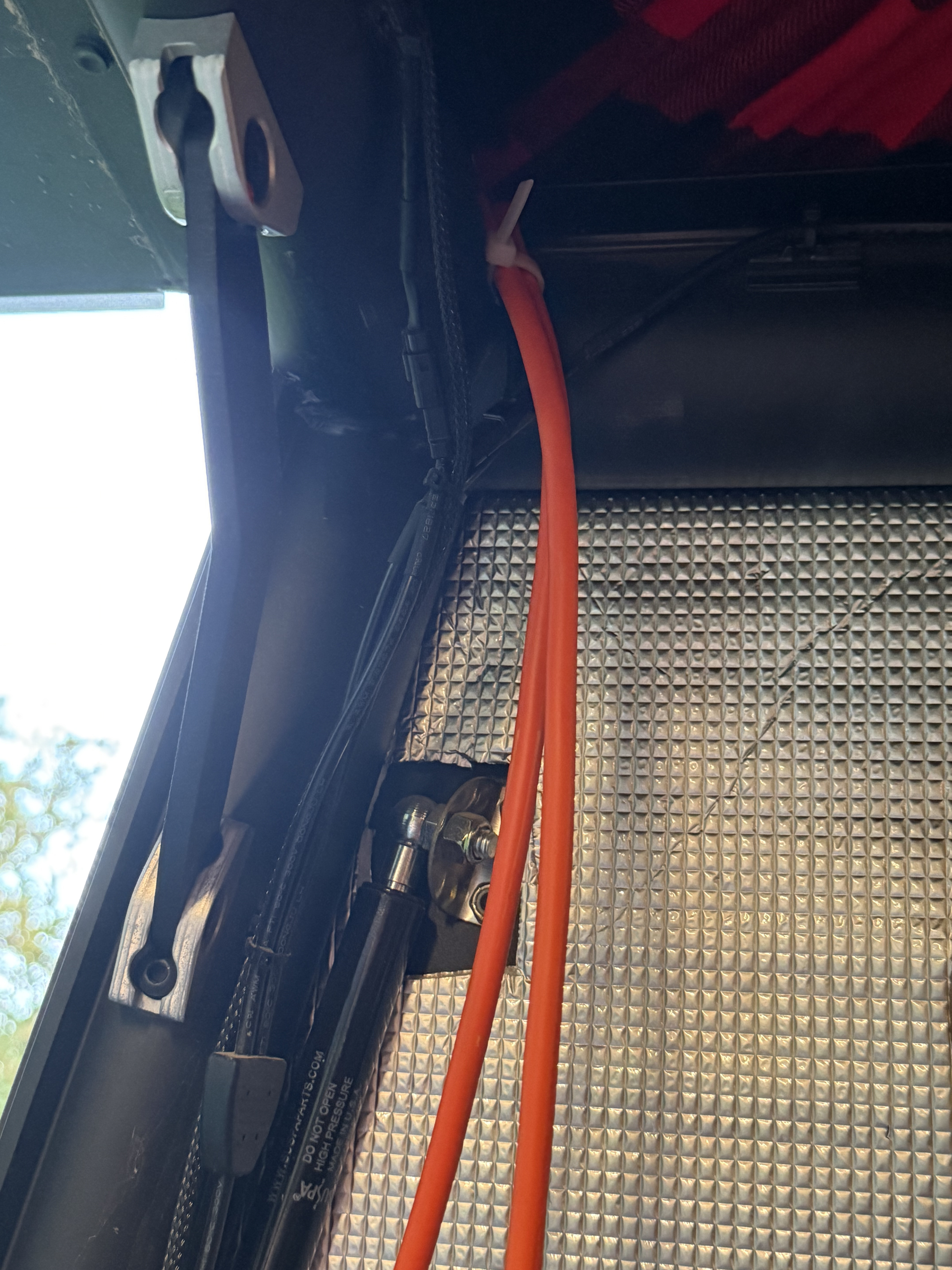

Here are some photos that can hopefully help address how the cables/wiring are run.
I just ran the wires between the GFC and the Awning. Then cut a small hole in the GFC frame to feed the cables into the top part of the GFC. Ran the cables through the corner “slot” in the GFC, attached the cablese for both of the panels into the Jackery “adapter” and plug it into the Jackery 1000. Nothing too elegant.
Thanks, that is exactly what I was thinking, and seeing it helps a lot. As a side note I don’t have the adapter my cables go straight from then panels in to the Jakery 1000V2 but I don’t think that changes anything. I think ill look to wrap or conduit the cables on the exterior some how, you can already see that CO sun doing its thing on the cables.
