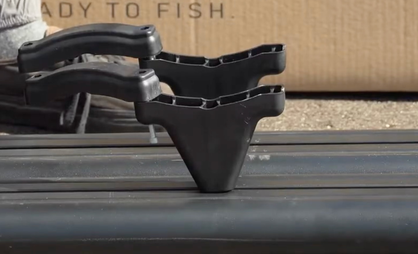

    The standard River Quiver mounting system uses an upper triangular portion and a lower clamp portion to wrap around a cross bar. You can use just the upper portion of the mounting bracket, (set to be east west on your vehicle) so both holes that would meet the lower bracket now match up with beef racks t-track. From there use our ¼-20 extended track studs and nuts to hold the rack securely across your bars!

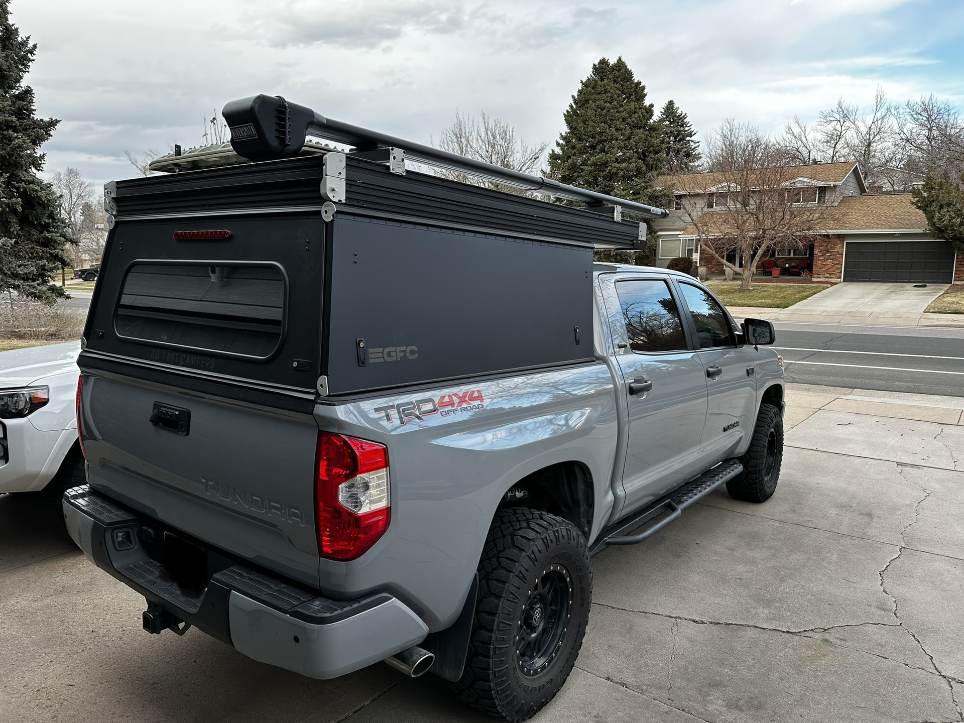

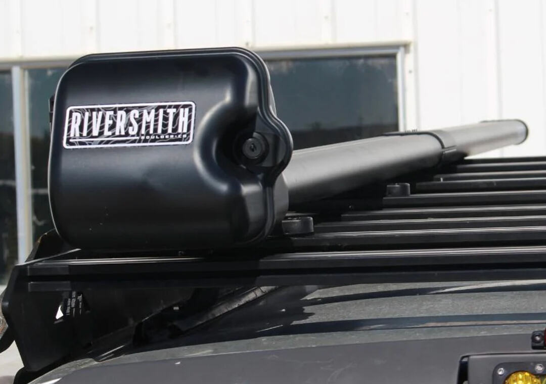

    This is a lower profile option than the previous one. It is great for mounting on top of the tent or topper across 2 beef rack crossbars, this kit can be used with our track studs for tornado proof rod storage.

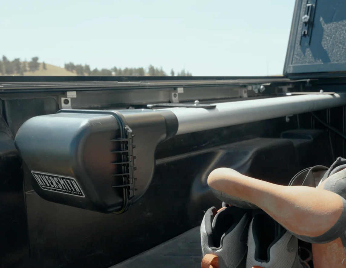

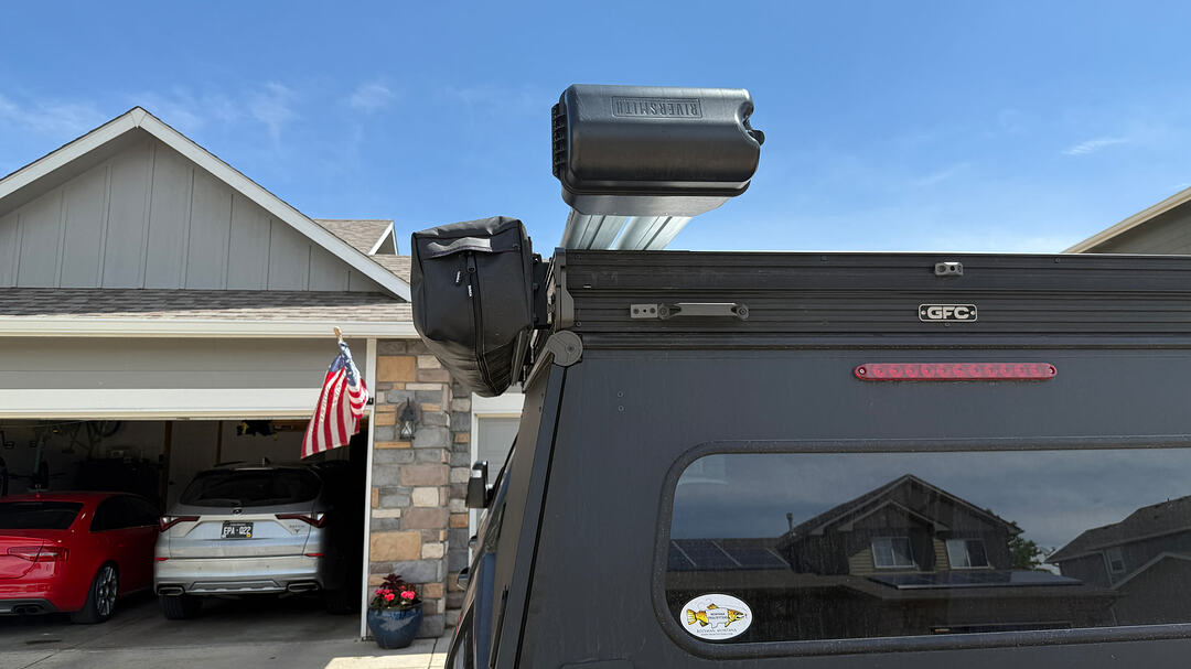

    This can be a better setup for folks that park by a river for extended periods and want to reach their rods without closing the tent. You can bolt the bed mounts to the lower tent extrusion using our t-nut kits. I’d recommend setting this up on the passenger side of your vehicle so it is away from traffic and can be accessed safely, as well as setting up the reel storage portion of the carrier set back behind the side panels opening path.

I did the 2nd option for mine. Been solid so far! Looked at so many ways. This seems to be the best for the four banger. Also used the river quiver hardware (low profile t track) that came with the bracket to attach to the beef bars.
