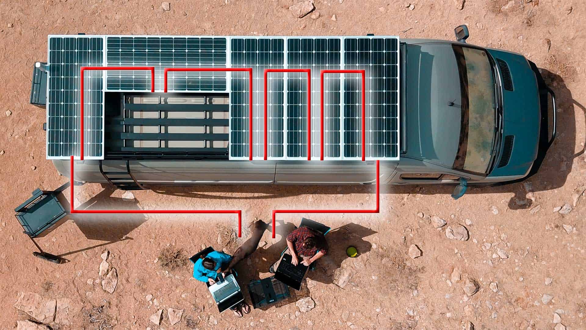

You may get away with easier wiring by running the panels in series. Here is an excellent resource which explains both.

@jasont Thanks for the link; very good info. The key thing: when running in series your voltage will accumulate from each solar panel. So make sure controller can handle the voltage. In parallel wiring voltage doesn’t add up. Second key bit of info: if you’re approaching a lot of voltage output from panels hooked in series be careful of electric shock - turn the panels over so they don’t produce any juice for safety. Also, I like information at site indicating the need for breakers in at least one or two spots. Having a breaker before the charge controller seems like would be really useful, especially during an installation and in case of a surge.
