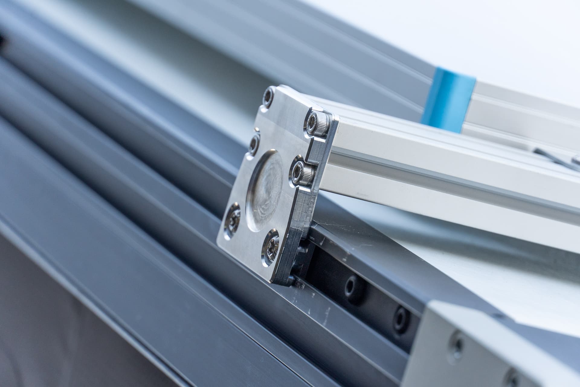

I followed this write up for mine a couple years back. Still working great.
exactly what im looking for!
I did this exact thing, followed their lead. I built 4 for the price of 2 beef bars.
I also spent a lot of time researching cheap sources of aluminum extrusion and landed on AutomationDirect
due to lower cost, free 2-day shipping on orders over $50. Bars came nicely packed and on time.
Also, it wasn’t clear when I began, but I did have to drill the back-sides of the flat plates to accept the t-nut sticking out of the GFC rail, but it was a quick and easy thing to put together.
