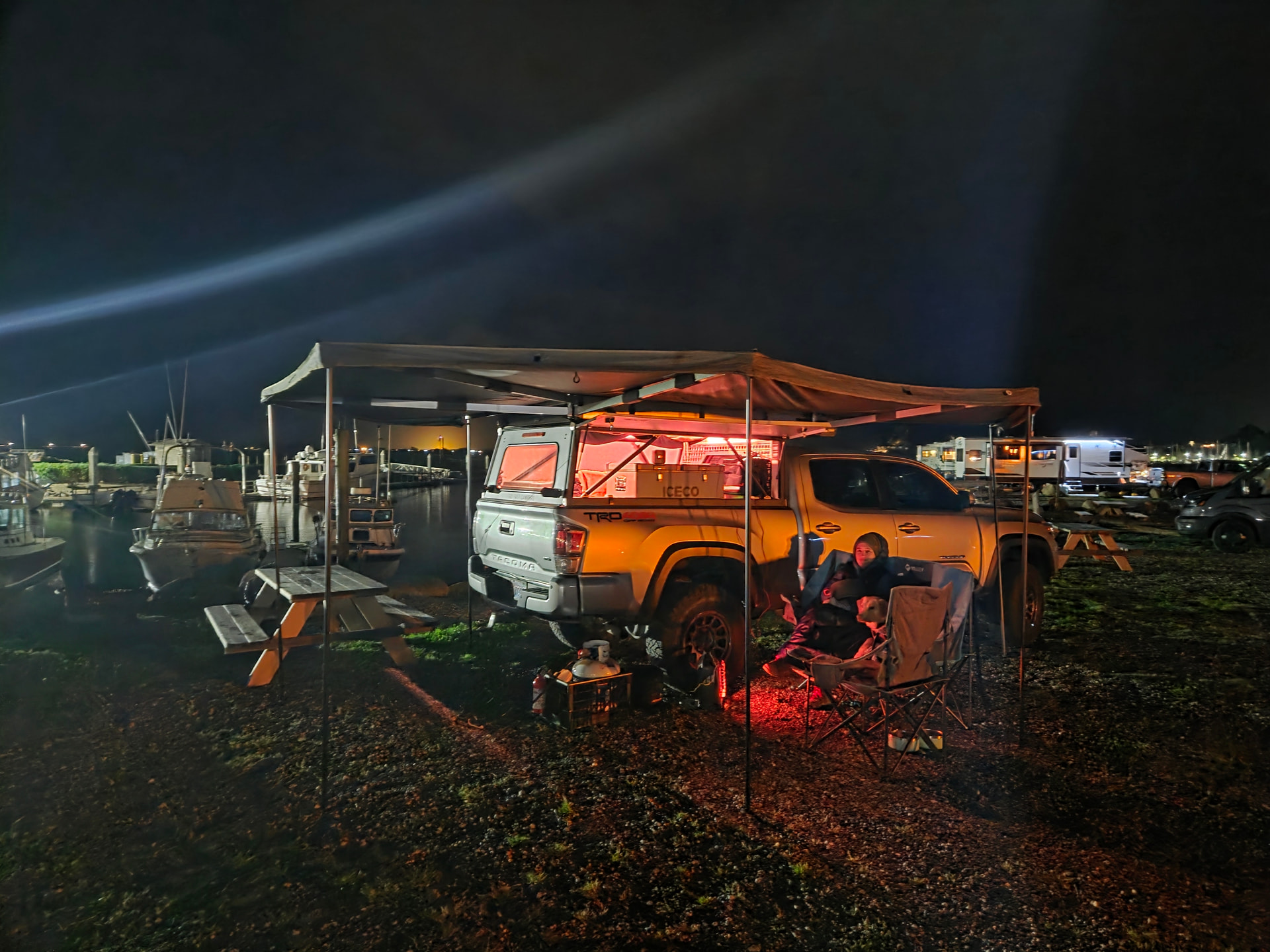

In this photo the rear is open

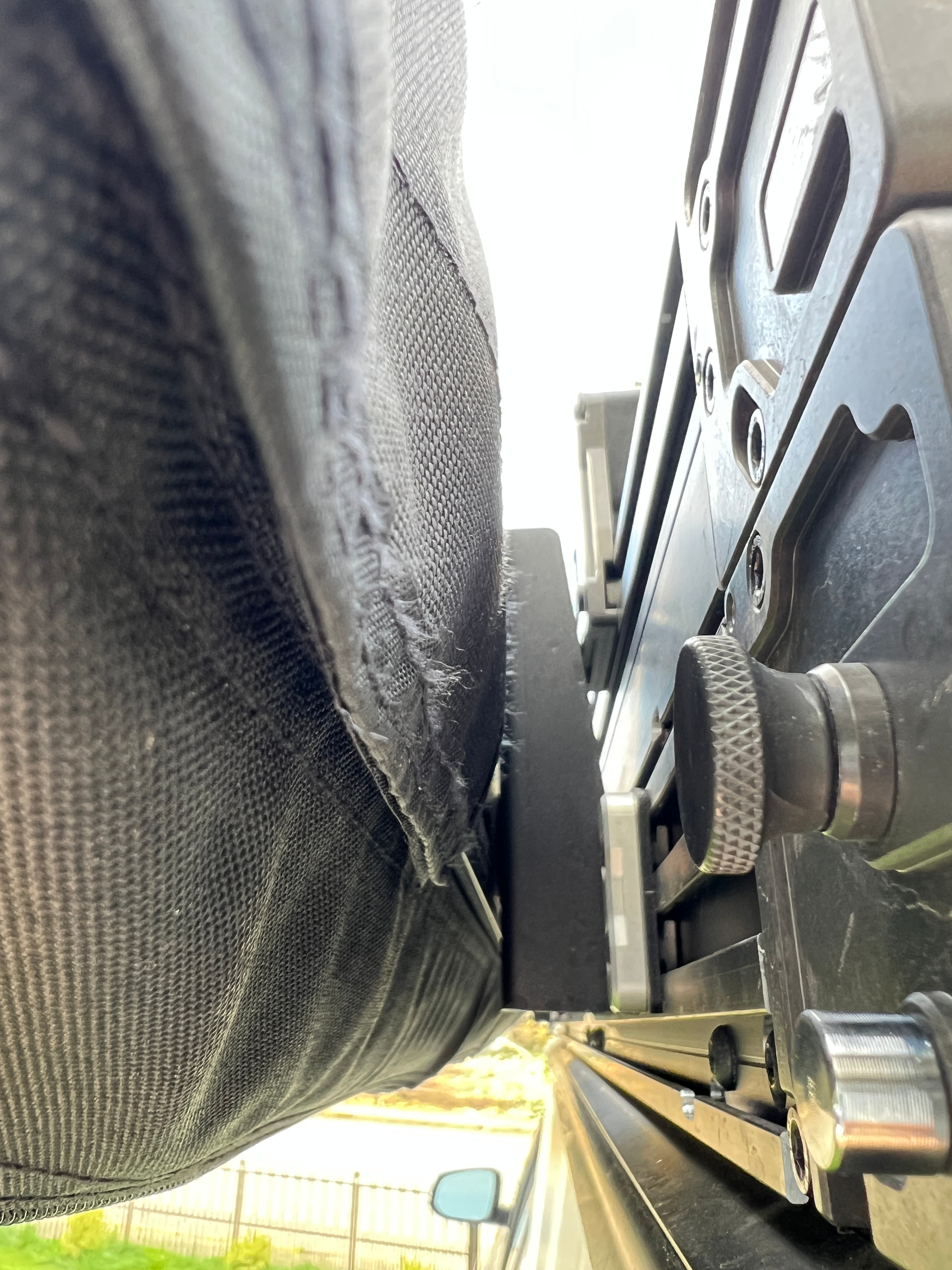

I used 2x GFC brackets on my DCSB taco. Works fine but always wanted to add a 3rd. I second the shorter bolts, and ratcheting wrenches! That will save some cursing later. Also, rear and side panel don’t swing open 100% with the awning open, maybe 85-90%. I put some gorilla tape on the awning arms where the panels make contact to save some wear and tear.
Here is a closeup of the GFC universal bracket used to mount the OVS 270 awning. Works great.
I was able to get my OVS 270 mounted this weekend….I used 4 GFC mounting brackets. Seems stable, but tightening the bolts was not easy. Thanks for the help.
