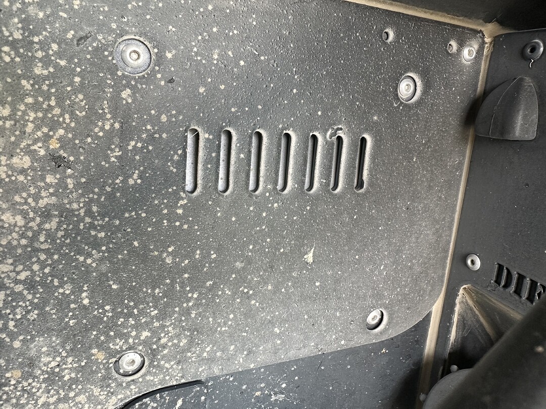

I was able to spend some time looking at the positive pressure venting on the trailer today. These slots are forward facing and super exposed to dust from the tow vehicle and rain when driving.
They used a Briggs and Stratton air filter and have a mount/airbox that is riveted to the inside of the front panel
I’m thinking of mounting a similar airbox (to be sourced or fabricated) on the passenger side front panel.
